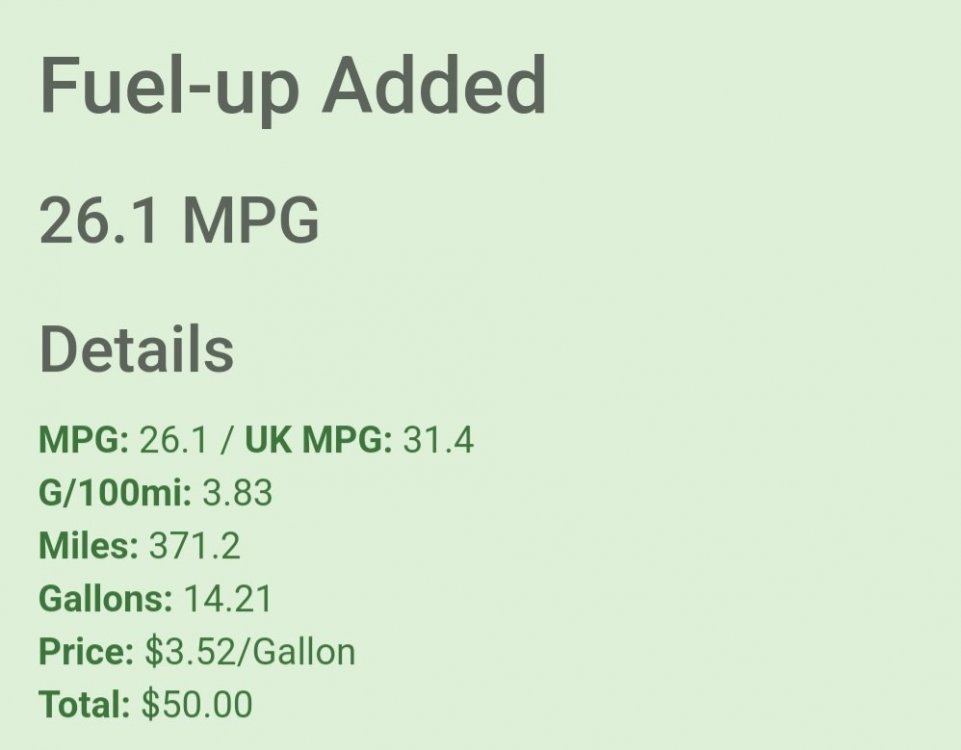

lildisco Posted November 30, 2022 Report Share Posted November 30, 2022 Me thinks that the purge valve on our 2016 SEL Fwd 2.0 Ecoboost was starting to go bad at 56,4xx miles.... 1 Quote Link to comment Share on other sites More sharing options...
enigma-2 Posted December 1, 2022 Report Share Posted December 1, 2022 UCheck for codes P0442 & P0455. Below is an easy way to test for a stuck purge valve. If you only experiencing lower mpg, and the codes don't verify a purge valve, suspect a dirty mass airflow sensor. Easy fix is to just pull off the intake hose and spray with special cleaner. 1 Quote Link to comment Share on other sites More sharing options...
lildisco Posted December 1, 2022 Report Share Posted December 1, 2022 (edited) No codes, stumbling at idle after fillup & poor mpgs over the last few tanks & cleaned the MAF after the 1st tank I noticed was bad. Edited December 1, 2022 by lildisco 2 Quote Link to comment Share on other sites More sharing options...
Cerberus Posted December 2, 2022 Report Share Posted December 2, 2022 12 hours ago, lildisco said: No codes, stumbling at idle after fillup & poor mpgs over the last few tanks & cleaned the MAF after the 1st tank I noticed was bad. Not sure what you mean by stumbling at idle, but when mine was bad, it had a cyclic low idle after fill ups. And the purge valve did fix it 1 Quote Link to comment Share on other sites More sharing options...
lildisco Posted December 2, 2022 Report Share Posted December 2, 2022 1 hour ago, Cerberus said: Not sure what you mean by stumbling at idle, but when mine was bad, it had a cyclic low idle after fill ups. And the purge valve did fix it After filling up, for a few miles, every time you pulled up to a stop light/sign, it would idle rough & acted like it was going to stall. Swapped the $22 purge valve (non OEM, which I couldn't find an OEM for anything less than $170 + $20 shipping & included extra pipes/tubing) . After swapping, no rough idle after fillup & mpgs are back up to normal range. 1 Quote Link to comment Share on other sites More sharing options...
Cerberus Posted December 2, 2022 Report Share Posted December 2, 2022 (edited) 3 hours ago, lildisco said: After filling up, for a few miles, every time you pulled up to a stop light/sign, it would idle rough & acted like it was going to stall. Swapped the $22 purge valve (non OEM, which I couldn't find an OEM for anything less than $170 + $20 shipping & included extra pipes/tubing) . After swapping, no rough idle after fillup & mpgs are back up to normal range. Got you As a mechanic, usually a stumble is when you roll into the throttle (either under load or not) and the engine doesn't rev up as expected, but rather stumbles like biden on the stairs to air force one, but I can see how your use makes sense too Edited December 2, 2022 by Cerberus Clarity 1 Quote Link to comment Share on other sites More sharing options...
