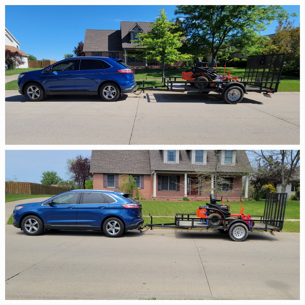

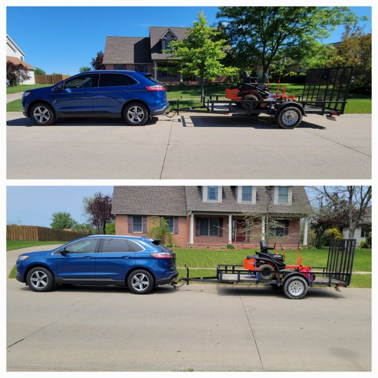

lildisco Posted June 11, 2022 Report Share Posted June 11, 2022 (edited) Definitely rides better while towing with the Helper springs installed. In the dual pic, the latest pic is the top pic Edited June 11, 2022 by lildisco 2 Quote Link to comment Share on other sites More sharing options...

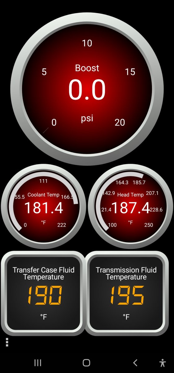

Cerberus Posted June 13, 2022 Report Share Posted June 13, 2022 (edited) Took a road trip, with 170° thermostat installed, used forscan with bluetooth dongle to see temps after hours of rolling down the highway From the TransferCase Fluid temp, its now obvious why they have a cooler in more recent models.. 232 seems a bit high for my liking considering no real load, no weight added, no additional aerodynamic drag or towing, and only about 90° ambient temp just realized that was not forscan, that was OBDlink https://www.dropbox.com/s/naus0c8c1t2q7k2/2022-06-11 14.08.20.jpg?dl=0 Edited June 13, 2022 by Cerberus Correction 2 Quote Link to comment Share on other sites More sharing options...
omar302 Posted June 14, 2022 Report Share Posted June 14, 2022 10 hours ago, Cerberus said: Took a road trip, with 170° thermostat installed, used forscan with bluetooth dongle to see temps after hours of rolling down the highway From the TransferCase Fluid temp, its now obvious why they have a cooler in more recent models.. 232 seems a bit high for my liking considering no real load, no weight added, no additional aerodynamic drag or towing, and only about 90° ambient temp just realized that was not forscan, that was OBDlink Your post reminded me I had taken similar readings when the temperature here reached 50 degrees Celsius few days ago. Granted my trip was about 20km long. By the time I changed the unit to "F" the outside temp reading went down from 50C to 49C. The last one was after 5 minutes of leaving the highway and driving in stop and go traffic/signals. It is noted that my 2016 Edge Sport has the "Hot Market AWD" additional cooling. It includes a PTU cooler and an additional "standalone" Transmission cooler, not sure if there is anything else. Engine Cooling - Component Location 27l.pdf 3 Quote Link to comment Share on other sites More sharing options...
Cerberus Posted June 14, 2022 Report Share Posted June 14, 2022 2 hours ago, omar302 said: Your post reminded me I had taken similar readings when the temperature here reached 50 degrees Celsius few days ago. Granted my trip was about 20km long. By the time I changed the unit to "F" the outside temp reading went down from 50C to 49C. The last one was after 5 minutes of leaving the highway and driving in stop and go traffic/signals. It is noted that my 2016 Edge Sport has the "Hot Market AWD" additional cooling. It includes a PTU cooler and an additional "standalone" Transmission cooler, not sure if there is anything else. This is interesting. So even though your ambient temp was over 20 degrees higher than mine, the PTU temp was 20 degrees cooler. I'd be curious to see if that changed with distance/ time driving, but with a cooling system like yours, I don't suspect it would change much. Now I wonder if I could retrofit the PTU cooler parts to mine... 3 Quote Link to comment Share on other sites More sharing options...
omar302 Posted June 14, 2022 Report Share Posted June 14, 2022 (edited) 10 hours ago, Cerberus said: I'd be curious to see if that changed with distance/ time driving, but with a cooling system like yours, I don't suspect it would change much. I'm curious too, will definitely check if I do take it on a long trip, however, given that the driveline is mostly FWD when cruising at highway speeds, shouldn't it cool off the PTU because of the reduced load? Maybe check your AWD gauge and see how it looks? Edited June 14, 2022 by omar302 4 Quote Link to comment Share on other sites More sharing options...
Cerberus Posted June 15, 2022 Report Share Posted June 15, 2022 6 hours ago, omar302 said: I'm curious too, will definitely check if I do take it on a long trip, however, given that the driveline is mostly FWD when cruising at highway speeds, shouldn't it cool off the PTU because of the reduced load? Maybe check your AWD gauge and see how it looks? I don't think the heating that the PTU experiences is from driving load exclusively or even primarily, at least in my case. I think it might just be heat soak from air flow off the rear turbo and exhaust piping. To that point, my screen shot above was taken 2 hours into a 3 hour highway run, which as you correctly point out, is primarily operating as FWD. I suspect that since your PTU cooler is plumbed in the coolant circuit with its own pump, I don't suspect your PTU temp will change much regardless of how you drive it, with what load or in what conditions, assuming the system doesn't have any component failures, like the separate coolant pump. Probably the only potential weak point in the system. In your climate, you could make a strong argument for installing the 170° thermostat which would keep the PTU a bit cooler as well 3 Quote Link to comment Share on other sites More sharing options...
WWWPerfA_ZN0W Posted June 15, 2022 Author Report Share Posted June 15, 2022 (edited) need to retune the fans along with the 170 tstat to take advantage. otherwise you are just delaying the initial rise to operating temperature. the other proactive piece of course is to use a better fluid - such as Amsoil Severe Gear or Redline Lightweight Shockproof. as for difference the cooler makes Edited June 15, 2022 by WWWPerfA_ZN0W 4 Quote Link to comment Share on other sites More sharing options...
Cerberus Posted June 15, 2022 Report Share Posted June 15, 2022 (edited) 6 hours ago, WWWPerfA_ZN0W said: need to retune the fans along with the 170 tstat to take advantage. otherwise you are just delaying the initial rise to operating temperature. the other proactive piece of course is to use a better fluid - such as Amsoil Severe Gear or Redline Lightweight Shockproof. as for difference the cooler makes The fan set point argument is categorically not true. In stop and go traffic the temperatures may rise to normal operation range (not always) , but at highway speeds, or anything above 30mph steady state, I see a sustained 10-15 degree decrease in coolant temp and cylinder head temp. And I am using the redline light weight shockproof. Thanks for the video clip But I'm not sure if it is really relevant since it is a few years older and a different iteration than the model I own Edited June 15, 2022 by Cerberus 1 Quote Link to comment Share on other sites More sharing options...
