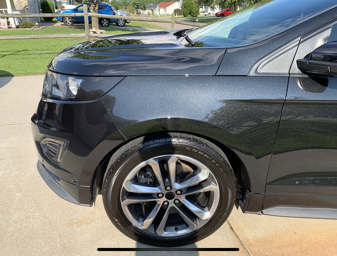

Snoking Posted August 19, 2020 Report Share Posted August 19, 2020 On 7/15/2020 at 8:21 PM, MB022803 said: I drove to the store for cleaning supplies. Hey, that looks like ours! Chris 1 Quote Link to comment Share on other sites More sharing options...

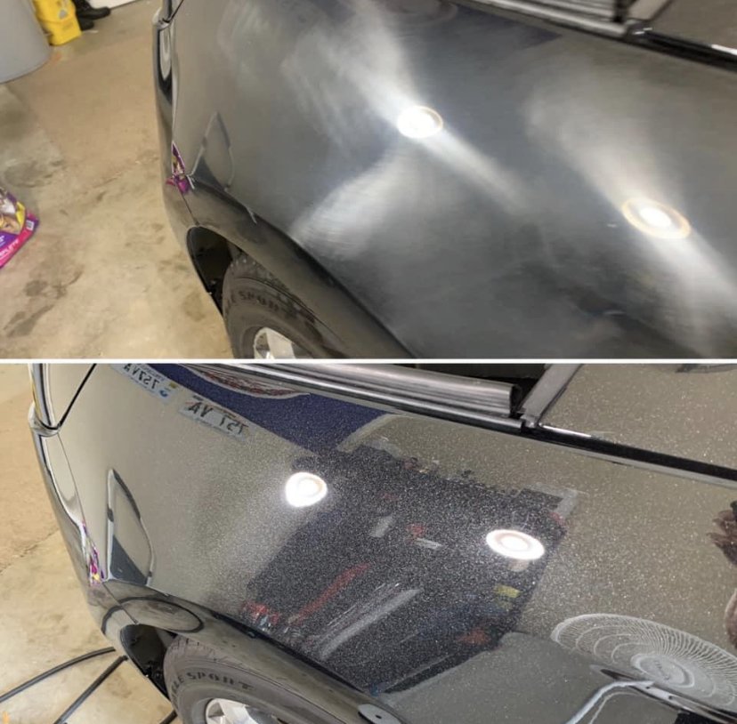

Nick Halstead Posted August 21, 2020 Report Share Posted August 21, 2020 Wetsanded both fenders and got them polished and coated. Im only doing a panel a day off and I have a hellcat and widebody charger coming in for paint correction and ceramic/graphene coatings so this will be last work the edge sees for a minute unless someone canclea 4 Quote Link to comment Share on other sites More sharing options...

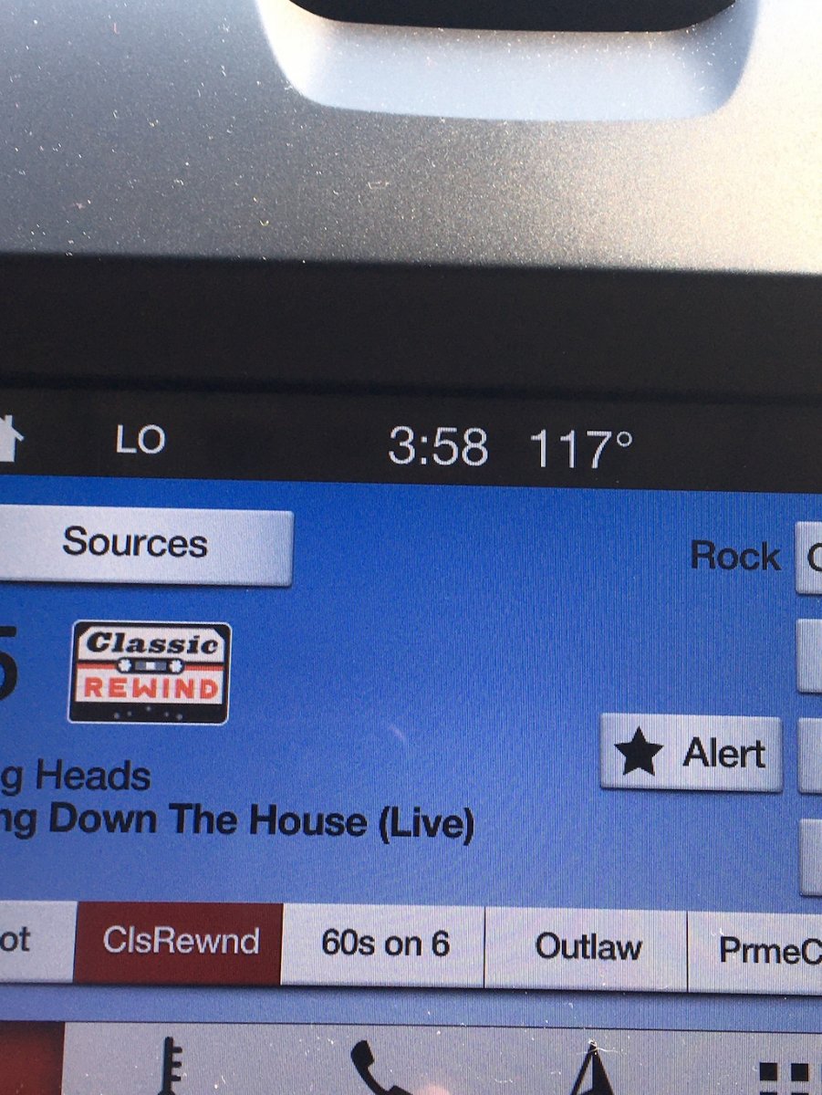

fit1446 Posted August 30, 2020 Report Share Posted August 30, 2020 Havnt posted in the forum for a while... Been putting off some important maintanance for to long just due to this crazy summer here in Az. its been consistantly over 112 degrees for a couple months. saw a brake in the weather ..it was only 100 today so i thought id tackle some things. my A/C has been overheating when stopped and forscan had a code that the module had failed. replaced fan assembly first this morning. only casualty was the dipstick handle..should have pulled it out before maneuvering assembly out. have had a knock from the passenger side suspension when going over bumps and could feel the noise in the floorboard. replaced lower control arm rather than pressing a balljoint. honestly makes no sense to not just replace the whole control arm..it takes about 30min and the cost of a moog arm is like 100 bucks. driver side cv axel blew apart a few weeks ago and covered the wheel and and suspension parts with grease... replaced that cv axel and suprisingly it was an easy one. all said and done i spent approx 5-6 hrs total which isnt bad considering i didnt have a lift and i used hand tools. feeling accomplished for sure. 2 Quote Link to comment Share on other sites More sharing options...

fit1446 Posted August 31, 2020 Report Share Posted August 31, 2020 On 8/20/2020 at 7:31 PM, Nick Halstead said: Wetsanded both fenders and got them polished and coated. Im only doing a panel a day off and I have a hellcat and widebody charger coming in for paint correction and ceramic/graphene coatings so this will be last work the edge sees for a minute unless someone canclea wow..... your really good at that shiny paint stuff. are you a painter? 1 Quote Link to comment Share on other sites More sharing options...
