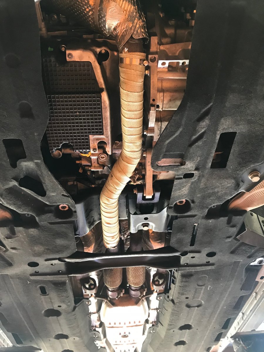

Xtra Posted December 23, 2019 Report Share Posted December 23, 2019 Added exhaust heat wrap to help protect the oil pan and PTU. 1 Quote Link to comment Share on other sites More sharing options...

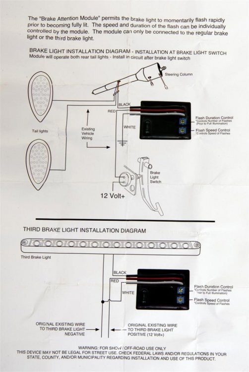

1004ron Posted January 6, 2020 Report Share Posted January 6, 2020 (edited) Added LED number plate bulbs and a flasher on the 3rd brake light. https://www.ebay.com/itm/LED-Brake-Attention-Module-Flasher-Adjustable-Rapid-Flash-Steady-On/122163166568?ssPageName=STRK%3AMEBIDX%3AIT&_trksid=p2057872.m2749.l2649 https://www.ebay.com/itm/2x-LASFIT-T10-192-194-168-158-LED-Interior-Light-Bulb-Error-Free-1-Year-Warranty/272912157470?ssPageName=STRK%3AMEBIDX%3AIT&_trksid=p2057872.m2749.l2649 Same as the one in this YouTube video https://youtu.be/JwO5LLiJ268 Edited January 6, 2020 by 1004ron 3 Quote Link to comment Share on other sites More sharing options...
Gadgetjq Posted January 6, 2020 Report Share Posted January 6, 2020 On 1/6/2020 at 2:56 AM, 1004ron said: Added LED number plate bulbs and a flasher on the 3rd brake light. Expand How did you get to the 3rd brake light wiring and (if it matters) what was the color of the wire? 1 Quote Link to comment Share on other sites More sharing options...
omar302 Posted January 6, 2020 Report Share Posted January 6, 2020 On 1/6/2020 at 12:10 PM, Gadgetjq said: How did you get to the 3rd brake light wiring and (if it matters) what was the color of the wire? Expand European cars in general have a feature that the 4-way flashers turn on (or brake lights flash) under heavy or sudden braking. That would be very nice if it could be added or enabled in our cars. 2 Quote Link to comment Share on other sites More sharing options...

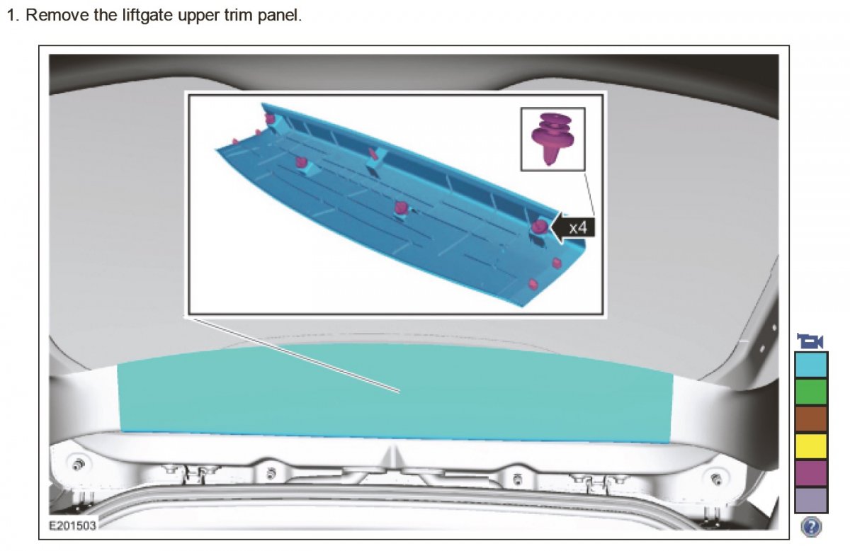

1004ron Posted January 6, 2020 Report Share Posted January 6, 2020 (edited) On 1/6/2020 at 12:10 PM, Gadgetjq said: How did you get to the 3rd brake light wiring and (if it matters) what was the color of the wire? Expand The top liftgate cover clips off and you'll see the LED connector - the black is ground and violet posititive. Liftgate Top panel removal instructions here: Liftgate RI.pdfFetching info... Edited January 8, 2020 by 1004ron 2 1 Quote Link to comment Share on other sites More sharing options...
Gadgetjq Posted January 7, 2020 Report Share Posted January 7, 2020 On 1/6/2020 at 10:59 PM, 1004ron said: The top liftgate cover clips off and you'll see the LED connector - the black is ground and violet posititive. Expand Great, thanks VERY much! I've used center brake modulators for years. I pulled the handle and lower inside panel off of the Edge tailgate but saw no connectors so stopped there. I should have gone for the next panel I guess. BTW the modules I've used allow you to program the flash type, frequency and more. I usually set them for three really fast pulses then three slow then solid on. I set them so the pulsing only repeats if the brake pedal is pressed again 45 seconds or more after being released. That way it's not annoying anyone in stop/go traffic. http://timers.shop/ used to offer these and another module that (like the European versions mentioned earlier) would track the braking rate. Slow easy braking wouldn't produce a flash. Moderate braking would generate a couple of quick strobes and hard braking might make the 3rd brake light give its all. I wrote asking them what happened to that module. They indicate a 'new' version is in the works...stay tuned. Cheers! 2 Quote Link to comment Share on other sites More sharing options...
1004ron Posted January 8, 2020 Report Share Posted January 8, 2020 (edited) On 1/7/2020 at 4:45 PM, Gadgetjq said: Great, thanks VERY much! I've used center brake modulators for years. I pulled the handle and lower inside panel off of the Edge tailgate but saw no connectors so stopped there. I should have gone for the next panel I guess. BTW the modules I've used allow you to program the flash type, frequency and more. I usually set them for three really fast pulses then three slow then solid on. I set them so the pulsing only repeats if the brake pedal is pressed again 45 seconds or more after being released. That way it's not annoying anyone in stop/go traffic. http://timers.shop/ used to offer these and another module that (like the European versions mentioned earlier) would track the braking rate. Slow easy braking wouldn't produce a flash. Moderate braking would generate a couple of quick strobes and hard braking might make the 3rd brake light give its all. I wrote asking them what happened to that module. They indicate a 'new' version is in the works...stay tuned. Cheers! Expand It's the top panel - the PDF is in the post above. I've always had this effect on my Harley after-market BrightAssLight and it catches the attention of drivers behind when touching the brake, and just the other day someone behind me with their gaze down at their phone almost ran into the back of my Sport, and that prompted me to look at these flasher units. This was the only one that had some form of adjustment and the most common one has a series of quick flashes, then slow flashes and then steady, and that it too irritating to me. Edited January 8, 2020 by 1004ron 1 Quote Link to comment Share on other sites More sharing options...

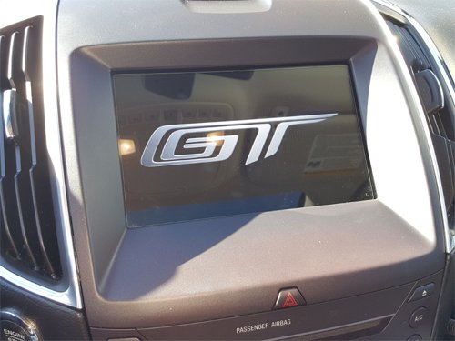

Mastertvtech Posted January 12, 2020 Report Share Posted January 12, 2020 (edited) Can I get the GT splash screen on my 2016 with Forscan? Edited January 13, 2020 by akirby Typos Quote Link to comment Share on other sites More sharing options...
Gadgetjq Posted January 12, 2020 Report Share Posted January 12, 2020 (edited) <<MasterTVTech asked: Can I get the GT splash screen on my 2016 with Forscan? >> The answer is...Yes, unless you've updated Sync 3 to build 19025. If you're still on 18093 you're good to go. Here's the full list of changes you can make, note the GT Animated theme requires 3 separate changes: Change Themes APIM 7D0-02-01: Standard Ford logo; XXXX 0106 XXXX Lincoln logo; XXXX 0401 XXXX Lincoln Black Label logo; XXXX 0301 XXXX Ford Raptor logo; XXXX 0501 XXXX Ford Mustang logo; XXXX 0601 XXXX Ford GT350 logo; XXXX 0701 XXXX Vignale Classic; XXXX 0801 XXXX Ford GT350R logo; XXXX 0901 XXXX Ford Performance ST logo; XXXX 0B01 XXXX Ford Performance RS logo; XXXX 0C01 XXXX Ford Performance GT logo; XXXX 0D01 XXXX 01-Lincoln Continental logo; XXXX 0E01 XXXX GT Full Theme Incl Splash APIM 7D0-01-02 0xxx xxxx xxxx 7D0-02-01 xxxx xDxx xxxx 7D0-03-01 xxxx x4xx xxxx Lincoln Brown Theme (screen) APIM 7D0-03-01 xxxx x2xx xxxx Must also set 7d0-01-02 8xxx xxxx xxxx Edited January 27, 2020 by Gadgetjq 2 Quote Link to comment Share on other sites More sharing options...

Gadgetjq Posted February 26, 2020 Report Share Posted February 26, 2020 (edited) On 1/8/2020 at 1:24 AM, 1004ron said: It's the top panel - the PDF is in the post above. Expand Once 1004ron pointed me to the correct panel (thanks!) this was a simple project. Here's a quick video of my result: Edited February 26, 2020 by Gadgetjq 3 Quote Link to comment Share on other sites More sharing options...
