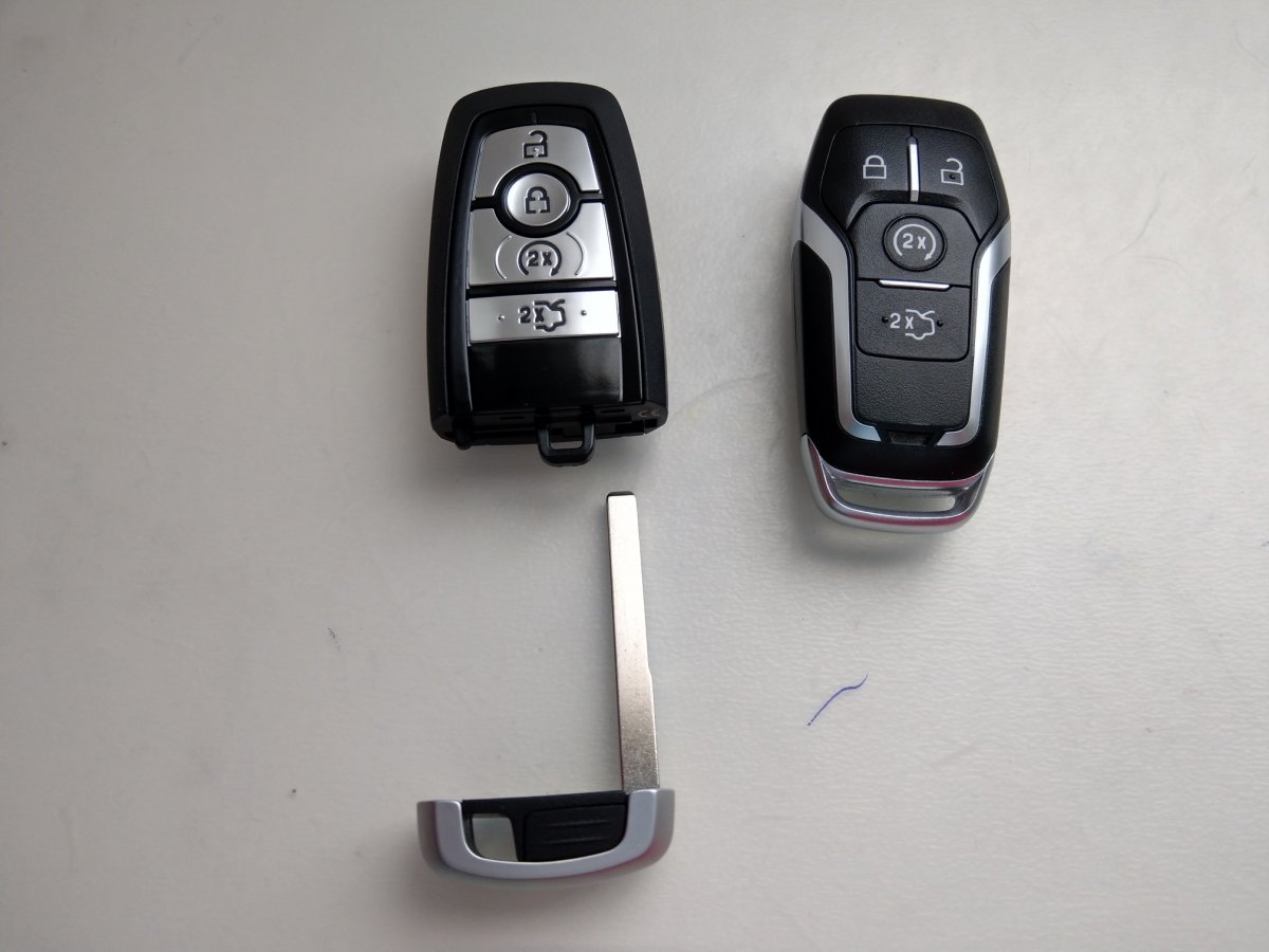

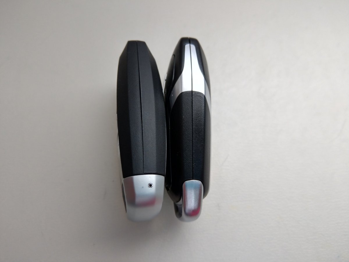

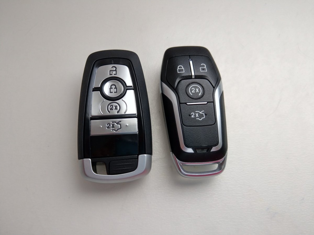

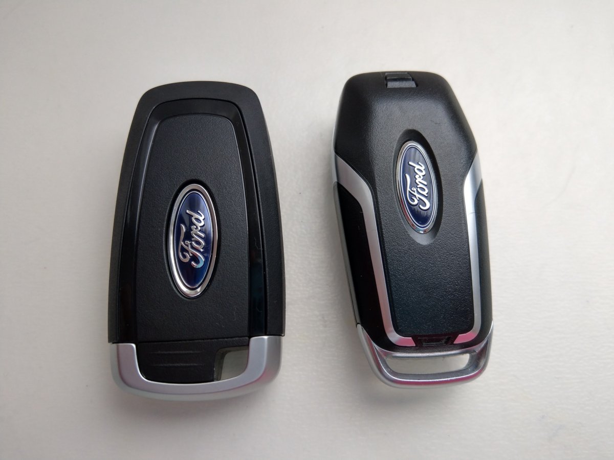

omar302 Posted July 24, 2019 Report Share Posted July 24, 2019 (edited) I programmed a 3rd intelligent access key. Used the new 2019 style fob. Read how many Raptor & F-150 owners did it, so decided to try it myself. Mind you, my fob is different from US versions having no "Panic button" and using the 868 MHz frequency, US use 902 MHz, if i remember correctly. I purchased this FOB and this blank key from eBay (same seller). Followed the instructions in the manual, took many tries until finally it worked. My problem was with the last step, after putting the new fob and pressing the ignition start button nothing would happen so i'd press it a second time thinking I did not press it correctly and then a message comes up that programming failed. The last time after pressing the ignition button (nothing would happen) left it a few moments and it programmed successfully. Another note, the manual states to have the buttons facing back, but that is not correct, they need to face UP with the key ring facing towards the back of the car. Another thing, when programming the new style key, remove the key so it fits better in the back up slot. Edit: Update on the remote, I had the blank key from the new style remote cut and it works smoothly unlocking the driver's door and the glove box. Edited July 27, 2019 by omar302 2 Quote Link to comment Share on other sites More sharing options...

onyxbfly Posted July 24, 2019 Report Share Posted July 24, 2019 On 7/24/2019 at 8:05 AM, omar302 said: I programmed a 3rd intelligent access key. Used the new 2019 style fob. Read how many Raptor & F-150 owners did it, so decided to try it myself. Mind you, my fob is different from US versions having no "Panic button" and using the 868 MHz frequency, US use 902 MHz, if i remember correctly. I purchased this FOB and this blank key from eBay (same seller). Followed the instructions in the manual, took many tries until finally it worked. My problem was with the last step, after putting the new fob and pressing the ignition start button nothing would happen so i'd press it a second time thinking I did not press it correctly and then a message comes up that programming failed. The last time after pressing the ignition button (nothing would happen) left it a few moments and it programmed successfully. Another note, the manual states to have the buttons facing back, but that is not correct, they need to face UP with the key ring facing towards the back of the car. Another thing, when programming the new style key, remove the key so it fits better in the back up slot. Expand Its very ironic that you mentioned this. My brother has a 2015 Sport and has your key on the right. He purchased two of the keys you have on the left. The fob you purchased is same fob I have for my 2017 Sport. He gave me a fob for my birthday! Neither one of us can program our fobs. We tried various instructions found on the nets and the one in the manual. We believe we did everything correctly. Just like you there is some confusion as to the last step. We are going to try your suggestion. I'll send your instructions to my brother. He's not on the forum. If I get some time today I will try them as well. Thanks for the info! 1 Quote Link to comment Share on other sites More sharing options...
omar302 Posted July 27, 2019 Report Share Posted July 27, 2019 (edited) Update on the remote, I had the blank key from the new style remote cut and it works smoothly unlocking the driver's door and the glove box. Also, As I now have an extra fob, I removed the batteries from one of the old ones and hid it in the car. Now the car would not recognize it, but if I get in using the keypad and place the remote (without batteries) into the back up slot in the center console I can start the engine and drive. On 7/24/2019 at 12:00 PM, onyxbfly said: Neither one of us can program our fobs. We tried various instructions found on the nets and the one in the manual. We believe we did everything correctly. Just like you there is some confusion as to the last step. We are going to try your suggestion. I'll send your instructions to my brother. He's not on the forum. If I get some time today I will try them as well. Expand Did it work? If not, to test if the remote works (at least partially) is to do a remote start, it should fail and then the led would flash red several times. Edited July 27, 2019 by omar302 1 Quote Link to comment Share on other sites More sharing options...

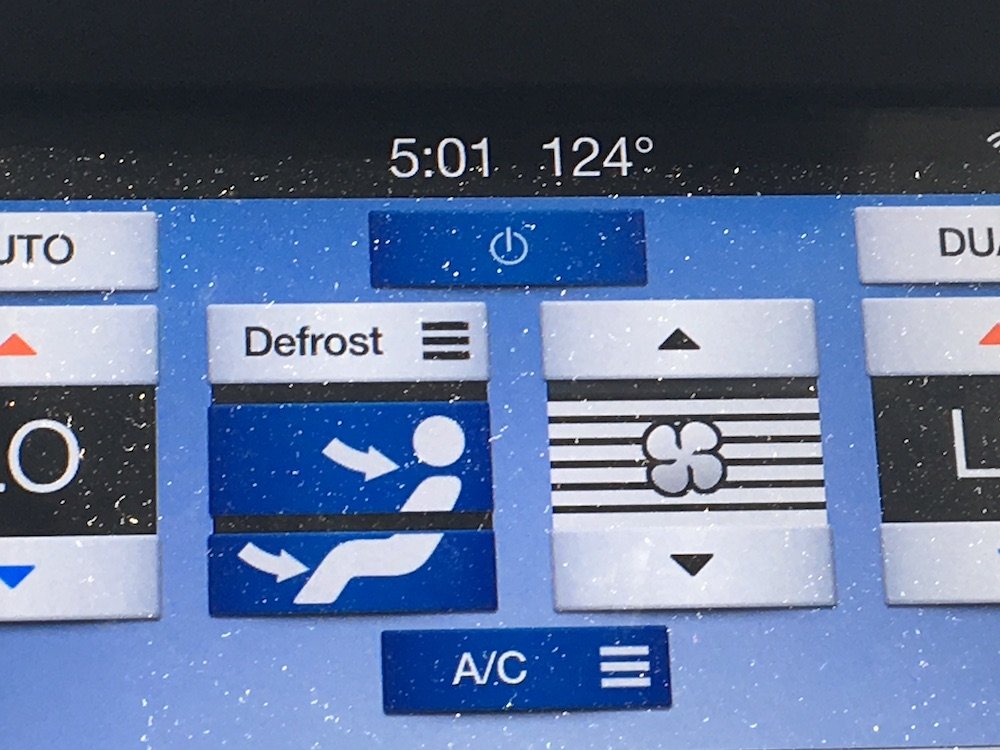

Xtra Posted July 28, 2019 Report Share Posted July 28, 2019 (edited) It was hot today and I had to be out in it for 3 hour while working . Check this out 124*F in the sun when I got in the car. It was really only 105*F in the shade. Yes I know the car is dirty, it needs some TLC. Edited July 28, 2019 by Xtra 1 Quote Link to comment Share on other sites More sharing options...
onyxbfly Posted July 28, 2019 Report Share Posted July 28, 2019 On 7/27/2019 at 5:28 PM, omar302 said: Did it work? If not, to test if the remote works (at least partially) is to do a remote start, it should fail and then the led would flash red several times. Expand Thanks for the suggestion! That's a great idea. Neither one of us thought of testing the fob that way. Unfortunately it did not work for us. I even swapped batteries to no avail. Will be going back in the mail tomorrow. 1 Quote Link to comment Share on other sites More sharing options...

omar302 Posted July 29, 2019 Report Share Posted July 29, 2019 On 7/28/2019 at 9:42 PM, onyxbfly said: Thanks for the suggestion! That's a great idea. Neither one of us thought of testing the fob that way. Unfortunately it did not work for us. I even swapped batteries to no avail. Will be going back in the mail tomorrow. Expand Sorry to hear that. Are you getting a message in the cluster that the programming failed or nothing at all? 1 Quote Link to comment Share on other sites More sharing options...
boostededge Posted July 29, 2019 Report Share Posted July 29, 2019 Installed FORScan. disabled stupid auto stop start filled up on 100/92 mix for 93 octane Looked at evo thought I was fast 3 Quote Link to comment Share on other sites More sharing options...
onyxbfly Posted July 29, 2019 Report Share Posted July 29, 2019 On 7/29/2019 at 4:11 AM, omar302 said: Sorry to hear that. Are you getting a message in the cluster that the programming failed or nothing at all? Expand Nothing at all. I wish I received a programming failed message. I get no feedback at all. I was hoping that maybe I was doing something wrong, but your remote start test was the final nail in the coffin. 1 Quote Link to comment Share on other sites More sharing options...
omar302 Posted July 29, 2019 Report Share Posted July 29, 2019 On 7/29/2019 at 8:35 AM, onyxbfly said: Nothing at all. I wish I received a programming failed message. I get no feedback at all. I was hoping that maybe I was doing something wrong, but your remote start test was the final nail in the coffin. Expand For me, when it failed i did get the message. But having no red light come up definitely means something is wrong. To check if your vehicle was reading the old keys correctly, you try the procedure for displaying the factory set keyless entry code. It reads the 2 keys then, if successful, displays the code in the message center. 2 Quote Link to comment Share on other sites More sharing options...
onyxbfly Posted July 29, 2019 Report Share Posted July 29, 2019 On 7/29/2019 at 9:22 AM, omar302 said: For me, when it failed i did get the message. But having no red light come up definitely means something is wrong. To check if your vehicle was reading the old keys correctly, you try the procedure for displaying the factory set keyless entry code. It reads the 2 keys then, if successful, displays the code in the message center. Expand I have some last minute running around to do before going on vacation. If I have time, I'll try it today. If not its on my todo list for when I get back! thanks for the suggestion! 1 Quote Link to comment Share on other sites More sharing options...
