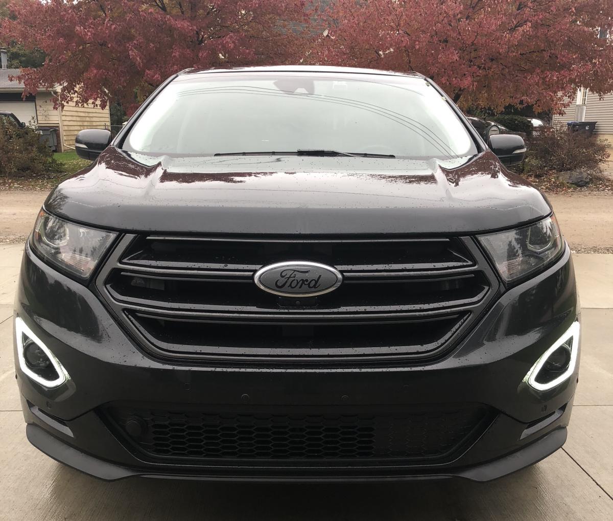

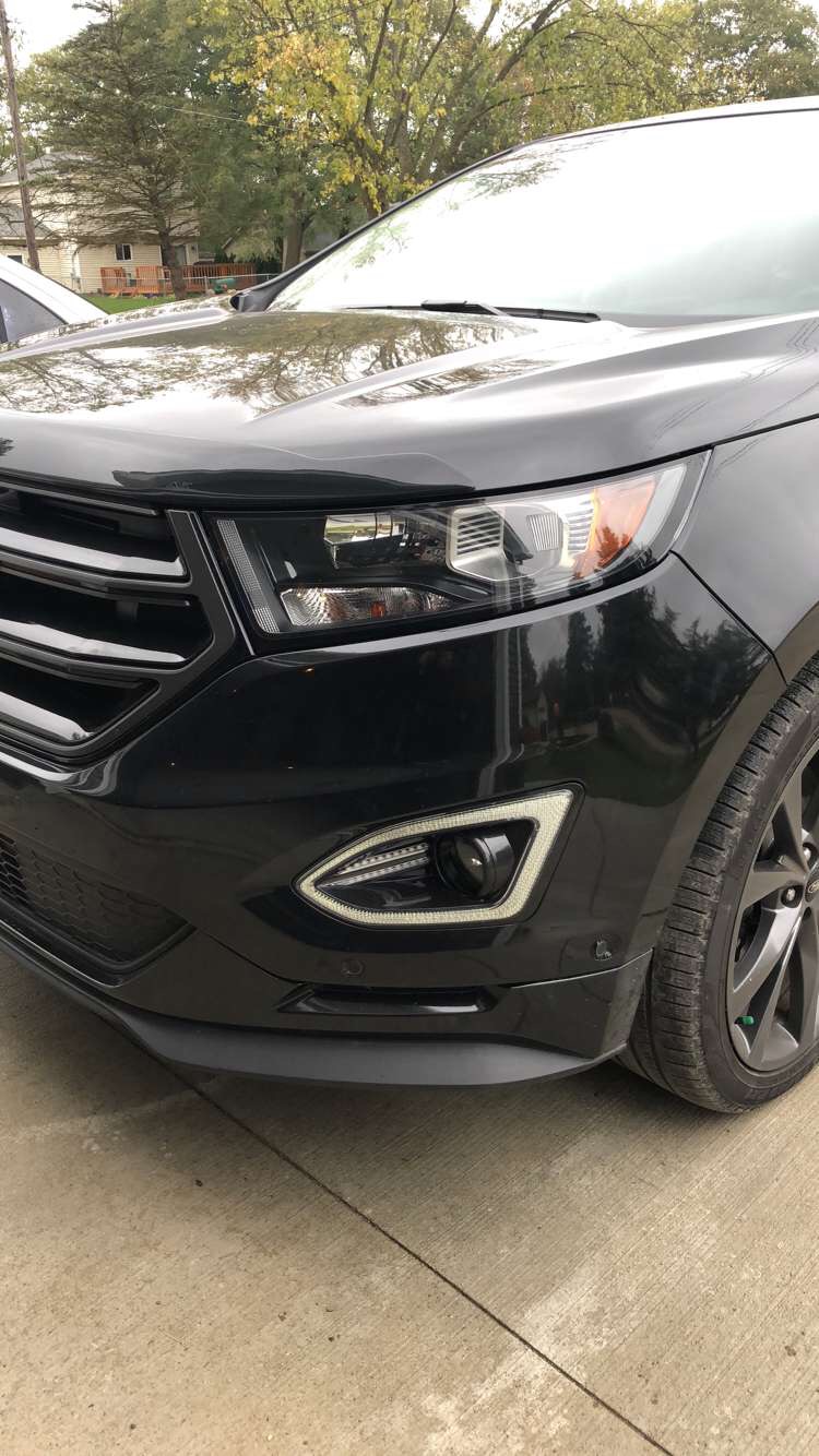

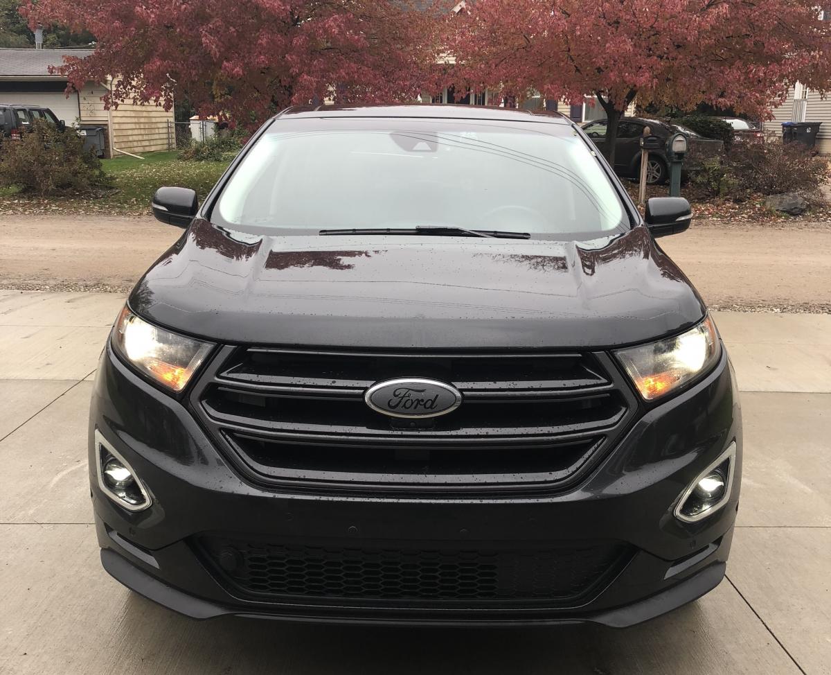

tmarsh Posted October 28, 2018 Report Share Posted October 28, 2018 (edited) What did I do today(and yesterday)? Those ebay signature switchback bezels, and morimoto LED fog lights. Beware before you order these, they do not fit. If you happen to make them fit, they do not latch in. If you happen to secure them, no fog light housing will fit. If you happen to secure a fog light and aim it correctly, you will need to wire everything. If you happen to get that far, welcome to the fog light club! Ill create a post explaining how I did it and post a ink here. Edited October 28, 2018 by tmarsh 4 Quote Link to comment Share on other sites More sharing options...
lildisco Posted October 28, 2018 Report Share Posted October 28, 2018 Those fog lights look amazing. What all did you have to do to get them to work? Special parts from Europe? Quote Link to comment Share on other sites More sharing options...
TheGrossman Posted October 28, 2018 Report Share Posted October 28, 2018 Wow! Fog lights look great!! I'd be interested on how you did it too! Sounds like a royal PIA but the results look like it was worth it! Quote Link to comment Share on other sites More sharing options...
tmarsh Posted October 28, 2018 Report Share Posted October 28, 2018 Thanks guys! Here is my post explaining the project. http://www.fordedgeforum.com/topic/25853-15-18-edge-fog-light-install/?p=192638 1 Quote Link to comment Share on other sites More sharing options...

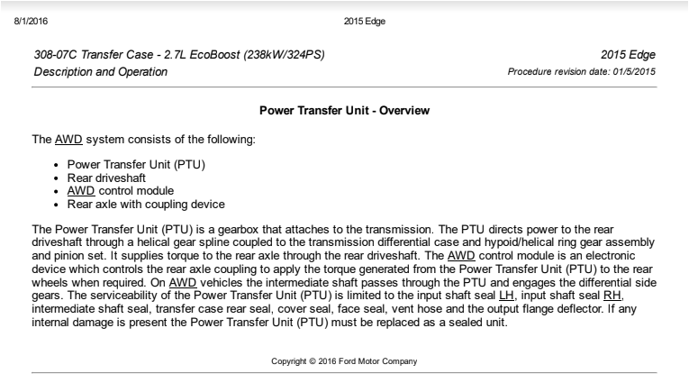

Dukhaykh Posted November 6, 2018 Report Share Posted November 6, 2018 Removed the driveshaft on my AWD and now it’s FWD ??. 1 Quote Link to comment Share on other sites More sharing options...
WWWPerfA_ZN0W Posted November 7, 2018 Author Report Share Posted November 7, 2018 (edited) Just remember you still have the PTU transferring power to the front right axle. Probably less like to fail in a FWD configuration, but no data on that. Edited November 7, 2018 by WWWPerfA_ZN0W Quote Link to comment Share on other sites More sharing options...
omar302 Posted November 7, 2018 Report Share Posted November 7, 2018 1 hour ago, WWWPerfA_ZN0W said: Just remember you still have the PTU transferring power to the front right axle. Probably less like to fail in a FWD configuration, but no data on that. As per the Service Manual, the PTU only send power to the rear. 1 Quote Link to comment Share on other sites More sharing options...
WWWPerfA_ZN0W Posted November 7, 2018 Author Report Share Posted November 7, 2018 Yes, but it still sits in between the trans and the right drive axle. It is physically connected. And, as noted in your excerpt, really it is ALWAYS transferring power (except in P/N), it is NOT electronically controlled, purely mechanical. The electronic control is between the driveshaft and the thing people think of as the RDU, aka the ATC. The 4x4 module determines how much to send to the rear axles, and sends the signal to the ATC. The ATC then engages the %age the 4x4 commands. Quote Link to comment Share on other sites More sharing options...
Dukhaykh Posted November 8, 2018 Report Share Posted November 8, 2018 A friend of mine did something with the fuses and made the AWD comes OFF (Dashboard lights says AWD OFF) and FW only works now without even removing the driveshaft! that means this thing is also controlled electrically. 1 Quote Link to comment Share on other sites More sharing options...
