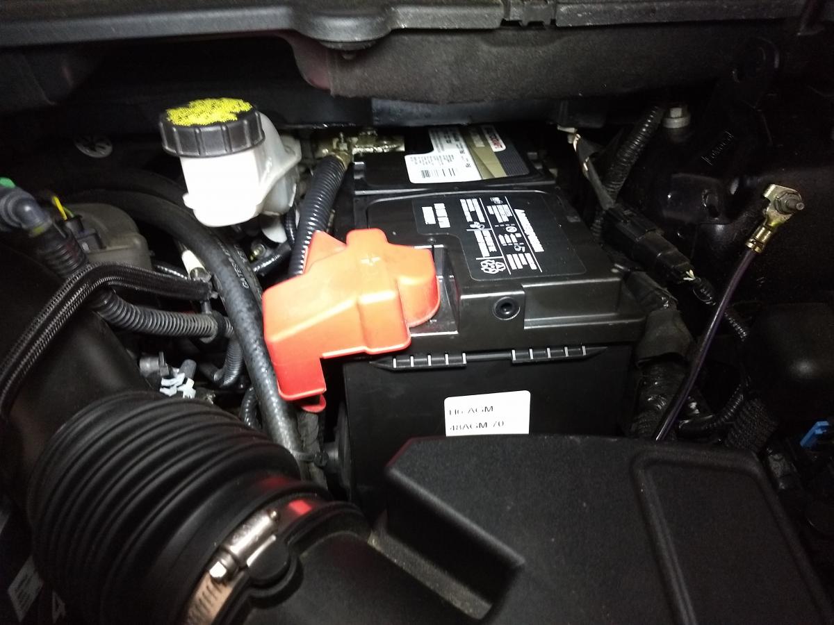

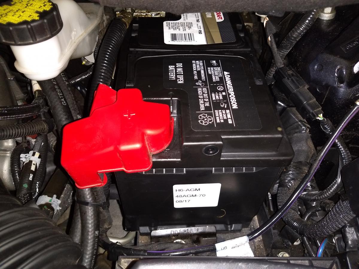

lildisco Posted September 9, 2017 Report Share Posted September 9, 2017 (edited) Wife left the parking lights on all night earlier in the week. My battery tender didn't have enough to wake it from the dead (didn't really expect it to), borrowed a battery charger from work & let it sit for a few days on a 12v 2A charge. That gave me time to think about it. With all the fuss about battery life lately, what were the odds that it would my battery would fail during the first cold snap (ohio). I didn't want to spend the money, but the original oem battery lasted 1.5 years. With everyone saying that batteries last about 2 years, I didn't want to take a chance. Brand new, 760CC AGM battery from Advance Auto installed & i have piece of mind. This sucker is massive compared to the oem one. I had to wiggle a few things around to get it to fit, but she's in. Edited September 9, 2017 by lildisco 1 Quote Link to comment Share on other sites More sharing options...

lildisco Posted September 9, 2017 Report Share Posted September 9, 2017 (edited) If there's an Advance Auto around anyone, they're having a 20% off sale till tomorrow I believe. Saved me $35 off this sucker, 3 year warranty. The oem battery was 550CCA while this one is 760CCA & its a AGM, so kinda like a win win, lol Edited September 9, 2017 by lildisco 1 Quote Link to comment Share on other sites More sharing options...
