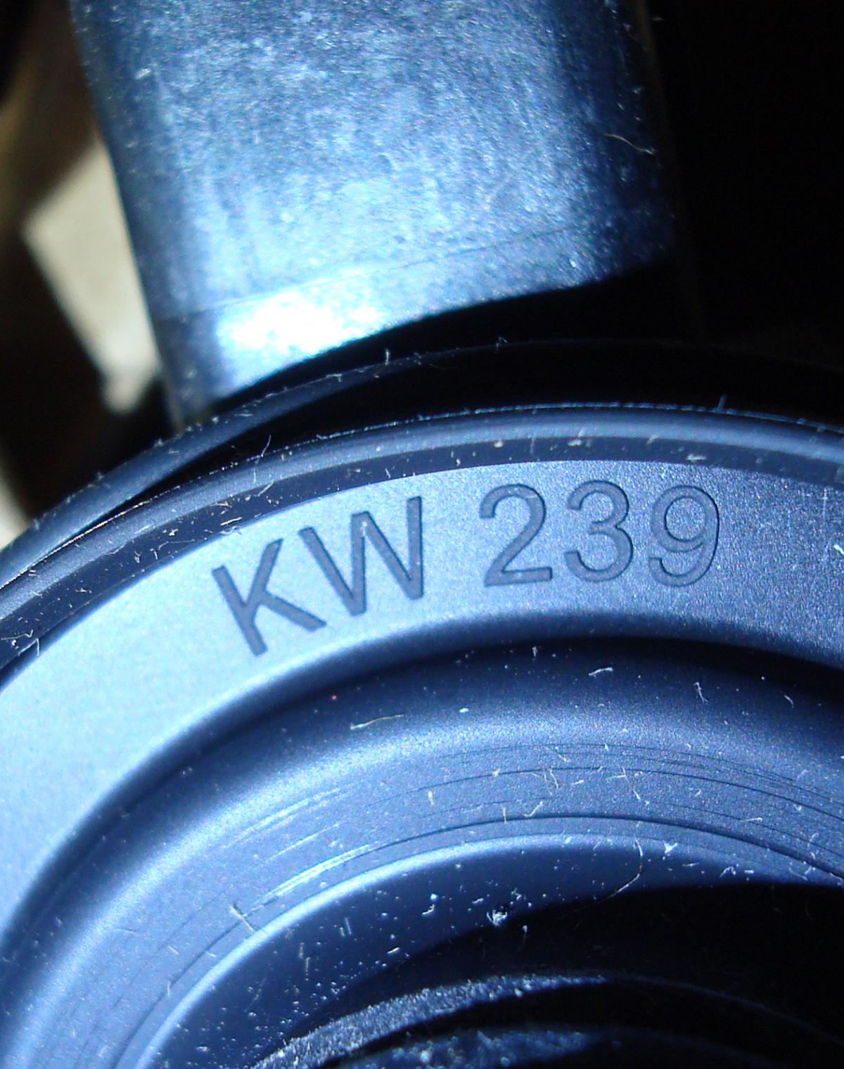

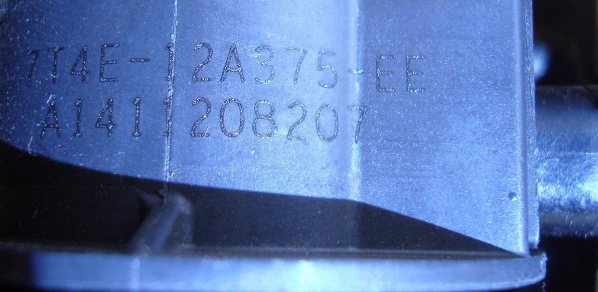

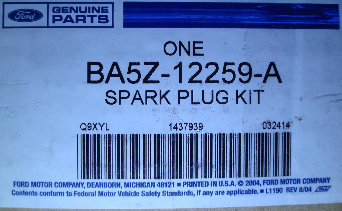

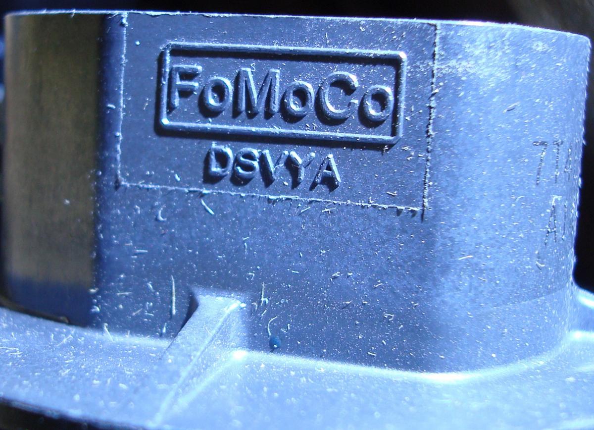

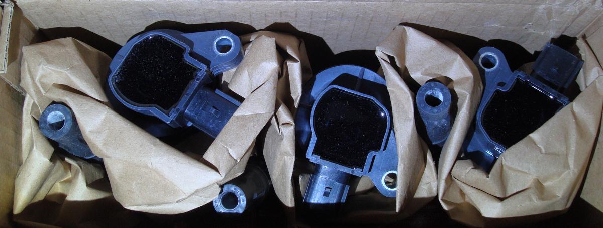

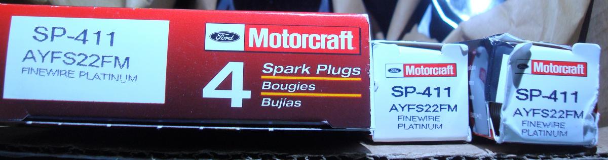

WWWPerfA_ZN0W Posted May 25, 2016 Author Report Share Posted May 25, 2016 Bought a COP & spark plug kit, OEM/Ford, BA5Z-12259-A, for a pretty good price from Levittown: https://secure.revolutionparts.com/levittown-ford/oe-ford/ba5z12259a Works for the 2010-12 Fusion Sport as well, in case you are wondering. Quote Link to comment Share on other sites More sharing options...
