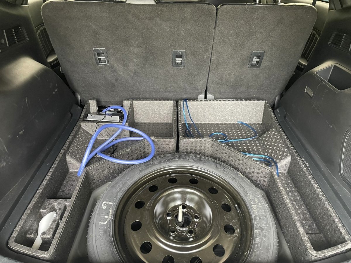

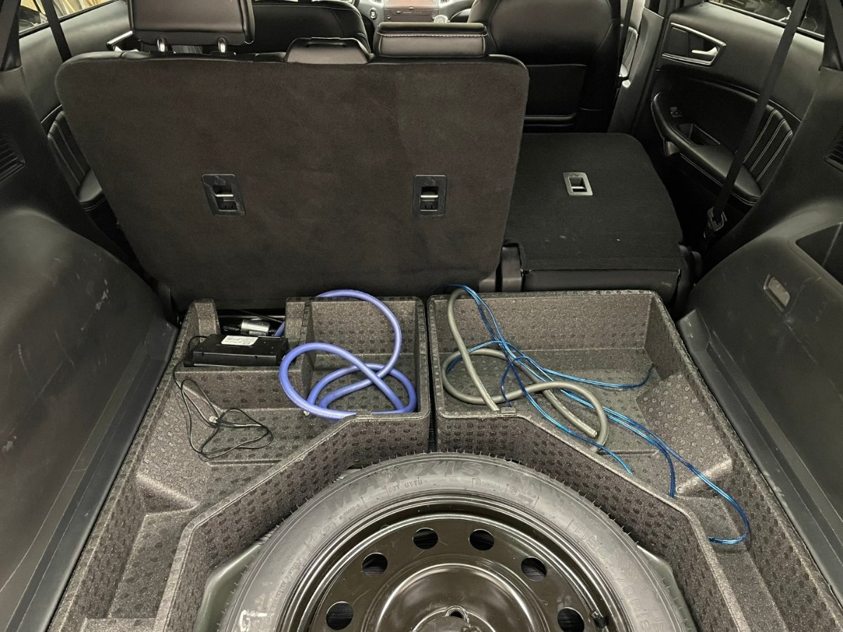

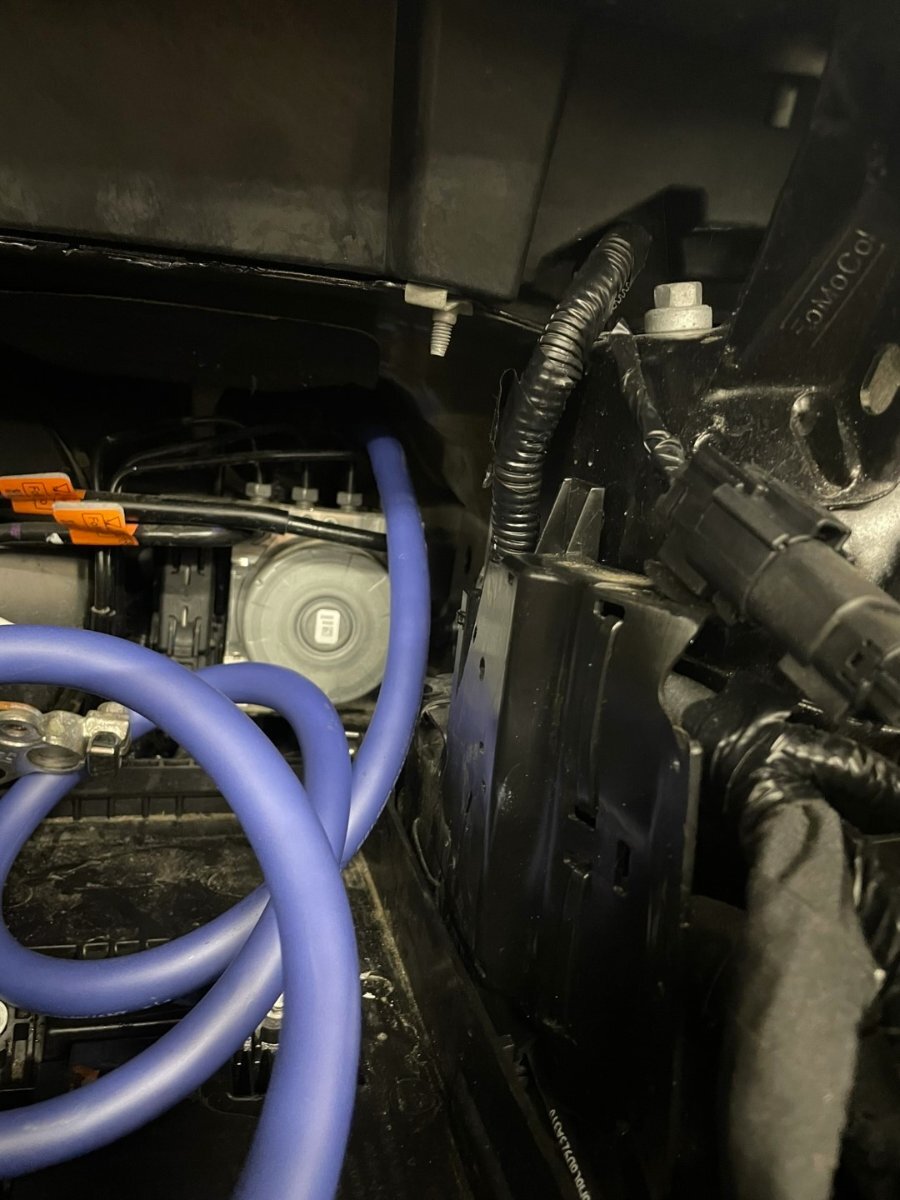

sc00by Posted June 28, 2024 Report Share Posted June 28, 2024 Ran power wire last night. 1 Quote Link to comment Share on other sites More sharing options...
Tim W. AZ Posted June 28, 2024 Report Share Posted June 28, 2024 (edited) 6 hours ago, sc00by said: Ran power wire last night. Ran a power wire to what? Edited June 28, 2024 by Tim W. AZ Quote Link to comment Share on other sites More sharing options...
sc00by Posted June 28, 2024 Report Share Posted June 28, 2024 38 minutes ago, Tim W. AZ said: Ran a power wire to what? To the hatch, we can see this in the photo. 1 Quote Link to comment Share on other sites More sharing options...

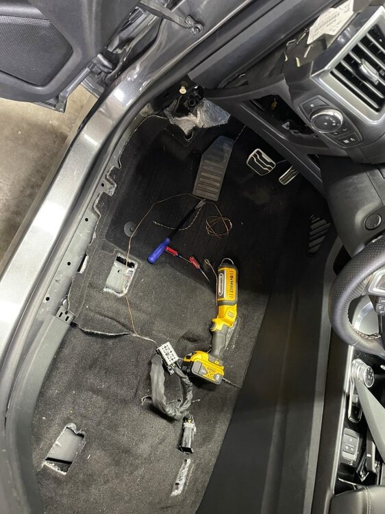

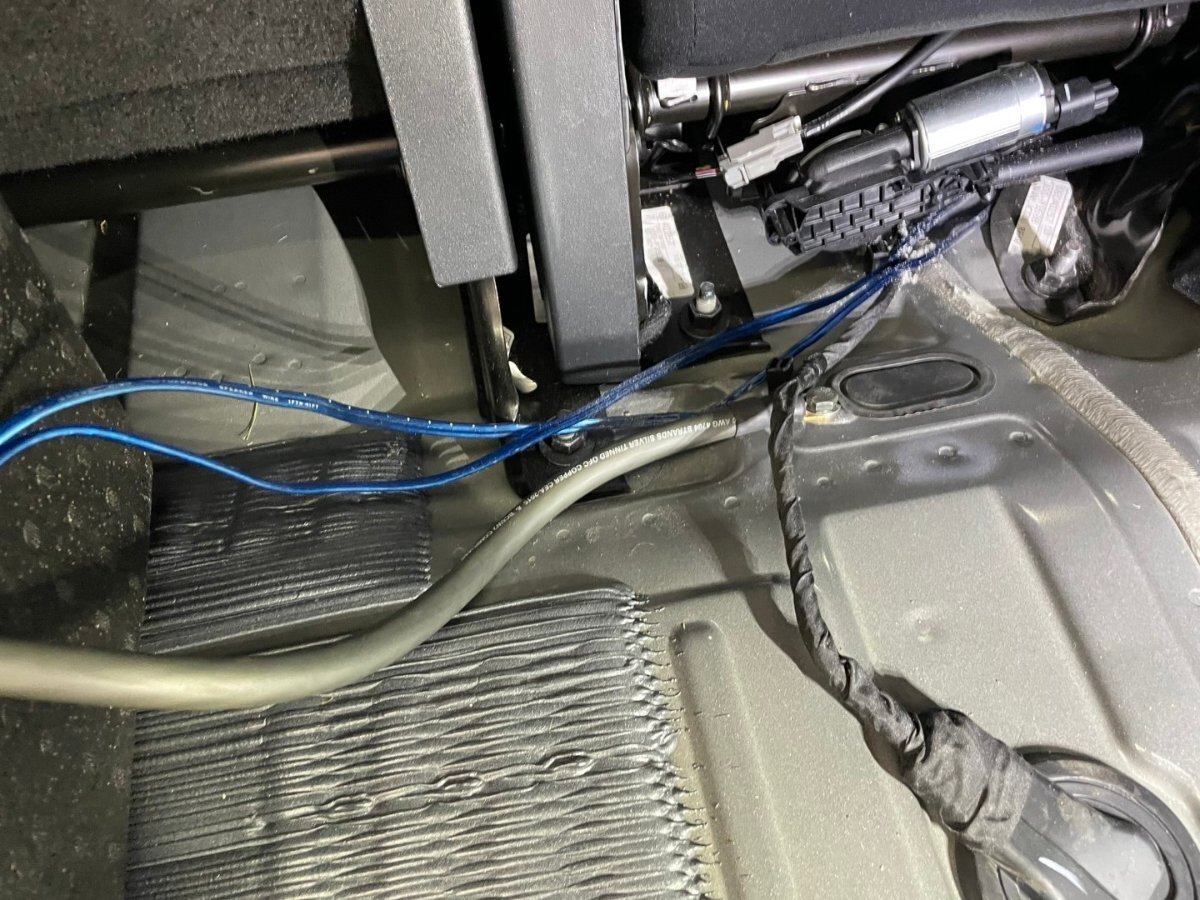

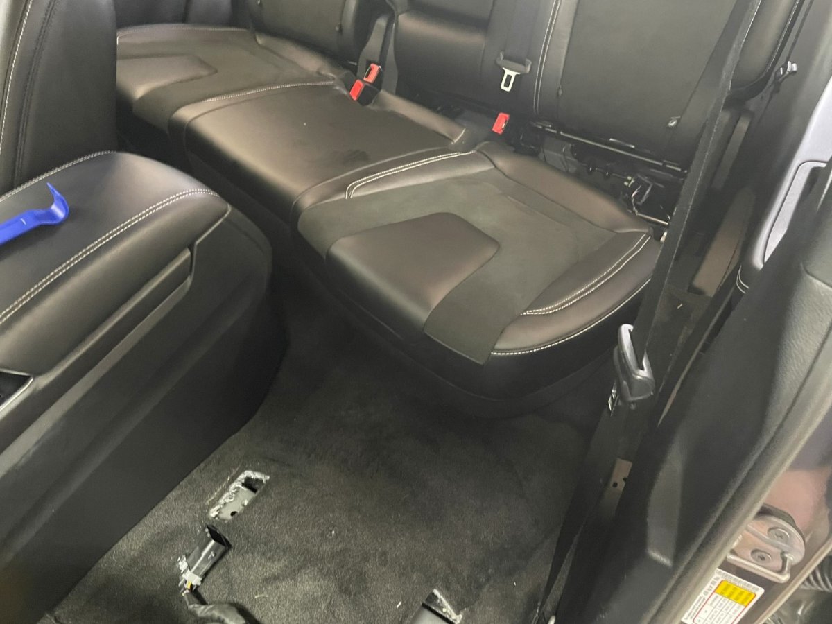

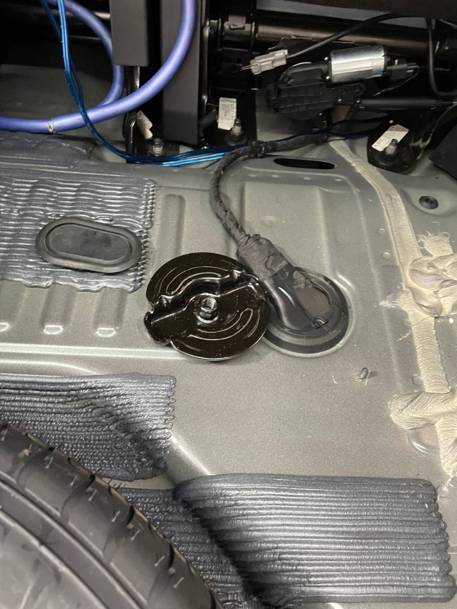

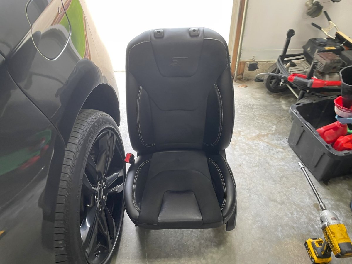

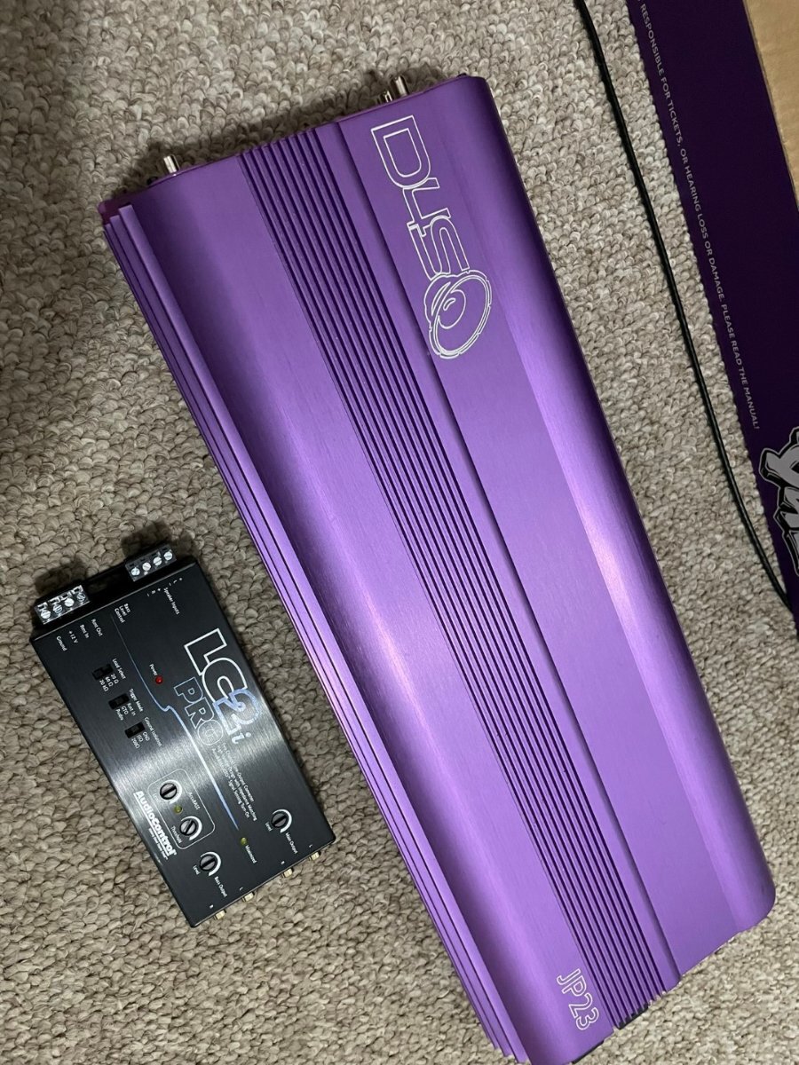

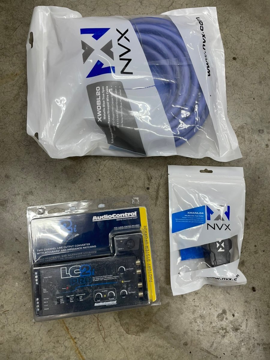

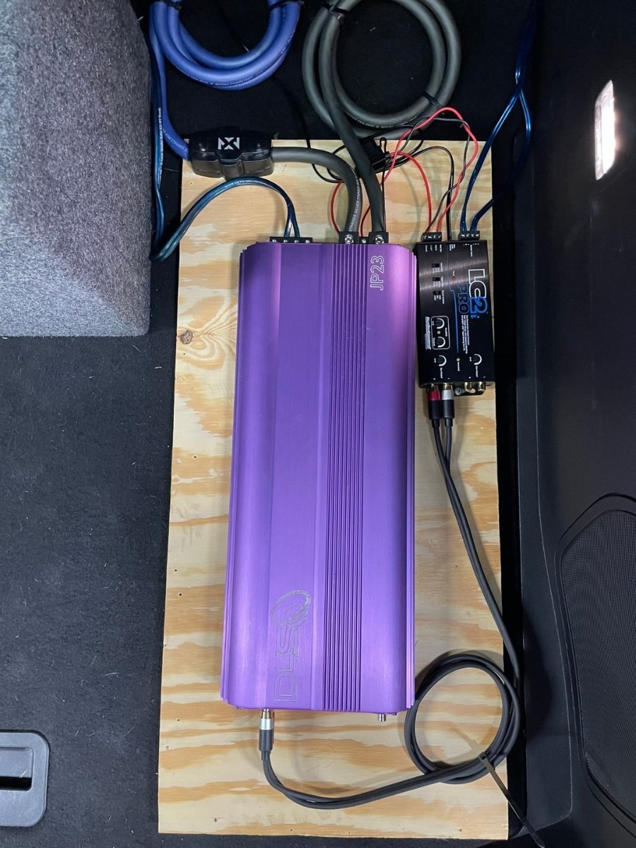

sc00by Posted June 28, 2024 Report Share Posted June 28, 2024 (edited) OK, rather than some smart ass remarks, I'll share more of what is going on with the power wire. I find that the factory system is boomy but lacks that bottom end punch. My goal is to keep the factory sub and add in something more substantial. First, we added a ground wire today. I saw some folks were running a ground wire to where the amp is in the back of the hatch. That's not for me, I like shorter grounds for my amps. Wire wheel'd both sides where the ring terminal bolts in, not sure that I really like how thin the metal is, but the seat bolt was not giving me a good clean connection. I am going to sleep on this as I am still not fully sold on this ground point. Maybe I will take out the back seats and clean up the seat belt bolts to see if we can get a more robust connection. OH I found this, too...I've not had my edge long and noted that the hold down for the spare tire was missing, there is still part of the hold down missing. This was under the rear seat. Shitty styrofoam put back. The speaker wire is tied into the factory sub. Everything is intentionally extra long. I've got some plans to replace all of the styrofoam with something else. More on that later. Some goodies, the power wire is already installed. Sonic Electronix shorted me on a fuse block so I am stuck waiting on them 🙄 You can also see the slice in the power wire bag FROM THEM. It came that way. Thankfully the power wire was not nicked. The power wire is to support these two guys. I have a sub as well which is slated for installation. To really maximize the amp/sub I really need more alternator, this amp will pull some serious power and I'm afraid that 210a simply isn't enough 🤣 Edit: I guess the forum software has decided I need this pic twice. I delete it, and it comes right back. GG forum software. Edited June 29, 2024 by 1004ron 2 Quote Link to comment Share on other sites More sharing options...
johnmarkp Posted June 29, 2024 Report Share Posted June 29, 2024 The amp, at full load, will pull anywhere from 30amps for an 8 ohm load to 150amps for a 1 ohm load. I would think the ground needs to be as robust as the positive wire. I would run a separate ground wire all the way to the battery if it was my Edge. If I remember correctly. The body grounds on the edge are 12 gauge wire at best. They are not designed to take the load that will put on them. 2 Quote Link to comment Share on other sites More sharing options...
sc00by Posted June 29, 2024 Report Share Posted June 29, 2024 2 hours ago, johnmarkp said: The amp, at full load, will pull anywhere from 30amps for an 8 ohm load to 150amps for a 1 ohm load. I would think the ground needs to be as robust as the positive wire. I would run a separate ground wire all the way to the battery if it was my Edge. If I remember correctly. The body grounds on the edge are 12 gauge wire at best. They are not designed to take the load that will put on them. Right now the ground is going to the floor right behind the rear seat. You want ground wires short, there is def no room to run another 1/0 cable run along side the power wire. This amp will pull 250-300+ amps at 1ohm. Here is an amp dyno by Williston Audio and he is using a clamp gauge during the tests: After sleeping on it I think I am going to add a ground wire from the seat belt bolt to the sheet metal ground I am using. 1 Quote Link to comment Share on other sites More sharing options...

johnmarkp Posted June 30, 2024 Report Share Posted June 30, 2024 The body is only as good a ground as the connection between it and the negative terminal of the battery. I am pretty sure that there are several connections on the Edge. 1 Quote Link to comment Share on other sites More sharing options...

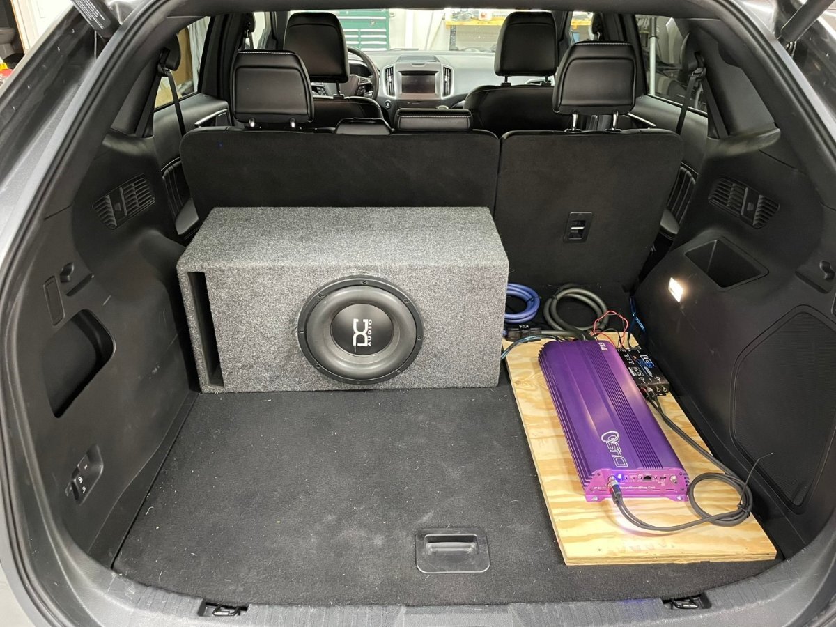

sc00by Posted July 1, 2024 Report Share Posted July 1, 2024 (edited) On 6/30/2024 at 12:56 PM, johnmarkp said: The body is only as good a ground as the connection between it and the negative terminal of the battery. I am pretty sure that there are several connections on the Edge. There's a TON of grounds on the Edge and they are all painted over with a bolt going through them. I can only imagine if this thing was 20 years old trying to chase electrical gremlins. I installed the amp.sub today. Since I don't have enough power to really drive it, it is fused at 150a. The wires are extra long intentionally as this is temporary. Longer term the amp and LOC will go under the carpet but that's a project for another day. Initial impression: That's a lot of bass. Might be a little heavy for the factory speakers to keep up but Pink Floyd and Fear Factory are just about right. Edited July 1, 2024 by sc00by 1 Quote Link to comment Share on other sites More sharing options...
johnmarkp Posted July 1, 2024 Report Share Posted July 1, 2024 That amp should really kit ass even with the low power being applied. You might have to update the rest of your system to keep up. 2 Quote Link to comment Share on other sites More sharing options...
sc00by Posted July 2, 2024 Report Share Posted July 2, 2024 13 hours ago, johnmarkp said: That amp should really kit ass even with the low power being applied. You might have to update the rest of your system to keep up. https://js-alternators.com/products/2020-2022-ford-edge-2-7l-250-320-370-400amp-high-output-alternator?variant=43186141757616 This would probably do. 1 Quote Link to comment Share on other sites More sharing options...
