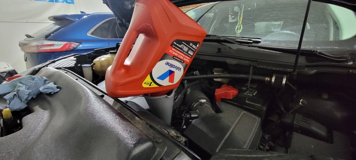

lildisco Posted March 17, 2024 Report Share Posted March 17, 2024 3 times drain & fill on our 2016 SEL Fwd 2.0 w/ 69,083 miles. 2nd time we've done it on the 2016. Got anywhere between 4 & 4.5 quarts out each time. This time we used Valvoline Maxlife instead of OEM 🤞 3 Quote Link to comment Share on other sites More sharing options...

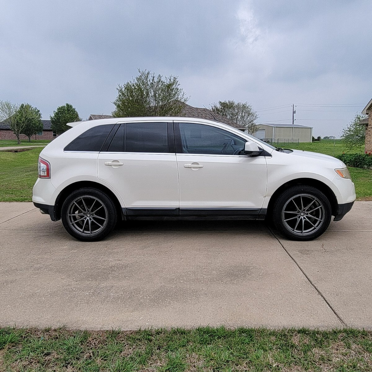

Tim W. AZ Posted March 22, 2024 Report Share Posted March 22, 2024 I dusted it off, cleaned the glass, blew out the engine compartment and applied silicon spray to the rubber door and hood gaskets. I started siliconing the rubber when I lived in Minnesota so the doors wouldn't freeze in winter, now I live in the desert so I do it to keep them from drying out. 1 Quote Link to comment Share on other sites More sharing options...

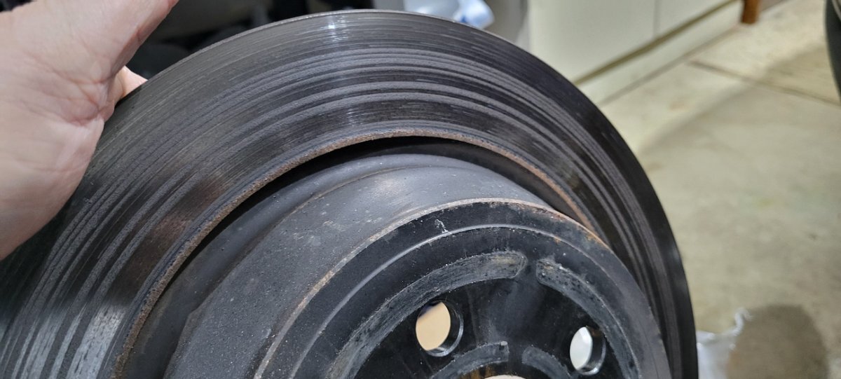

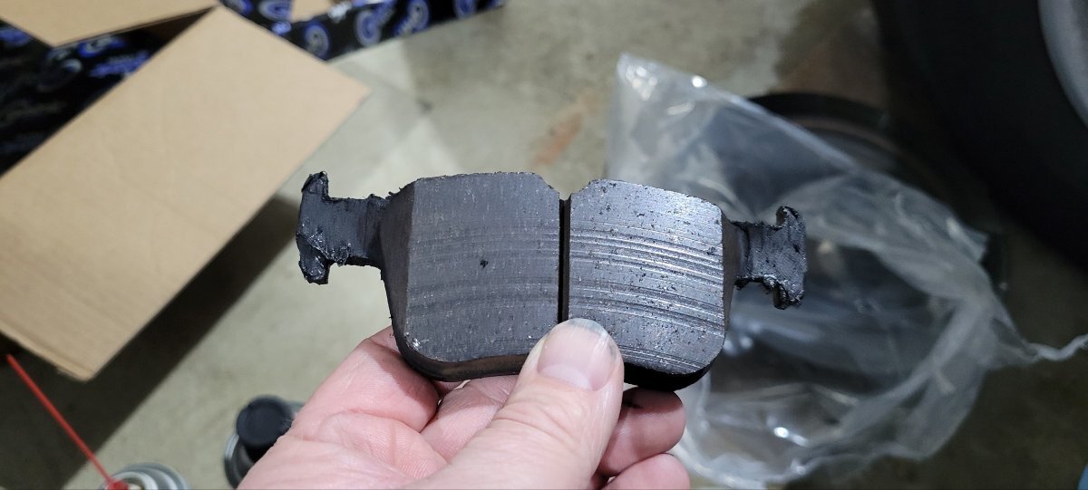

lildisco Posted March 31, 2024 Report Share Posted March 31, 2024 (edited) I've noticed a weird grove developing in my drivers side rear rotor. Took everything apart & cleaned & lubed everything. I probably could have paid someone to resurface both the pad & rotor, but it ~$150 for a new set of pads & rotors for the rear, so I just replaced them. Both sets were centric premiums & centric pads, so maybe something wedged between it & I didn't catch it. Relatively painless repair, took more time to find my rear caliper tool than anything.I've noticed a weird grove developing in my drivers side rear rotor. Took everything apart & cleaned & lubed everything last week, but no change. I probably could have paid someone to resurface both the pad & rotor, but it was ~$150 for a new set of pads & rotors for the rear, so I just replaced them. Both sets were centric premium rotors & centric pads, so maybe something wedged between it & I didn't catch it. Relatively painless repair, took more time to find my rear caliper tool than anything. Edited March 31, 2024 by lildisco 1 Quote Link to comment Share on other sites More sharing options...

kruzr1 Posted March 31, 2024 Report Share Posted March 31, 2024 10 hours ago, lildisco said: I've noticed a weird grove developing in my drivers side rear rotor. Took everything apart & cleaned & lubed everything. I probably could have paid someone to resurface both the pad & rotor, but it ~$150 for a new set of pads & rotors for the rear, so I just replaced them. Both sets were centric premiums & centric pads, so maybe something wedged between it & I didn't catch it. Relatively painless repair, took more time to find my rear caliper tool than anything.I've noticed a weird grove developing in my drivers side rear rotor. Took everything apart & cleaned & lubed everything last week, but no change. I probably could have paid someone to resurface both the pad & rotor, but it was ~$150 for a new set of pads & rotors for the rear, so I just replaced them. Both sets were centric premium rotors & centric pads, so maybe something wedged between it & I didn't catch it. Relatively painless repair, took more time to find my rear caliper tool than anything. I've had this happen on my edge also but not quite as bad. I replaced the rear pads, rotors and hardware last summer. I just noticed it is happening again. Only on the rear drivers side also, sure seems kind of odd. I don't notice anything odd during braking. 1 Quote Link to comment Share on other sites More sharing options...
lildisco Posted March 31, 2024 Report Share Posted March 31, 2024 2 hours ago, kruzr1 said: I've had this happen on my edge also but not quite as bad. I replaced the rear pads, rotors and hardware last summer. I just noticed it is happening again. Only on the rear drivers side also, sure seems kind of odd. I don't notice anything odd during braking. I'm wondering if some sort of debris from the pads? I've had 4 or 5 sets of these over the years on different vehicles & have never had an issue. Maybe this was just a fluke. Surely it's odd, but relatively cheap repair. 1 Quote Link to comment Share on other sites More sharing options...
garycrist Posted March 31, 2024 Report Share Posted March 31, 2024 It starts from "hard spots" in the pads. It is from the mixture of materials in the pad material before it is formed and fired or baked. The pad is not homogeneous, but a mixture for an example, steel wool, copper bits for heat extraction a bonding agent baked then glued or riveted to the steel backing plate. As the pads apply, heat is generated in the of a rotor. Cooling differences, will lead to "hot spots" that change the surface hardness in a particular spot leading to irregular wear patterns. 2 Quote Link to comment Share on other sites More sharing options...

enigma-2 Posted March 31, 2024 Report Share Posted March 31, 2024 19 hours ago, lildisco said: I've noticed a weird grove developing in my drivers side rear rotor. Years ago, an old mechanic told me it was caused by metal on the pads/rotors. Asked where it came from, he said it was usually rust from the brake assy. Breaks off and falls on rotor where it's trapped. As it only happened on one wheel, I'd clean off the rust of all parts, when replacing pads/rotors. (As a precaution.) Another mechanic told me that because it had only happened on the right side of my car, must have hit a mud puddle that had sand/dirt in it. The sand splashed up on the brakes, getting stuck on rotor, trapped between pads and rotors. (Pearls of wisdom from grease monkeys) 1 Quote Link to comment Share on other sites More sharing options...

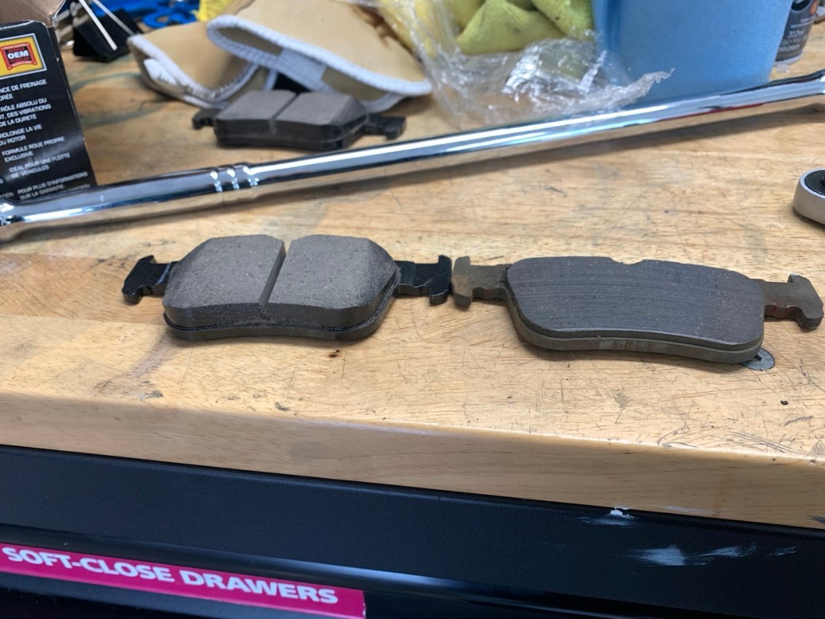

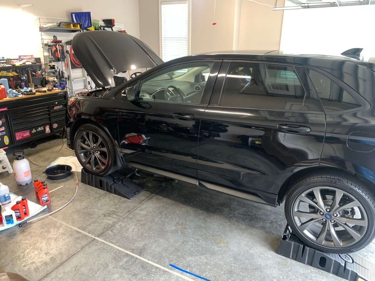

1004ron Posted March 31, 2024 Report Share Posted March 31, 2024 (edited) 102,091 miles and first rear brake pads replacement and second transmission fluid drain and fill. Previous transmission drain and fill was at 46,175 miles. Drain and filled the transmission and new rear brake pads. I went with Akebono brake pads that have the mechanical wear indicators, which the original pads did not, and if they had they'd have been screaming. I used my Gerber multi-tool to turn the caliper pistons back in (clockwise), but will get a basic tool before the next pad change in 7 years. Edited March 31, 2024 by 1004ron 3 Quote Link to comment Share on other sites More sharing options...
garycrist Posted March 31, 2024 Report Share Posted March 31, 2024 I will bet none of them have ever ground "hot spots" out of a brake drum. Nor, have they ever seen a drum so bad with "spots" they had to be thrown away. Now a lot of aftermarket flywheels have a replaceable or harden areas where the friction material contacts. Some have (flywheels) have grooves (like brake rotors) to get rid if the out-gassing and prevent micro-welding or metal smearing. I have used flywheels as they can represent one of the most extremes as are brake drums. Those grooves in the rotor as well as hot-spots in drum brakes are analogous to "flat-spots" in a tire! Once one puts a flat spot in a tire, no matter the size, every time a lock-up or near lock-up occurs it will almost always hit the flat-spot thus exacerbating the problem. Lastly there just "ain't no space tween that rotor and brake pad"! 1 Quote Link to comment Share on other sites More sharing options...
