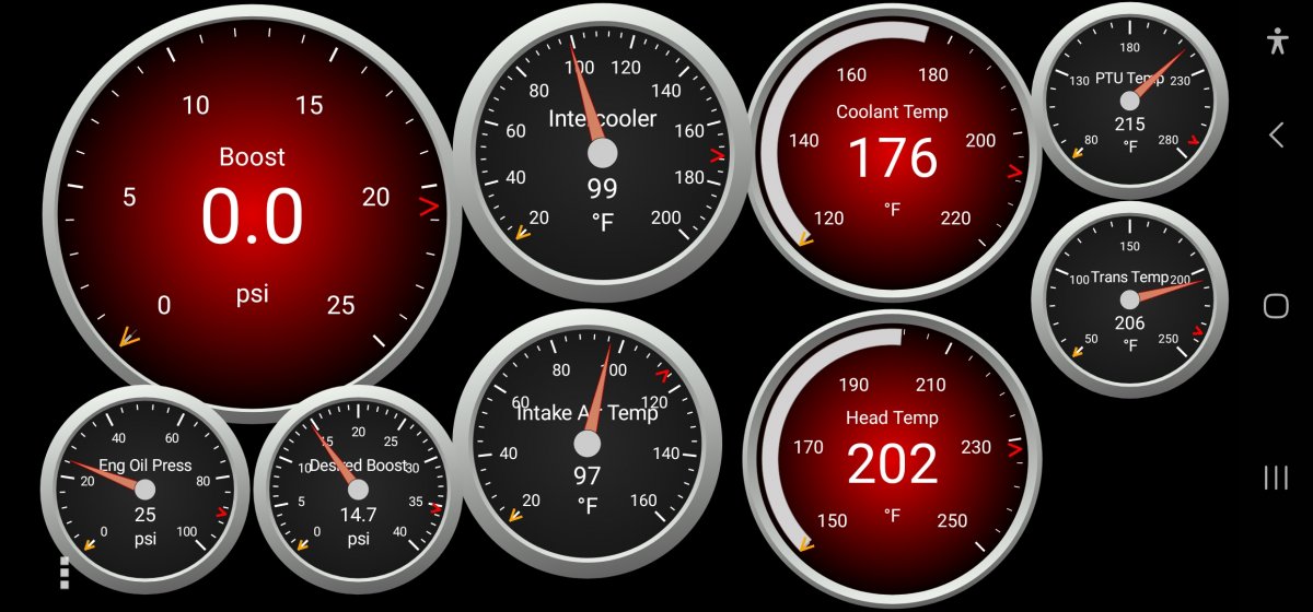

Cerberus Posted August 2, 2023 Report Share Posted August 2, 2023 (edited) 5 hours ago, WWWPerfA_ZN0W said: nobody wants to lose that 0.1 mpg turning on a/c will cause lol. Well as far as that goes, with air temps over 100, I presume the AC is running anyway, and if not, as long as you are driving along at more than 20 mph, the air flow through the radiator is generally sufficient to keep the engine cooler than the stock fan set point. Side note, I took a hard ride after the wheel bearing job to verify the repair, and was running my data logger. Arrowheads indicate max and min values Edited August 2, 2023 by Cerberus Correction 2 Quote Link to comment Share on other sites More sharing options...

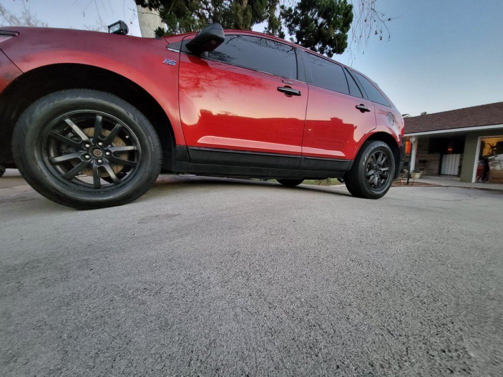

Ford4Life951 Posted November 21, 2023 Report Share Posted November 21, 2023 New to the group so I guess I need to back track all that I've done to my 11 year young Edge. Its a Limited AWD so first thing first, got rid of those ugly chrome clad wheel covers to find highly potential aluminum wheels. Painted them many different colors, Gold, Bronze Red, Red and black(I called them the Black Widow wheels) now at a beautiful powder coat pearl black. Got rid of the stock air box, upgraded to a 57 series K&N and choped the Muffler off and ran a twin pipe out. Now it sounds like a true V6 SUV. Replaced the vented rotors with summit racing drilled and slotted rotors front and rear. Not a lot to the powertrain, mostly interior exterior components. Swapped dull clear map lights with red lights in front blue in rear. 6" Rigid light bars on both sides of the upper hood. Cut out the solid portions of the multi sectioned grill, saw a significant drop in air intake temps at the head, highly recommend. Installed different length single row light bars within the grill as well as 8" single row yellow and white light bars in the rear(to the left and right of the rear washer nozzle, helps tremendously when backing up at night.) Body color is Ruby Red, did powerder coated black race stripes from the hood back. And because I'm a music guy kept the 12 speakers in great shape and added 2 10" Kicker Subs with a small 500 watt kenwood amp. I've added a lot of things to my girl and removed some as well. 2 Quote Link to comment Share on other sites More sharing options...
Xtra Posted November 21, 2023 Report Share Posted November 21, 2023 How about a couple good photos. It sounds like it is a nice ride.? Quote Link to comment Share on other sites More sharing options...
Ford4Life951 Posted November 21, 2023 Report Share Posted November 21, 2023 2 Quote Link to comment Share on other sites More sharing options...
Ford4Life951 Posted November 22, 2023 Report Share Posted November 22, 2023 this 4.8mb max upload sucks. all my photos are in that range or above haha Quote Link to comment Share on other sites More sharing options...
Xtra Posted November 22, 2023 Report Share Posted November 22, 2023 (edited) 23 hours ago, Ford4Life951 said: this 4.8mb max upload sucks. all my photos are in that range or above haha Nice ride, thanks for the photo. All you have to do is resize the photos and the site works great. Edited November 22, 2023 by Xtra 1 Quote Link to comment Share on other sites More sharing options...

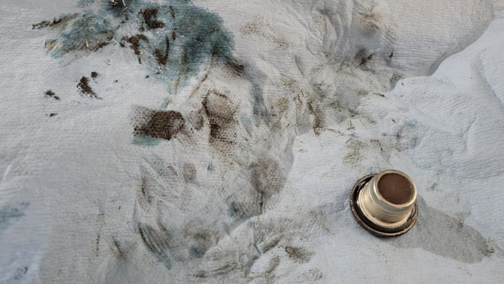

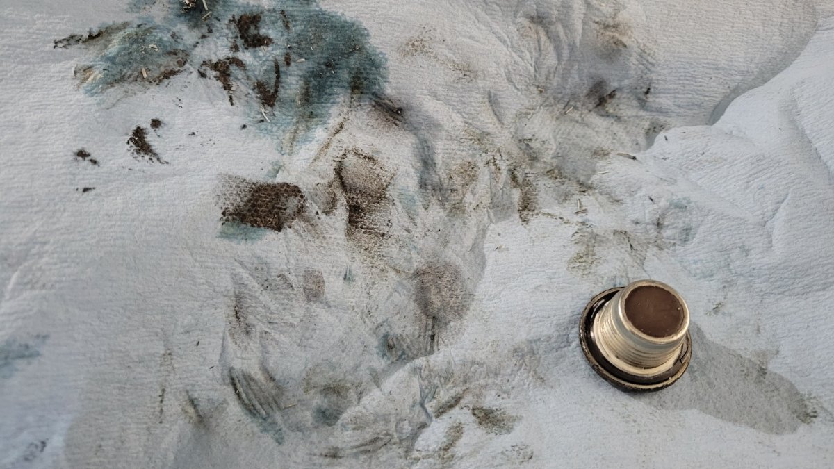

lildisco Posted November 24, 2023 Report Share Posted November 24, 2023 (edited) Roughly time for an oil change, so I decided to do that & drain & refill the PTU. The PTU had about 8,000 miles on it since I drained the OEM fluid & replaced it with Redline Lightweight Shockproof 75W140. It had very little gunk on it compared to last time. Edited November 24, 2023 by lildisco 4 Quote Link to comment Share on other sites More sharing options...

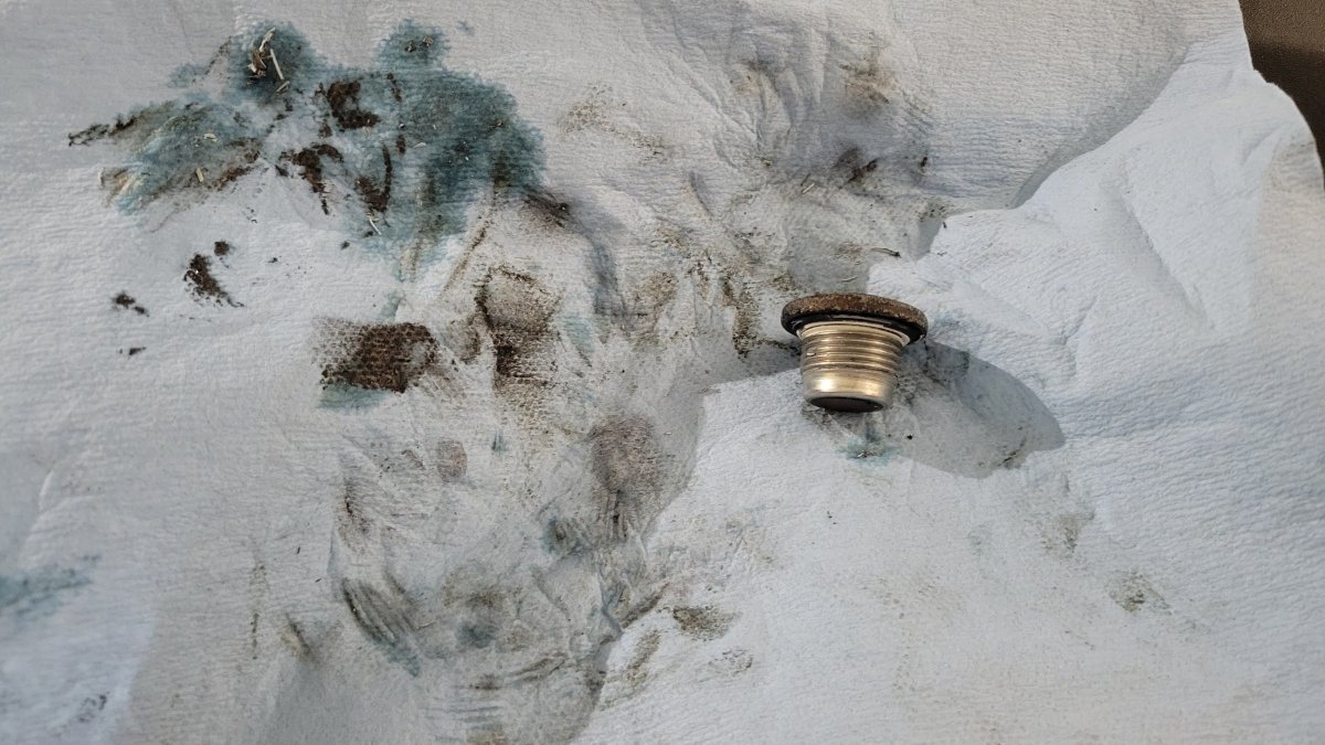

lildisco Posted November 24, 2023 Report Share Posted November 24, 2023 (edited) Compared to this at just under 18,000 Edited November 24, 2023 by lildisco 4 Quote Link to comment Share on other sites More sharing options...

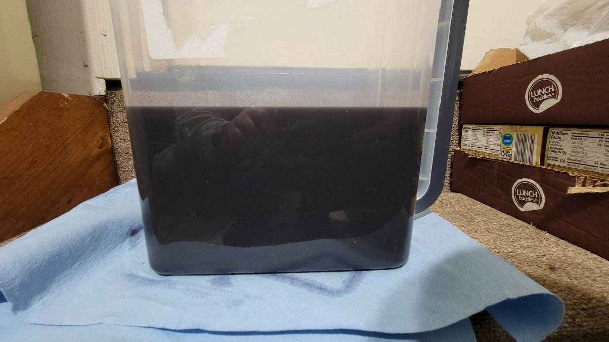

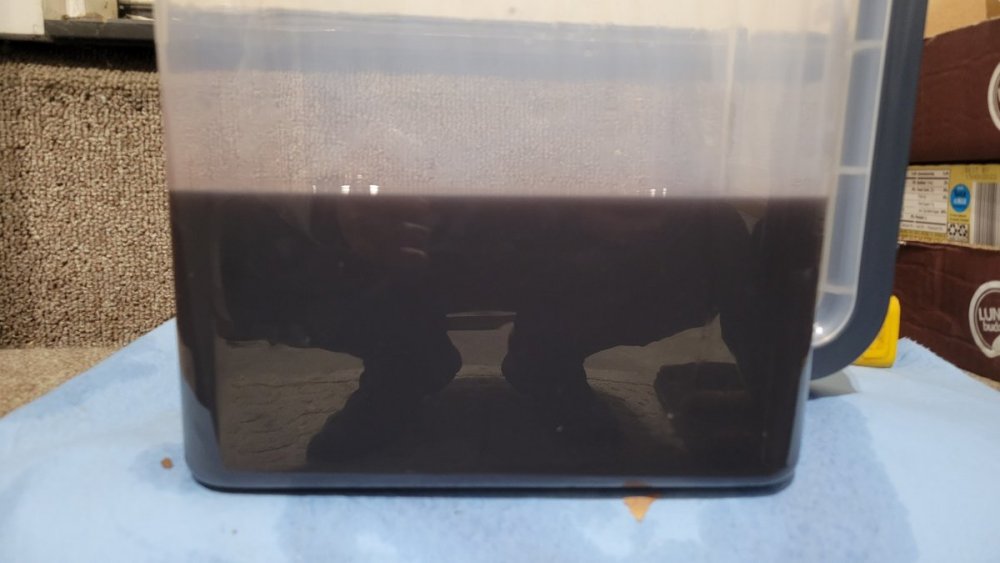

lildisco Posted November 26, 2023 Report Share Posted November 26, 2023 Also decided to do a transmission Drain & fill x3, touch up my undercoating with Fluid Film & swap over to my winter rubber on our 2020 SEL AWD. Spring me screwed fall me & didn't clean the winter wheels when the weather was nicer & warmer. So that took some extra time & nice hot bucket of water. Besides touching up the door hinges & the bottom of the doors & hatch, I should be ready for winter. The 1st drain & fill got about 4.2 qts out & the other 2 got 3.5 qts out. Motorcraft Ulv fluid was $3/qt cheaper than Valvoline equivalent. Fluid was quite dark & a tiny hint of red in it. On the 3rd drain, there was more red in it. Currently ~26,000, but I did a lot of hauling with a small utility trailer & ztr this year & wanted to be extra cautious. A friend of mine who owns a transmission shop said that I should be fine till next year, but was shocked at how dark the fluid was. It was getting late & I was tired & forgot to snap a Pic of the 3rd drain, but it was more red than the first 2. 1 Quote Link to comment Share on other sites More sharing options...

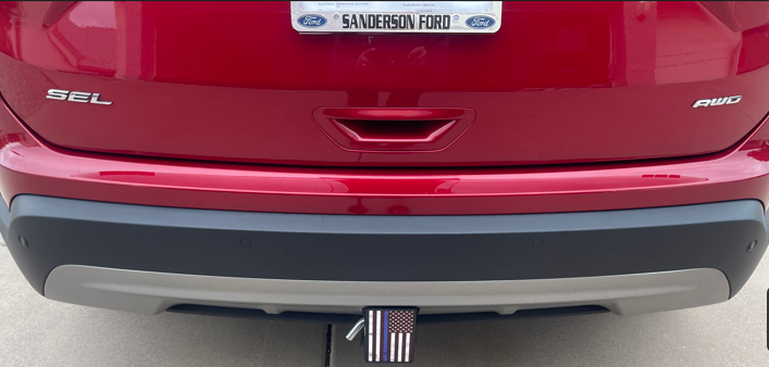

AZ Shiflett Posted December 25, 2023 Report Share Posted December 25, 2023 (edited) Added a new "Thin Blue Line” American flag hitch cover on Saturday. Will add a pic tomorrow. Edited December 25, 2023 by AZ Shiflett 1 Quote Link to comment Share on other sites More sharing options...
AZ Shiflett Posted January 1, 2024 Report Share Posted January 1, 2024 Thin Blue Line Flag - Trailer Hitch cover 2 Quote Link to comment Share on other sites More sharing options...
