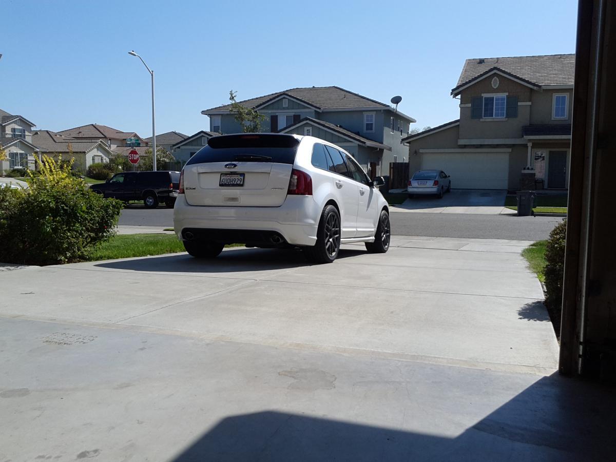

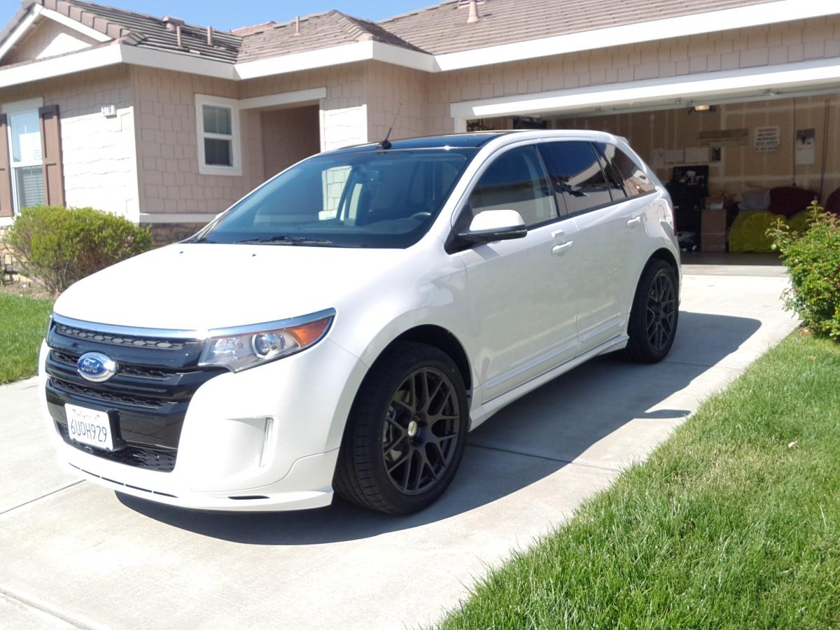

IXIVI Posted October 11, 2013 Report Share Posted October 11, 2013 (edited) Finally got around to installing the Gunmetal TSW Nurburgrings (24.5 lbs!!). 295/40/20 Falken Azenis 453CC weigh in at 36. Factory Sport 22s tip the scales at 84 lbs.... Total weight savings of 24 lbs on each corner. For the wheel weight savings naysayers? +3 MPG. Butt dyno is marginal. The suspension however, is phenomenal. The ultra light weight wheels coupled with the H&R springs act x10 out on the road. The Edge litteraly glides around now. The reduced weight seems to go a long way in helping the shocks keep the wheels and tires planted to the road.... Edit: can't post from photo bucket on my nexus. Uploading now. Edited October 11, 2013 by IXIVI 3 Quote Link to comment Share on other sites More sharing options...
WWWPerfA_ZN0W Posted October 11, 2013 Report Share Posted October 11, 2013 (edited) Lookin' good! Better ride AND mileage, can't beat that Aren't those tires a bit wide, though? How do they sit? Edited October 11, 2013 by WWWPerfA_ZN0W Quote Link to comment Share on other sites More sharing options...
IXIVI Posted October 11, 2013 Author Report Share Posted October 11, 2013 Lookin' good! Better ride AND mileage, can't beat that Aren't those tires a bit wide, though? How do they sit? They are a little wide, sure. But that was the idea. If I went with 20s, they had to be meaty and have a taller sidewall than the 265/40 of the factory so they would still the fill out the wheel well. The 295/40 brings the overall diameter right up to the size of the factory wheels as well, so the speedo isn't affected much. I'll take a closeup when I get a chance, but they only stick out about a .25" further than the OEM sport wheels/tires. They look great. Quote Link to comment Share on other sites More sharing options...
wannabang Posted October 11, 2013 Report Share Posted October 11, 2013 They do look great and they fill out the wheel well extremely well. Very nice! Quote Link to comment Share on other sites More sharing options...

IXIVI Posted October 13, 2013 Author Report Share Posted October 13, 2013 (edited) Drove around a bit yesterday, and I had to report back with more news on these wheels. Butt dyno is no longer marginal. Kickdown acceleration, from 6th to 4th, or from 4th to 2nd saw a HUGE, HUGE improvement. So much so that my wife even noticed.... she asked like a smart ass "what did you do now, its faster than I remember" Braking also saw a massive improvement. I no longer feel like I'm towing boat when I try to stop. Braking is much more balanced and tight. So far, its all good news from the weight savings! Edited October 14, 2013 by IXIVI Quote Link to comment Share on other sites More sharing options...

IXIVI Posted October 14, 2013 Author Report Share Posted October 14, 2013 What is the width of the wheels? 20X10 Quote Link to comment Share on other sites More sharing options...

IXIVI Posted October 19, 2013 Author Report Share Posted October 19, 2013 Great looking Rim!! And not a bad price.. I did the 22x9.5 TSW Snettertons on my Edge wrapped with Yokohoma Parada Spec-X's and I love them. Paid right at like 2,300$ from Discount Tire for everything out the door, including warranty on the Tires! I remember lurking a while back and seeing you post about the Snettertons. They look good, but I was moving away from the 22s all together, and once I was set on the Nurburgrings all bets were off. The more I drive with them, the more I really appreciate the weight savings. The look is really growing on me too. The flat gunmetal offset against the white platinum pearl of the Edge really pops. I'm going to spend a few hours cleaning up, polishing and waxing this weekend and then I will get more pics up... Quote Link to comment Share on other sites More sharing options...
