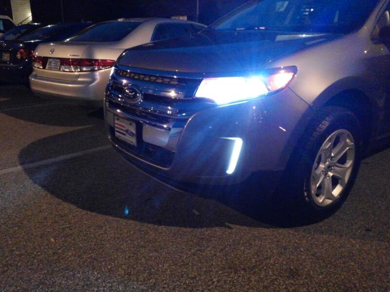

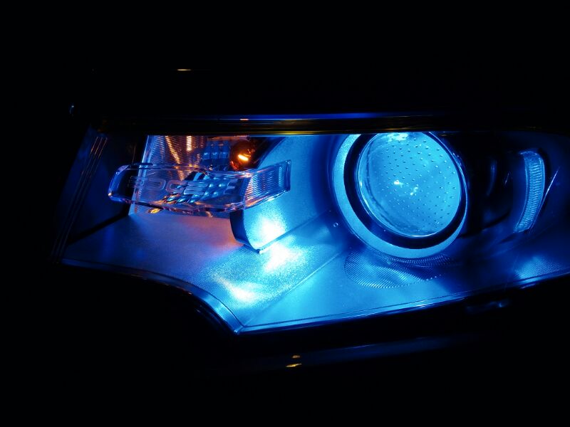

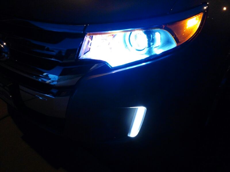

Msl558 Posted October 3, 2013 Author Report Share Posted October 3, 2013 Just installed my 6000k 9006 H.I.D kit by Optics. Quote Link to comment Share on other sites More sharing options...
Msl558 Posted October 4, 2013 Author Report Share Posted October 4, 2013 i just noticed that the hid is not aa bright as i wanted. im thinking to swith to 55 watts ballast just like i used on my g35 and f150. or it just needa adjustments? need ur thoughs guys. thanks! Quote Link to comment Share on other sites More sharing options...
omar302 Posted October 4, 2013 Report Share Posted October 4, 2013 If you want bright, choose 4300k colour as it gives the most light. Stock HID is also 4300k. Quote Link to comment Share on other sites More sharing options...
normcloutier Posted October 4, 2013 Report Share Posted October 4, 2013 Remember to use a wire harness for 55 watt ballasts. 35's are usually ok on factory wiring but 55's need more current. Quote Link to comment Share on other sites More sharing options...
RustyEdge Posted October 4, 2013 Report Share Posted October 4, 2013 I too wasn't satisfied with the light output of my original 6k kit. I ended up going with the 55w 5k kit from DDM with a morimoto harmess and it's perfect! Soooooo much bright white light! Remember if you go 55w it will burn brighter so the 5k will look almost like the 4300. Mine is super white with a hit of blue only on the very top before the cutoff. Quote Link to comment Share on other sites More sharing options...
candurin Posted October 4, 2013 Report Share Posted October 4, 2013 6K is a very poor choice if your looking for brightness or usable light. The more blue you go, the more light you lose. Quote Link to comment Share on other sites More sharing options...
