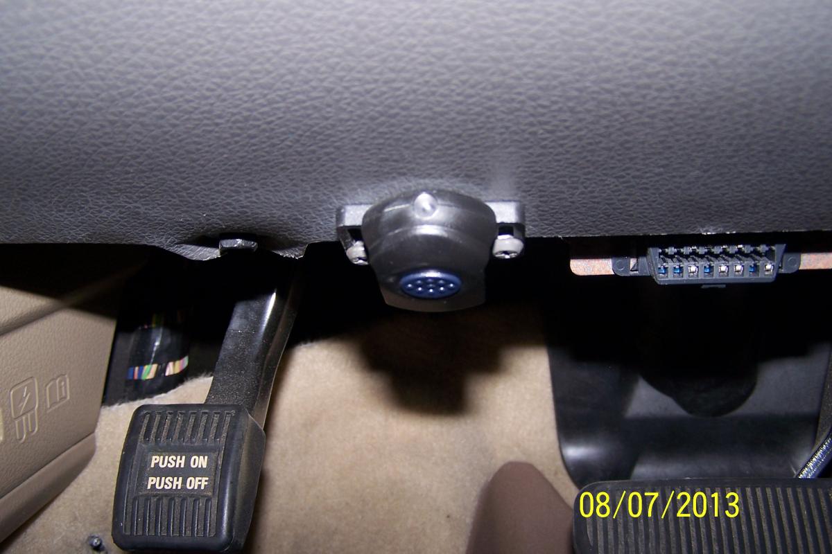

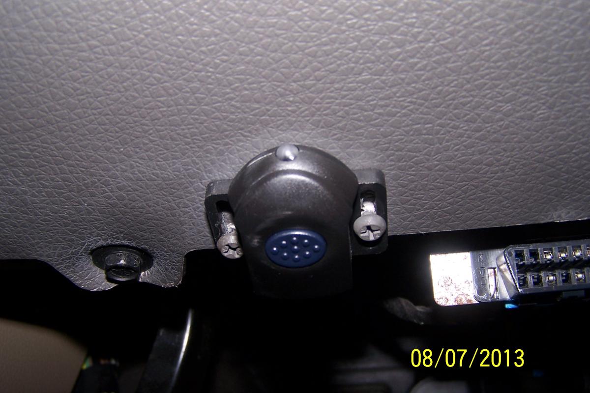

Handyone Posted August 8, 2013 Report Share Posted August 8, 2013 I have a 2007 edge we bought used a couple years ago for my wife, she drives it 99% of the time. I just noticed a switch mounted below the steering wheel. Didn't seem to do anything. I tried to trace the wires (3) coming out of it , but I can't contort (@my age) to see up under the dash. I removed it last night. Wife called me today and said the horn doesn't chirp when she locks/unlocks the doors with the remote. It looks after market & I can't find anything about it in the manual. I can use some help if anyone has seen this before. Quote Link to comment Share on other sites More sharing options...
wannabang Posted August 9, 2013 Report Share Posted August 9, 2013 It's definitely aftermarket, but I can't imagine that a security system has a visual switch to shut it off... without tracing the wires, I would have no clue what it is. See if there's a part number of company name on it somewhere and do a web search? Quote Link to comment Share on other sites More sharing options...
TheWizard Posted August 9, 2013 Report Share Posted August 9, 2013 It looks to be the momentary switch used in aftermarket alarms to program system options and control things like valet mode. You would have to find the alarm "brain" box to get the alarm make and model so you could find an owner's manual. Quote Link to comment Share on other sites More sharing options...

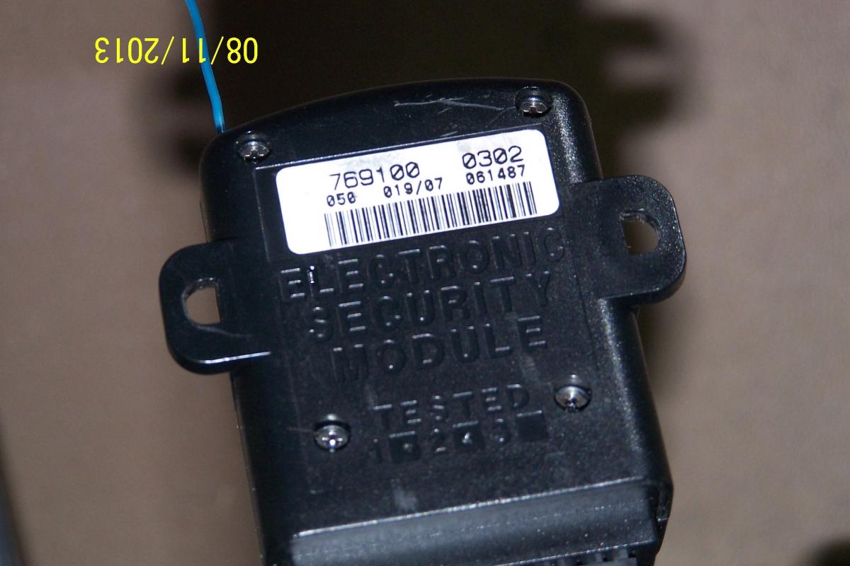

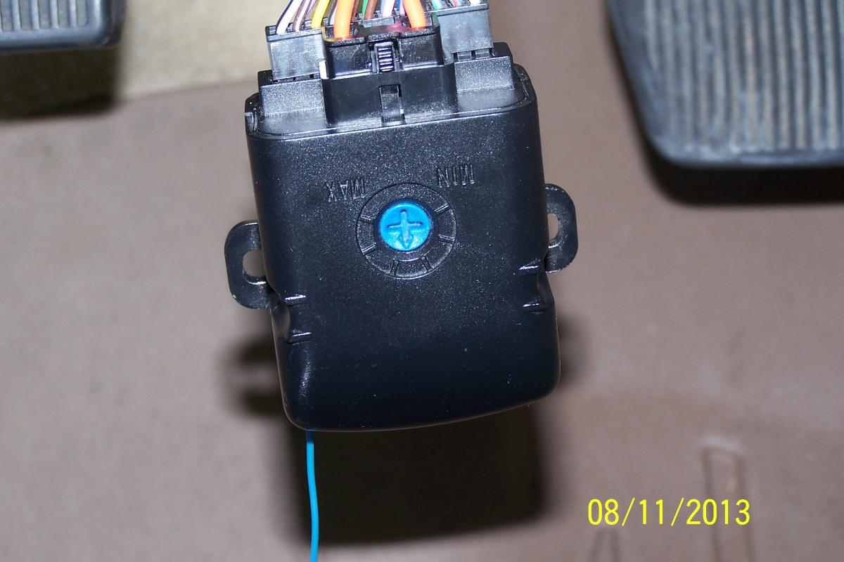

Handyone Posted August 11, 2013 Author Report Share Posted August 11, 2013 Chapter Two Ok, I took the dash apart today & here is what I found. No name anywhere on the alarm (not very proud of their product). I "googled" the number on it & found out it is a "KARR" after market alarm usually installed by dealers. Searched online for "Karr" & very little info about them. Has anyone heard of them? Quote Link to comment Share on other sites More sharing options...

shamrok911 Posted August 19, 2013 Report Share Posted August 19, 2013 With the adjustment screw on the front, that looks like a motion sensor module, not the alarm itself. Try tracing the harness wires a little further, you should run into the alarm "brain." Quote Link to comment Share on other sites More sharing options...
