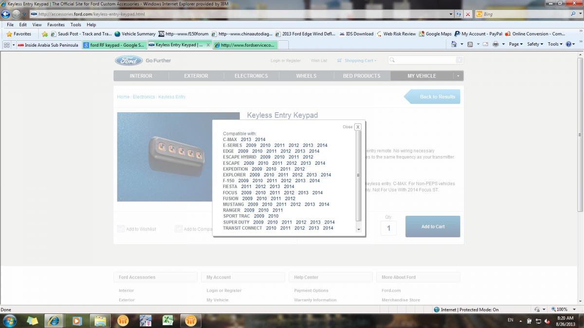

sajid.ali Posted August 26, 2013 Author Report Share Posted August 26, 2013 Got Official reply from Ford this morning as below: UnQuote This accessory is designed to operate at 315MHz door lock frequency. This vehicle uses 433MHz door lock frequency. This accessory is not available for 433MHz door lock frequency. Quote I donot understand why FORD has mentioned on their website that this accessory is compatible with Ford edge upto 2014 models. Quote Link to comment Share on other sites More sharing options...
omar302 Posted August 26, 2013 Report Share Posted August 26, 2013 I guess that's because the US Edge still uses 315MHz. For some reason the 2013 Ford vehicles coming to the GCC are coming with 433MHz. Quote Link to comment Share on other sites More sharing options...
akirby Posted August 26, 2013 Report Share Posted August 26, 2013 I guess that's because the US Edge still uses 315MHz. For some reason the 2013 Ford vehicles coming to the GCC are coming with 433MHz. It must be a local regulation of some kind. Someone must already be using 315 mhz. Quote Link to comment Share on other sites More sharing options...
