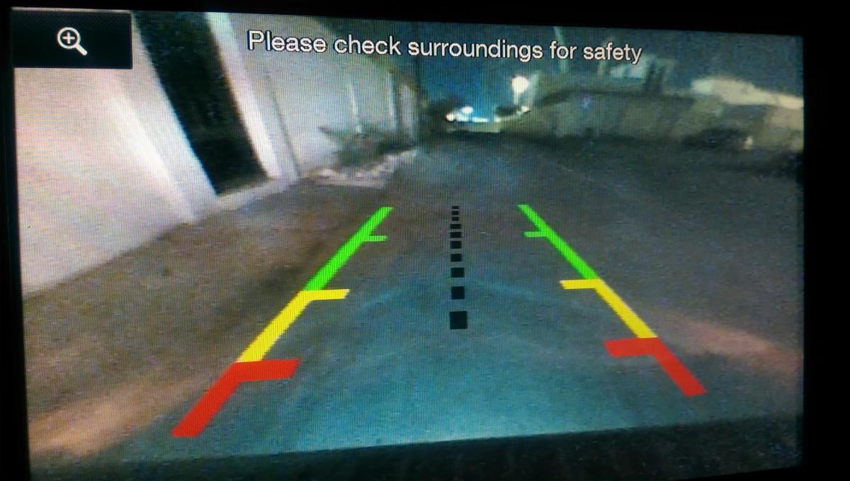

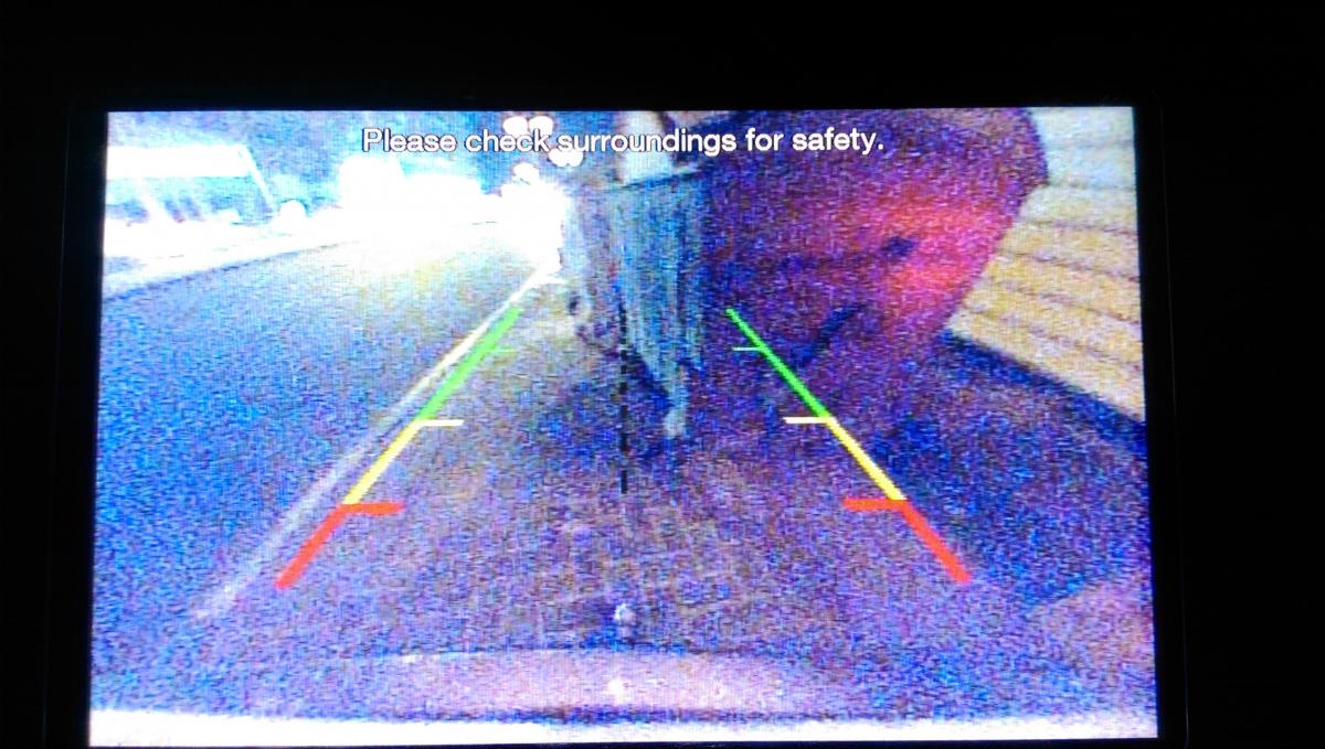

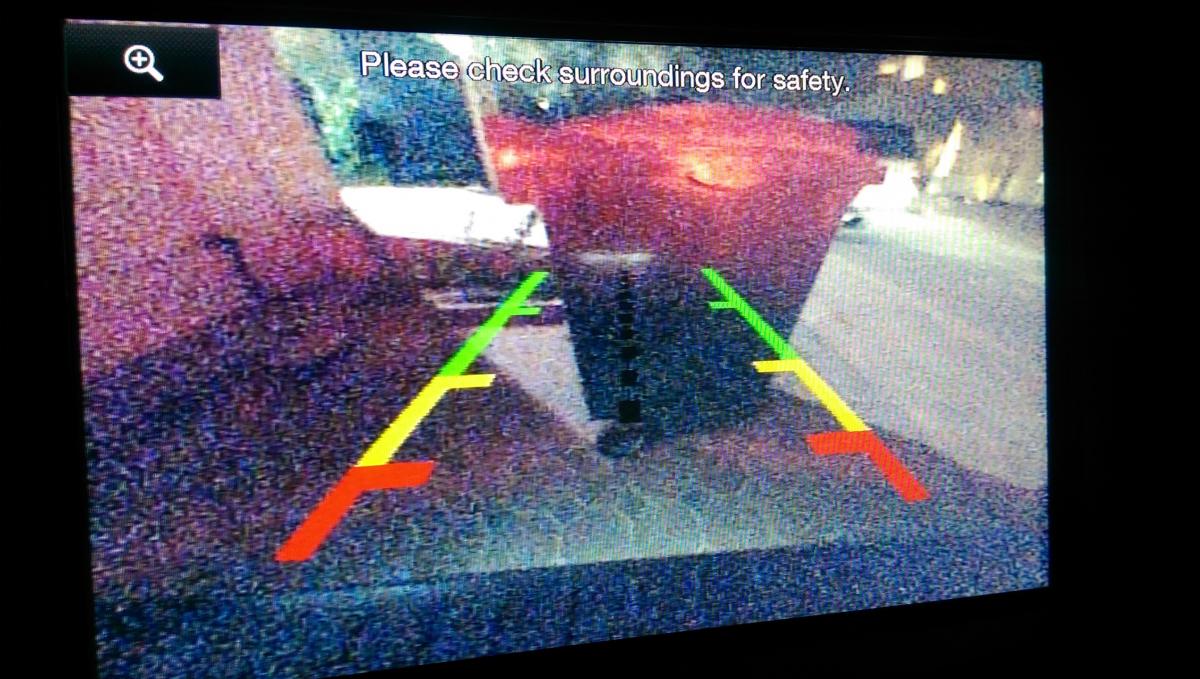

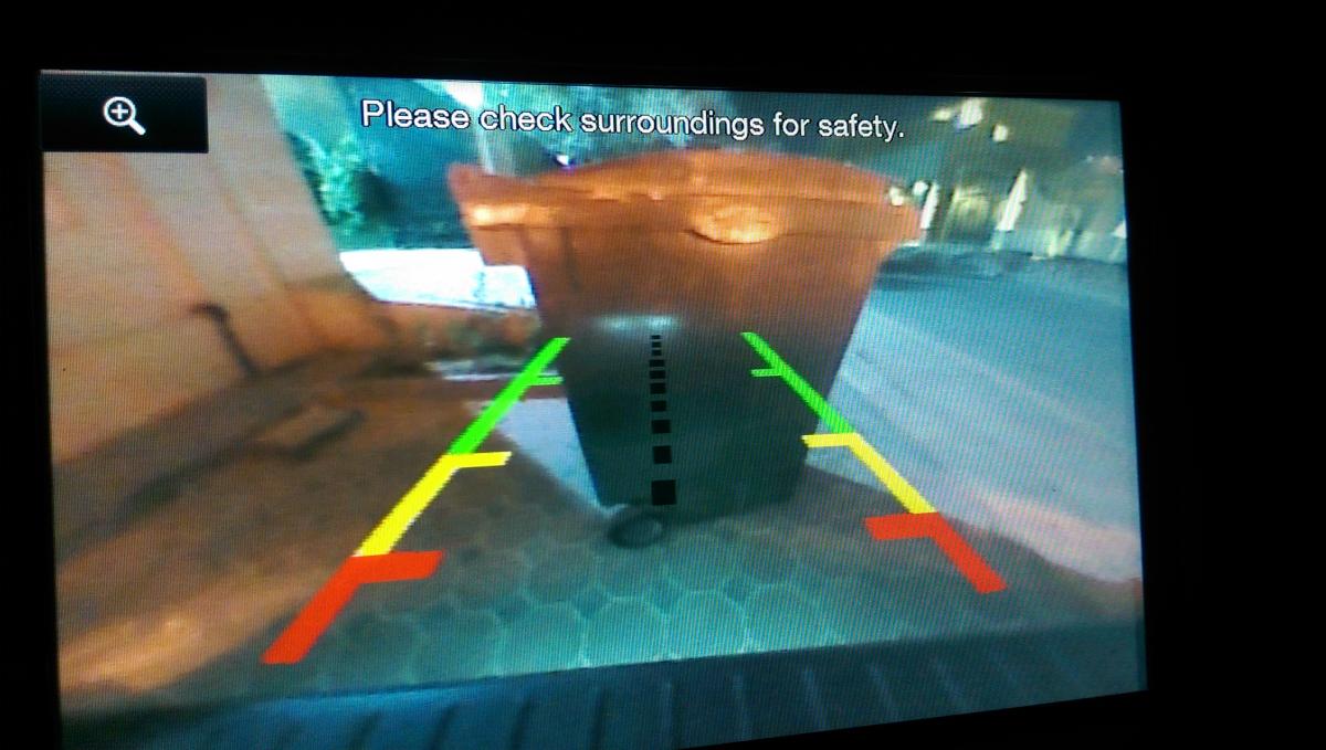

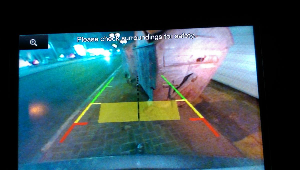

omar302 Posted September 30, 2014 Report Share Posted September 30, 2014 An update to this same topic. Had always noticed that at night near my place, the camera display would be grainy, while at my Parents it is clear at night. Then I realized that I park in reverse at my place, meaning the Camera turns on after driving for a certain period, while at my Parents, I would park straight, so when I back up, it would be the 1st thing I do after starting. So after some testing, I found out that the rear Camera gets grainy at night after driving for some time (maybe heat?) but turning off the car (Center display off) for a few minutes (3-5 minutes) then turning the rear camera on (reverse), the display becomes clear!! Pictures speak for themselves! My 2011 MKX: Sample 1, at 9 PM: Same view at 10:43 PM (1:43h later): Sample 2, at 8:49 PM: Same view at 8:51 PM (2 minutes later) A buddy's 2013 Explorer: At 10:29 PM: Same view after less than minute later: 1 Quote Link to comment Share on other sites More sharing options...
