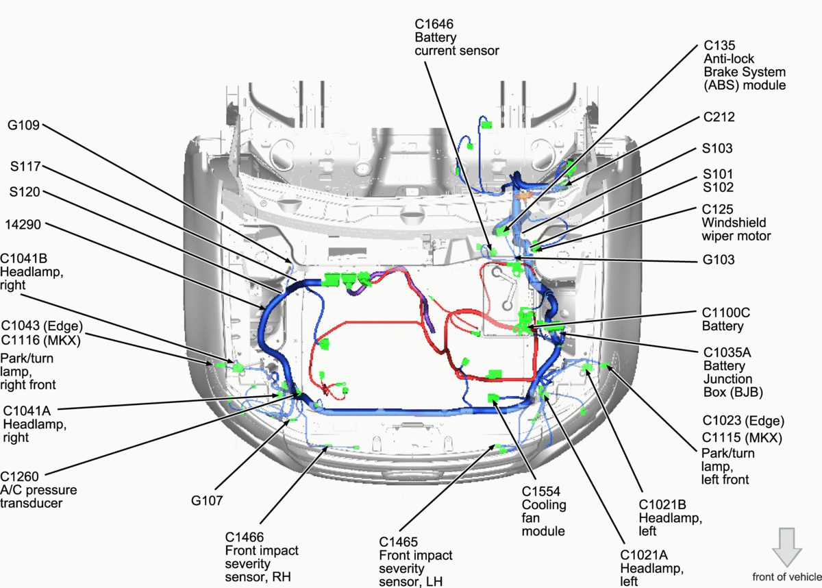

mvan231 Posted June 17, 2019 Report Share Posted June 17, 2019 20 minutes ago, Runterborn said: I have, what seems to be, a very common problem with my 2013 Edge. Overheats in stop/go traffic or City driving. I put the AC on Max and pop the hood. Neither fan is spinning. After reading various threads about this, I start at the fusebox under the hood. Fuses good. Check the connections to the relay, nothing obvious, i.e. connectors not burnt or corroded, but the module itself looks like it might have gotten hot. The label on the module is discolored and flaking off. After another quick search I figure that I need to replace the relay. Relay replaced and still no fans. Replace fan assembly, with a Dorman, and return relay, still no fans. While I seem to be enjoying this game of throw parts at the problem, I honestly don't know where to go next. I read somewhere that the Cylinder Head Sensor may be bad which may be causing the relay to not turn off/on but cannot confirm that information. Any thoughts? Have you captured any wiring diagrams to start diving into the power and ground of the circuit itself? I looked them up and it looks like this isn't a typical relay controlling a high current circuit like a blower motor relay circuit would be. Apparently the module has a relay, but there is no direct method to power the fans. Which relay were you checking? I don't see a relay for cooling fans in the underhood fuse panel diagram. 1 Quote Link to comment Share on other sites More sharing options...
akirby Posted June 17, 2019 Report Share Posted June 17, 2019 Dormans suck - that might either be a bad unit or the connection isn't good. I would assume the temp sensor is the same one that's feeding the temp gauge so if that shows it overheating then that's probably not the problem. 1 Quote Link to comment Share on other sites More sharing options...
Runterborn Posted June 17, 2019 Report Share Posted June 17, 2019 38 minutes ago, mvan231 said: Have you captured any wiring diagrams to start diving into the power and ground of the circuit itself? I looked them up and it looks like this isn't a typical relay controlling a high current circuit like a blower motor relay circuit would be. Apparently the module has a relay, but there is no direct method to power the fans. Which relay were you checking? I don't see a relay for cooling fans in the underhood fuse panel diagram. There is a relay on the drivers side of the fan assembly. I have the towing package so there was one lead going in and two, one to each fan, coming out. Based on the diagram above the relay plugs into C1554. 1 Quote Link to comment Share on other sites More sharing options...

mvan231 Posted June 17, 2019 Report Share Posted June 17, 2019 50 minutes ago, Runterborn said: There is a relay on the drivers side of the fan assembly. I have the towing package so there was one lead going in and two, one to each fan, coming out. Based on the diagram above the relay plugs into C1554. That is quite interesting that it isn't in the diagram. Do you have photos of the unit? I wonder if you apply direct power to the fan motor power if it will spin. Could be that the cooling fan module itself is dead Quote Link to comment Share on other sites More sharing options...
