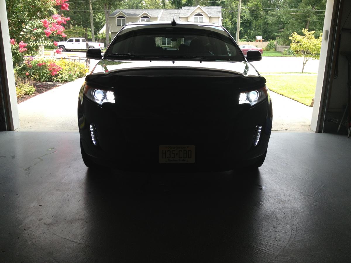

candurin Posted August 9, 2013 Report Share Posted August 9, 2013 Here's some crappy iPhone photos I just tried to snap. 1 Quote Link to comment Share on other sites More sharing options...
