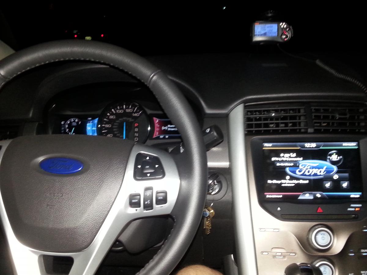

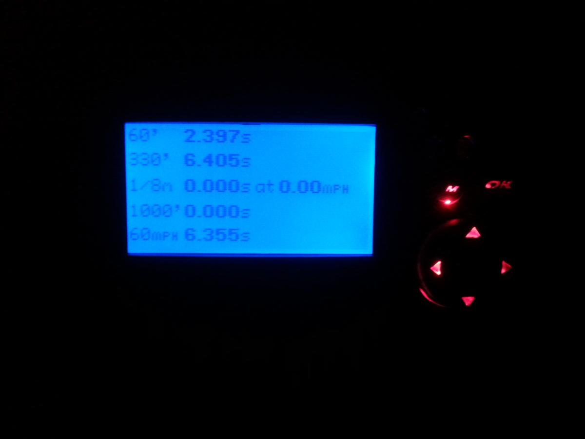

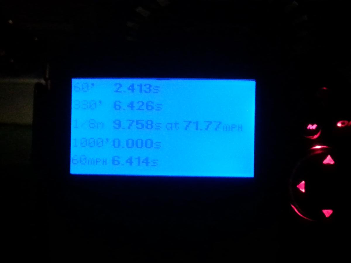

FordMan1977 Posted June 17, 2013 Report Share Posted June 17, 2013 Well I had some time this weekend to get a good 0-60 base run on my Edge. I ran several 0-60 runs. Traction control on TC off. Selectshift no selectshift. Rev to 2000rpm and release brake. Of all these tests the Edge had the lowest 0-60 by just stabing the gas from idle with the TC off. My Edge is a completely stock 2013 3.5L SEL AWD with 20" wheels. My runs were done using a g-tech pro accelerometer unit. My Edge has 7, 500 mi. I had 3/4 tank of 87oct fuel and air temp was 55* All runs I did were within a few hundreths of a sec of my best. Basically if you took all the runs to create an average I get 6.42sec 0-60. My best was 6.35s. Not bad for a stock Edge! I just thought I would share my results. I do plan on doing some mods and this will be a great tool to use for refetence of improvement each mod gives. 1st pic is just how I had the g-tech set up and its location. 2nd pic is the test data on my best 0-60 run. 1 Quote Link to comment Share on other sites More sharing options...

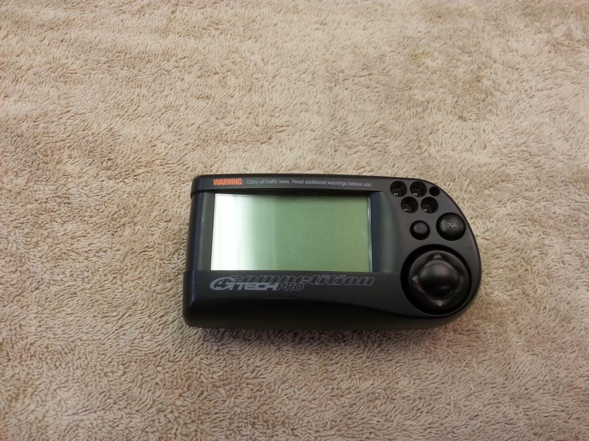

WWWPerfA_ZN0W Posted June 17, 2013 Report Share Posted June 17, 2013 That's a pretty fast time, FordMan! I always thought an Edge was in the 7.5 second range 0-60. Is your version of the g-tech unit accurate/replicable? I have an old old version I used over a decade ago, didn't find it to be reliable so I stopped using it. Do you know what the stall speed is for the torque converter? Is that how you chose the rpms? Very interested in your progress! Quote Link to comment Share on other sites More sharing options...
FordMan1977 Posted June 17, 2013 Report Share Posted June 17, 2013 Well all I can say is I ran the Edge several runs and they all were within a couple hundreths of a second each test. Consistant 6.40-6.47 0-60. My best was the 6.35 but it only ran that one time. So that's why I did the average of all the runs and cane up with 6.42. I do believe my g-tech is quite accurate because the numbers were very close no freak runs. I do plan on doing a few more 0-60 tests another day just to confirm. I know I'm a bit skeptical on the numbers too. But she does pull strong. I need to set up a youtube account so I can post some video. The 6.35 run was just stab the gas off idle with the TC off. When I tried to preload the converter @ 2000rpm the times were slower. I tried a couple of selectshift runs those were slower as well. I know one thing the AWD is working!! Not a hint of wheel spin.... just go! ! 1st pic is the g-tech I tested with. 2nd pic is another 0-60 run with the Edge. 1 Quote Link to comment Share on other sites More sharing options...
