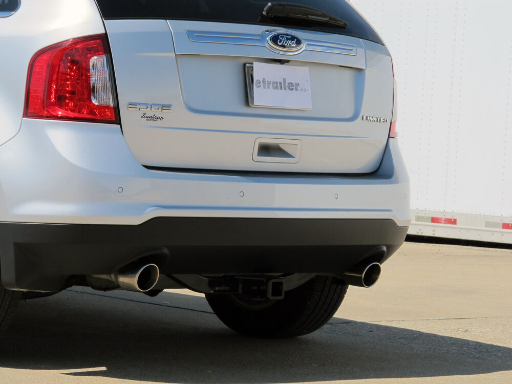

I'm thinking about replacing the black plastic piece along the bottom of the rear bumper because I've got a couple of dings, and have a couple of questions.
It's the black plastic piece above the exhaust pipes, but below the painted bumper part (see pic of similar vehicle here).

I just replaced this myself. It does not need painting. There are a few screws on each side and one in the middle to remove. There is also one rivet on each side as well. I did not see a way to remove them, so i ended up just cutting them off. I replaced them with plastic panel clips found at auto part stores. After u remove the screws and two rivets, just start pulling outward. The rest is just snapped into place
It looks to me that you are right, #9 seems to be it.....as far as the dealership telling you it needs to be painted......when I had my Cougar years ago I was EXTREMELY active on the boards and knew probably more about the car than anyone at the dealership, including the service guys. There was multiple times I'd go in to order a part and they'd give me information that was wrong. I'm assuming who ever you talk to assumes that since its not the same color as your Edge (again, assuming that yours is not black) that they think it is supposed to be the same color as your vehicle.
