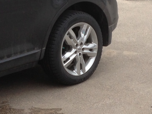

normcloutier Posted May 27, 2013 Report Share Posted May 27, 2013 I have a 13 SEL but had my dealer put the wheels from a limited on my Edge. The tire sticker for the vehicle is for 18". What is the tire pressure for the 20" Pirelli Scorpion tires? Is it still 35 psi? Quote Link to comment Share on other sites More sharing options...
EdgeGermany Posted May 27, 2013 Report Share Posted May 27, 2013 contact pirelli. they will tell you. Quote Link to comment Share on other sites More sharing options...
normcloutier Posted May 27, 2013 Author Report Share Posted May 27, 2013 Thanks but isn't it somewhat dependant on the vehicle though? Can someone with a 12 or 13 limited with OEM tires just have a peek at the tire sticker on the drivers pillar and let me know what's listed there? Quote Link to comment Share on other sites More sharing options...
akirby Posted May 27, 2013 Report Share Posted May 27, 2013 contact pirelli. they will tell you. Only Ford knows the correct pressure. It has nothing to do with the tire mfr - they only know the maximum pressure (which is already on the sidewall). Quote Link to comment Share on other sites More sharing options...
teknowiz Posted May 27, 2013 Report Share Posted May 27, 2013 My 2011 Mkx has 35 PSI on the sticker for the 20" Pirelli Scorpion. Quote Link to comment Share on other sites More sharing options...
