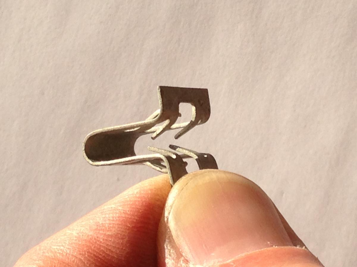

normcloutier Posted July 17, 2013 Report Share Posted July 17, 2013 I can see why some of you are having difficulty removing the clips. The clips have 4 small prongs on the inside that "grab" onto the plastic. If any of the prongs have dug into the plastic, pulling on the clip will only make the prongs dig deeper and the clip nearly impossible to remove. I had a clip that had the prongs dug into the plastic. I had to push the clip on as much as I could and then used a small screwdriver to bend the prong outwards. Clip can then be pulled off. Quote Link to comment Share on other sites More sharing options...
candurin Posted July 17, 2013 Report Share Posted July 17, 2013 If any of the prongs have dug into the plastic, pulling on the clip will only make the prongs dig deeper and the clip nearly impossible to remove. It can also break off part of the plastic tab on the bumper. I had that happen on my passenger side. All I did was move the tab down on the lip of the tab a little bit. No issues. Quote Link to comment Share on other sites More sharing options...
kc300c Posted July 17, 2013 Author Report Share Posted July 17, 2013 If you look closely at my install video, you can see how chewed up my bumper tabs are after installing and uninstalling over 3 dozen times. You all don't need to worry about this happening with just a couple of installs. I am still using the orginal stock clips, so the clips will last forever. If some of the tabs get bent, you really don't have to spend a lot of time trying to get them back in position perfectly. They will still grip hard. Quote Link to comment Share on other sites More sharing options...
