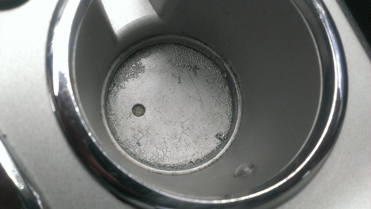

surferd15 Posted April 12, 2013 Report Share Posted April 12, 2013 I had one of those oil Febreeze air fresheners in my car clipped to my vent. It leaked and ate the silver paint on the navigation screen and then my cupholder. I am annoyed because my interior is very clean and now it ruined!!! What paint color is the silver paint on the MKX? Here are some pics of the damage. A little search on the internet and it seems ppl. have had this problem and Febreeze doesn't care that its products ruin interiors of customer cars. Quote Link to comment Share on other sites More sharing options...
JOEHIO Posted April 13, 2013 Report Share Posted April 13, 2013 Best thing to do, is go to a shop that does interior painting/dying. When my wifes MKS was about a week old, I accidentally got black magic marker on the camel colored passenger seat, drivers door, and center console, which was a medium grey colour. Don't ask how I did it, too long to explain, but I was sick as a dog when it happened. I went to the dealer, nothing would get it out. The dealer had a guy come to the dealership, he spray painted (dyed) the passenger seat & door, where the magic marker was, and resprayed the center console too. He knew exactly what colour to use, and that is over 4 1/2 years ago. It was $175 to get the job done, but worth every cent. Quote Link to comment Share on other sites More sharing options...
richy Posted April 13, 2013 Report Share Posted April 13, 2013 Yikes! That is some strong shit! Sorry that happened to you. The painting is your only option. Quote Link to comment Share on other sites More sharing options...
surferd15 Posted April 13, 2013 Author Report Share Posted April 13, 2013 Thanks guys. I found a website with ford/lincoln interior colors and the color is medium satin nickel. Found on another forum guy updated his LS interior to the silver color in mine and used a satin nickel spray paint. I am going to test it on another piece of trim and then pull the piece out on the navigation unit, sand, primer and paint. Now gotta figure out the cup holder since that's is going to be a pain to paint. And for Febreeze well I am not going to purchase their products anymore, but still going to file a complaint. Quote Link to comment Share on other sites More sharing options...

KingMike Posted April 14, 2013 Report Share Posted April 14, 2013 That sucks man...I'm sorry that happened to you. Like what was already said, an interior upholstery shop would be best. They know how to match it and should be able to do whatever you need. I wish you lived in the New York area because I could direct you to a few great places. Quote Link to comment Share on other sites More sharing options...
surferd15 Posted April 15, 2013 Author Report Share Posted April 15, 2013 Thanks guys for the support. I am still waiting for Febreeze to get back to me... For the paint I used this as a reference. Tells you the name of the color which helps with picking paint: http://www.fordparts.com/FileUploads/RichTextboxImages/file/paint.pdf Quote Link to comment Share on other sites More sharing options...
