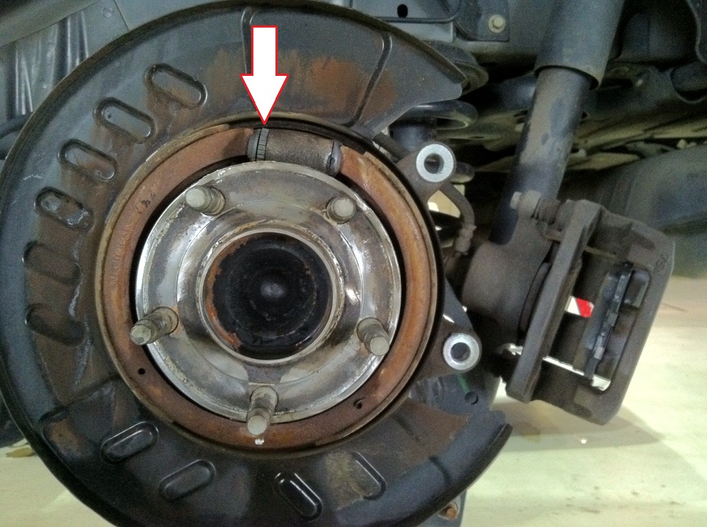

thirdgenlxi Posted April 4, 2013 Report Share Posted April 4, 2013 No problem..... here's a pic of mine (drivers side) since I had the rotors off anyways here today to cut them. The shoes on the Edge look a little different than on some other models, they're just one big "C" ring instead of 2 separate shoes. Pay very close attention to the orientation of the adjuster when you take them out 2 Quote Link to comment Share on other sites More sharing options...

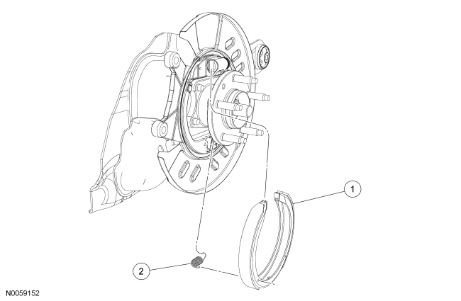

Scottm86 Posted August 3, 2014 Report Share Posted August 3, 2014 (edited) I can't figure out where the wave spring goes and where the coil spring goes. I can see from your picture that the spring is attached to a hole on the bottom right, but I don't know what it attaches to inside the assembly. Can you email me at skot_in_windsor@hotmail.com , I can send some pictures to explain it better. Thanks Scott Edited August 4, 2014 by Scottm86 1 Quote Link to comment Share on other sites More sharing options...
Scottm86 Posted August 4, 2014 Report Share Posted August 4, 2014 One thing I should add is that the ebrake was taken off at a shop so I didn't get a chance how it came apart and didn't get a chance to see where the spring goes, but I do know it attaches to a hole on the bottom right of the brake shoe. Quote Link to comment Share on other sites More sharing options...

EDST777 Posted August 27, 2016 Author Report Share Posted August 27, 2016 (edited) somebody..., after all where it is located? p.s.: post 18 http://www.fordedgeforum.com/topic/12296-brake-shoeemergency-brakereplacement/?do=findComment&comment=155737 ... so, I have found a part of the answer here : http://www.justanswer.com/ford/4okmk-ford-edge-limited-remove-rear-rotors-08.html Expert: Tim Mohr replied 5 years ago. Hi, my name is XXXXX XXXXX is nothing holding the rear rotors on, after the caliper has been removed, now inside the rotors on the back is the emergency brake shoes, and the rotor can hang up on these, that is what the rubber plug is for, remove the plug and rotate the rotor so you can see the star wheel on the ebrake adjuster, then back off the adjuster with a screwdriver, and the rotors will come off,Tim ... where have in detail explained why a wheel with a star , how I understand to hold a back rotor on the place, but I still don't know whether these can only regulate force of pressing of the emergency brake to a rotor or it is necessary to regulate a cable tension?. also I am interested in a possibility of adjustment by a wheel with a star, it turns out that when an opportunity to twist a wheel with a star ends, I won't be able to regulate more force of a clip of the emergency brake to a rotor and it is necessary to change a block of the emergency brake? Edited August 27, 2016 by EDST777 1 Quote Link to comment Share on other sites More sharing options...
EDST777 Posted August 28, 2016 Author Report Share Posted August 28, 2016 (edited) Thanks, I after all have found the first place (Parking Brake Control) of adjustment, here it looks absolutely clear: Edited August 28, 2016 by EDST777 1 Quote Link to comment Share on other sites More sharing options...
