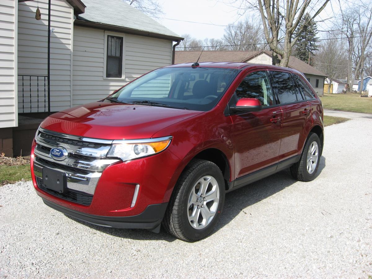

Larry Posted March 28, 2013 Author Report Share Posted March 28, 2013 The picture that I posted was before I installed window ventvisors and front slash guards. May remove the slash guards as I don't see where the help that much. Larry Northern,In Quote Link to comment Share on other sites More sharing options...
