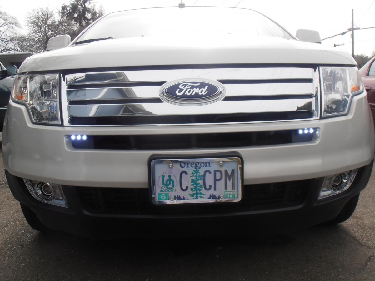

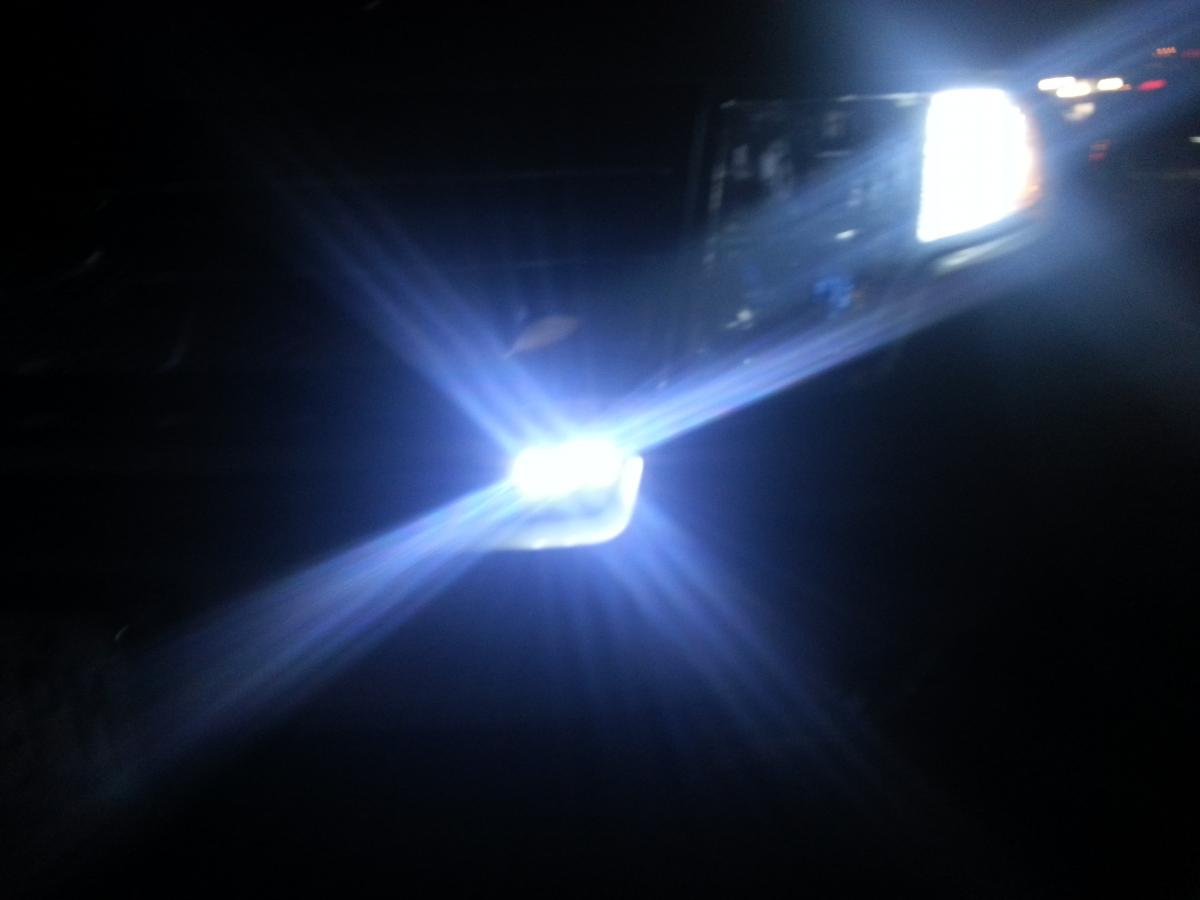

Adarcla3 Posted March 25, 2013 Report Share Posted March 25, 2013 Added these to my 2007 Ford Edge. Close up and off During the day on At night on Quote Link to comment Share on other sites More sharing options...

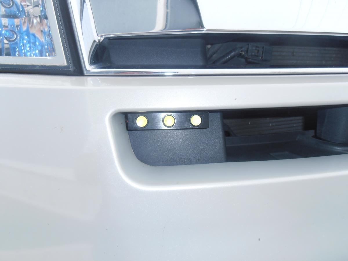

WWWPerfA_ZN0W Posted March 25, 2013 Report Share Posted March 25, 2013 Nice use of that "dead" space. How did you wire it up? Quote Link to comment Share on other sites More sharing options...
Adarcla3 Posted March 25, 2013 Author Report Share Posted March 25, 2013 You can see that I had to drill a small hole in the 'dead' space to run the wire. I then ran it to the fuse box under the hood and tapped an circuit that is only 12v with the key on. 2 Amp fuse in line just to be safe. 2 Quote Link to comment Share on other sites More sharing options...
