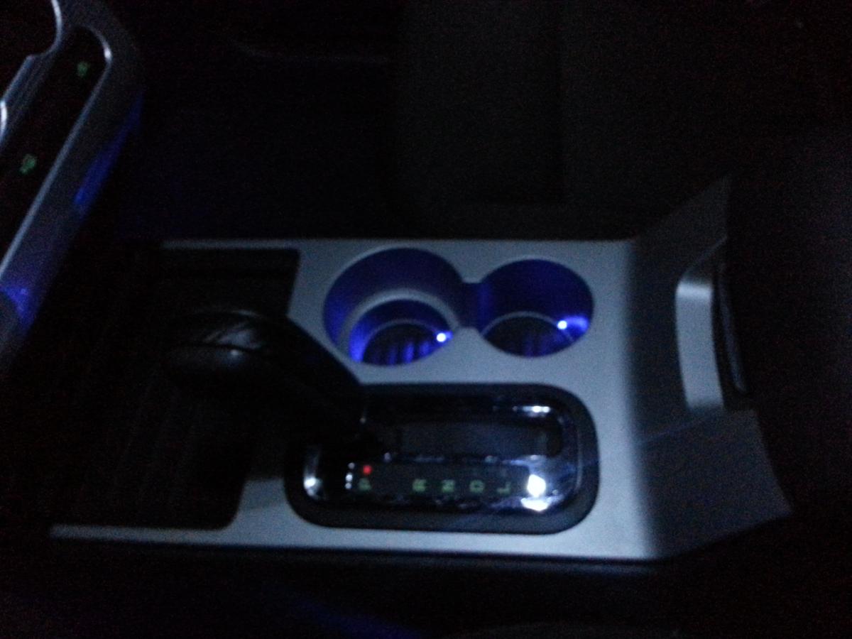

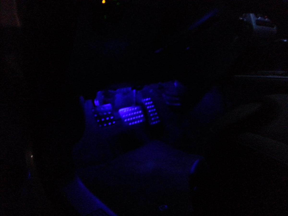

Adarcla3 Posted March 19, 2013 Report Share Posted March 19, 2013 LED's added and Cup Holder lights (Total cost $20 and two hours of my time) Quote Link to comment Share on other sites More sharing options...
WWWPerfA_ZN0W Posted March 19, 2013 Report Share Posted March 19, 2013 Very nice! Did you wire the cupholder lights to the console power outlet, PnP or hardwired? Quote Link to comment Share on other sites More sharing options...
Adarcla3 Posted March 19, 2013 Author Report Share Posted March 19, 2013 Hardwired to an ignition hot, on when the car is on, open fuse in the fuse panel. I also have an over-ride switch mounted next to the hood release that I can turn them off as needed. http://www.tmart.com/24-LED-Strip-Car-Lights-Flexible-Grill-Light-Blue-12V_p84769.html ***I love tmart.com I have used them to convert both cars to all LED inside and out for a lot less than retail*** These are the lights I used under the dash, and under the rear seat. For the cup holders, I used a Blue LED (12v with 100ohm resister wired in series) I got those from FRY's electronics for $3.99. 2 Quote Link to comment Share on other sites More sharing options...
