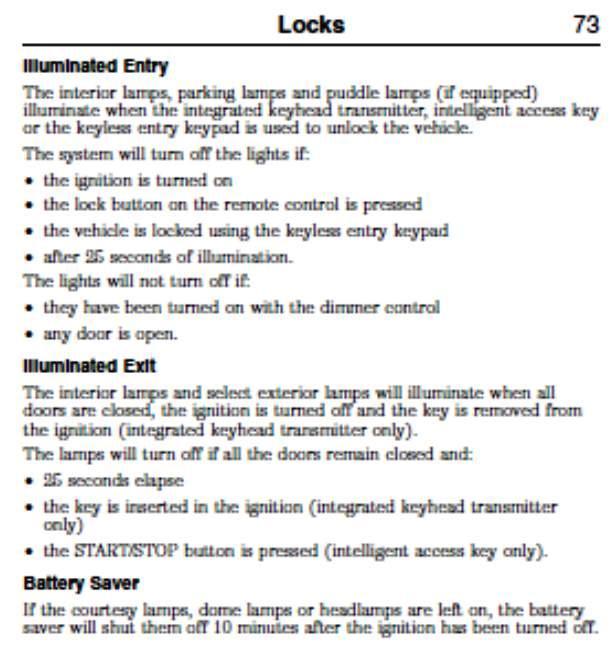

Haz Posted March 4, 2013 Report Share Posted March 4, 2013 Attached image is text from 2013 Edge Owner's Guide... Good luck! Quote Link to comment Share on other sites More sharing options...
oskar27 Posted March 4, 2013 Author Report Share Posted March 4, 2013 Thanks Haz, I have the same page so it must be something wrong with my settings Quote Link to comment Share on other sites More sharing options...
Haz Posted March 4, 2013 Report Share Posted March 4, 2013 Oskar: The 10-minute interval you describe could be the Battery Saver function shutting off the lights after the failure of the 25-second timer function to do it. Per Dingo's observation, the lights should turn off if you lock the doors with the Remote or the Keyless Entry Keypad on the door. Good luck! Quote Link to comment Share on other sites More sharing options...
