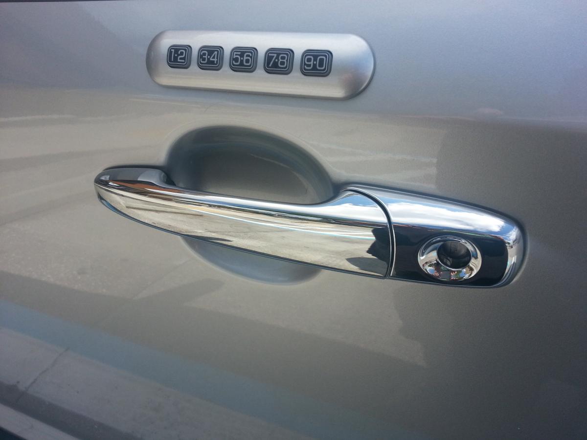

Symbasys Posted March 2, 2013 Report Share Posted March 2, 2013 (edited) Some lovely person in the Target parking lot decided to slam their door open into my driver door handle, taking off a good chunk of paint. I ordered a set of the Ford OEM replacement chrome door handles. I was amazed at how easy it was to install them! I had all four replaced in about 10 minutes, and that included having to go back in and find the correct size Torx bit. Installation goes like this: Pop off the black plastic plug on the inside edge of the door next to the door handle. Insert a Torx T-25 bit into the hole and loosen the screw (the instructions said to use a T-20, but for some reason I had to use the next size up.) Pull on the door handle and pop off the end trim bezel. Pull the door handle out and toward the rear of the vehicle until it pops off, then pull straight out to remove it from the door. Install is the reverse of removal. So simple! And it cost way less than having to have the door handle repainted. Edited March 2, 2013 by Symbasys 1 Quote Link to comment Share on other sites More sharing options...
WWWPerfA_ZN0W Posted March 3, 2013 Report Share Posted March 3, 2013 Nice match to the other chrome trim! Quote Link to comment Share on other sites More sharing options...

Rockballer Posted May 7, 2013 Report Share Posted May 7, 2013 Nice it looks good. I was thinking of ordering them up. I didn't want the cheap plastic covers that went over top of the stock ones. What ones did you end up ordering up? Quote Link to comment Share on other sites More sharing options...
Symbasys Posted May 8, 2013 Author Report Share Posted May 8, 2013 The set I bought is part number 9T4Z-7822404-AA (shows fitment for 2009-2010 models) and runs around $65 for the set of four handles with bezels... not bad. I bought mine on eBay from a seller called "dealerconsignments" and had a very positive experience. I had tried the chrome covers before I bought these. Don't waste your money. They fit poorly and look cheap. I sent them back for a refund. OEM is definitely the way to go. Quote Link to comment Share on other sites More sharing options...
