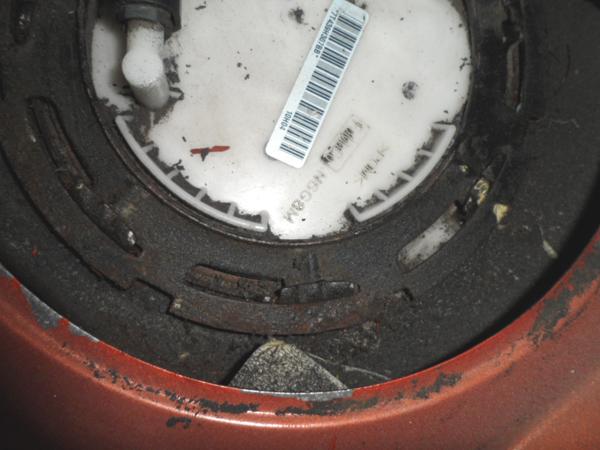

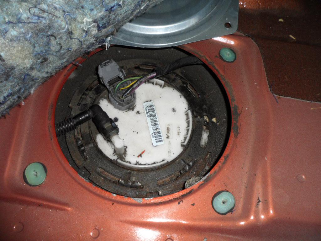

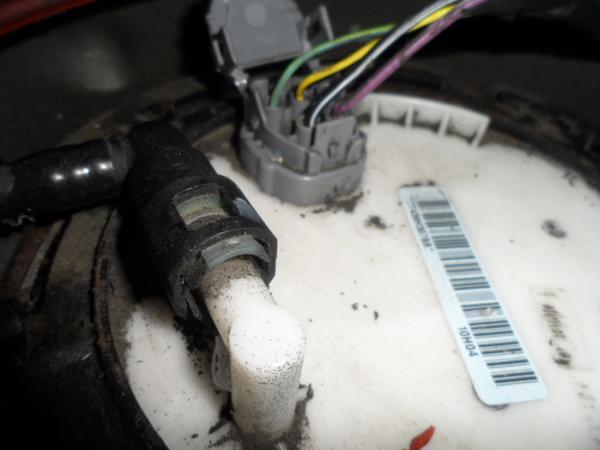

2007Edge Posted February 24, 2013 Report Share Posted February 24, 2013 My fuel gauge stack on full, want to replace fuel sending unit, anyone can give me tips how to remove wire harness, fuel line and metal ring around . found fuel sending unit 33$+shipping rock auto dot com thanks Quote Link to comment Share on other sites More sharing options...
ls973800 Posted February 24, 2013 Report Share Posted February 24, 2013 (edited) For the metal ring, I've just always used a piece of brass round stock. Tapping the ring on those outside notches will get it to free up and spin off. I prefer the brass just because there is no chance of producing a spark which can occur with metal on metal. Edited February 26, 2013 by ls973800 Quote Link to comment Share on other sites More sharing options...

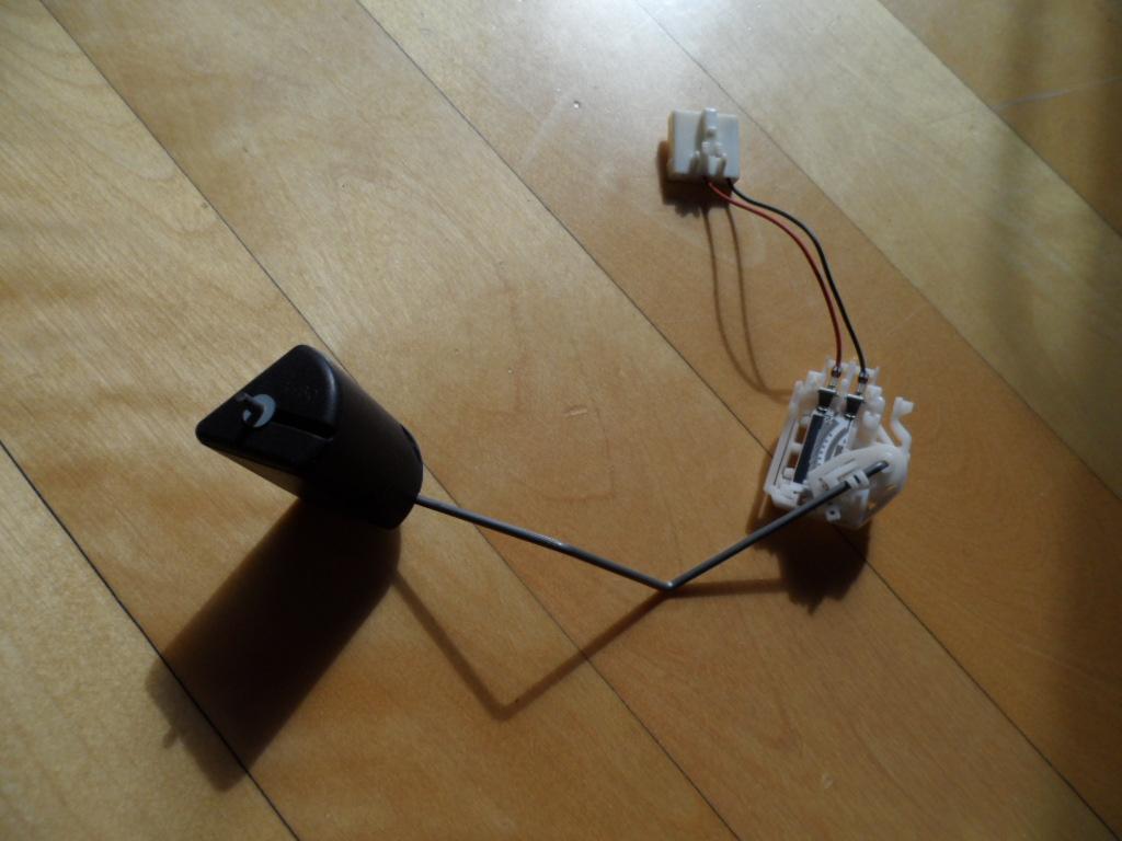

darkriff Posted March 1, 2013 Report Share Posted March 1, 2013 i think that unit you ordered wont work...those edge fuel sending unit looks different Also the edge uses two sensors for measuring fuel level since the fuel tank is kind of divided in two, at least in my 2011 is that way Quote Link to comment Share on other sites More sharing options...
2007Edge Posted March 10, 2013 Author Report Share Posted March 10, 2013 (edited) you are right, the picture is different than the actual unit.The part that I ordered fits in ford edge FWD 2007 and it took me maybe 1 hour to replace the unit, starting with removing fuel pump relay, starting the engine 2-3 times to release the fuel pressure in the system, the procedure to replace fuel sending unit was easy part, it took me 5-10 minutes, put back seats and ready to go.If someone has to replace the fuel pump it is the same procedure as this one Edited March 10, 2013 by 2007Edge Quote Link to comment Share on other sites More sharing options...
2007Edge Posted March 16, 2013 Author Report Share Posted March 16, 2013 Well, it worked for 2 weeks and get back to full again, it is not fuel sending unit I guess, I disconnected wires from the fuel pump and sending unit ( picture 2 on top of the tread ) and still shows full. I think that some wires have bad connections but where to check this? thanks Quote Link to comment Share on other sites More sharing options...
