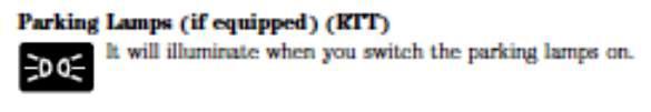

Haz Posted March 1, 2013 Report Share Posted March 1, 2013 (edited) The 2013 Edge Owner's Guide 3rd Edition (an October 2012 revision) on page 106 says the icon is an RTT that "will illuminate when you turn the parking lights on" and on page 103 explains "Some warning indicators are reconfigurable telltales (RTT). These indicators appear in the information display and function the same as a warning light, but do not display on startup." The Owner's Guide 2nd Edition does not include the icon among RTTs that it explains. Omar302 may be correct about this being an Information Display update that the dealer can activate via new software or revised programming. The icon would certainly provide a welcome confirmation of the automatic turn-on of headlights during daytime windshield wiper usage. Good luck! Edited March 1, 2013 by Haz Quote Link to comment Share on other sites More sharing options...

Haz Posted March 2, 2013 Report Share Posted March 2, 2013 Attached... Quote Link to comment Share on other sites More sharing options...
OnTheFence Posted March 3, 2013 Report Share Posted March 3, 2013 (edited) The 2013 Edge Owner's Guide 3rd Edition (an October 2012 revision) on page 106 says the icon is an RTT that "will illuminate when you turn the parking lights on" and on page 103 explains "Some warning indicators are reconfigurable telltales (RTT). These indicators appear in the information display and function the same as a warning light, but do not display on startup." The Owner's Guide 2nd Edition does not include the icon among RTTs that it explains. Omar302 may be correct about this being an Information Display update that the dealer can activate via new software or revised programming. The icon would certainly provide a welcome confirmation of the automatic turn-on of headlights during daytime windshield wiper usage. Good luck! Nice job figuring it out. Looks like the "3rd gen" edges have it. Seems like the newer models should also have the light then. Not a big deal either way. Edited March 3, 2013 by OnTheFence Quote Link to comment Share on other sites More sharing options...
