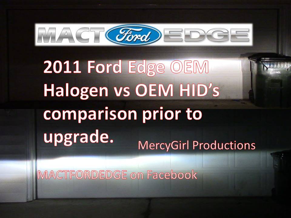

macbwt Posted March 31, 2016 Report Share Posted March 31, 2016 Getting ready for my install tomorrow. This is how the two Edges compare now. Top photo is Halogen and the bottom is Ford OEM HID. Will the Daytime Brightlites be better than the Ford OEM HID? Guess I will find out. Quote Link to comment Share on other sites More sharing options...
candurin Posted April 1, 2016 Report Share Posted April 1, 2016 Mac, "better" is rather subjective and you will get many varying levels of agreement/disagreement. Batter than halogen? Significantly! Better than OEM? Probably not, but, it will at least be close enough to be considered "just as good as", if not "pretty damn close too it" 1 Quote Link to comment Share on other sites More sharing options...
rwf78155 Posted April 1, 2016 Report Share Posted April 1, 2016 Mac..... The daytimebrightlites are amazing......Only problem I have is people flashing me to dim my headlights when they are already on dim Quote Link to comment Share on other sites More sharing options...
