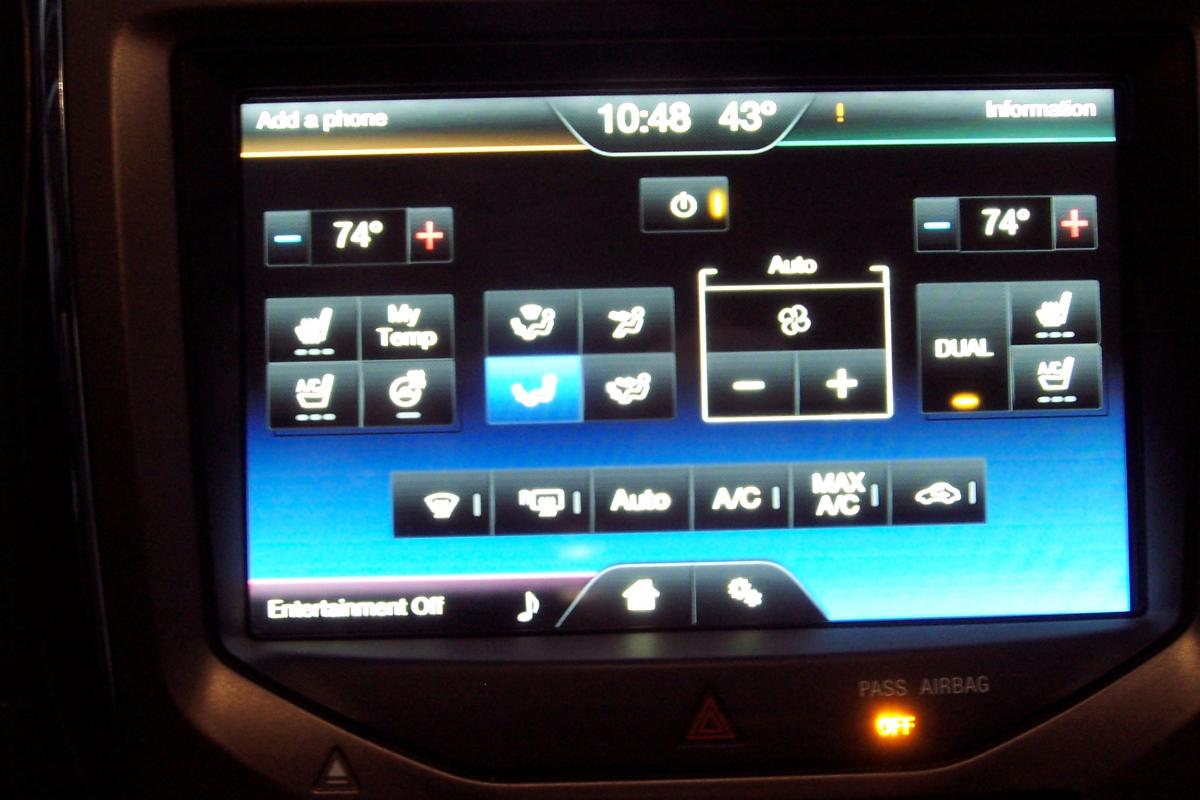

Haz Posted February 17, 2013 Report Share Posted February 17, 2013 Kate13: From a cold start in below-freezing temperatures, my full AUTO Climate setting will have the fan begin blowing at full speed to heat the interior after I have driven about one mile. Per the attached photo, it is possible to set the air distribution path using the TOUCH screen while leaving the fan speed automatically determined by the differential between the desired temperature and the actual temperature. Many users here are frustrated that our non-AUTO Climate system settings do not endure the next time we start-up our vehicles, something we hope Ford might address in the next SYNC/TOUCH software update. Good luck! Quote Link to comment Share on other sites More sharing options...
