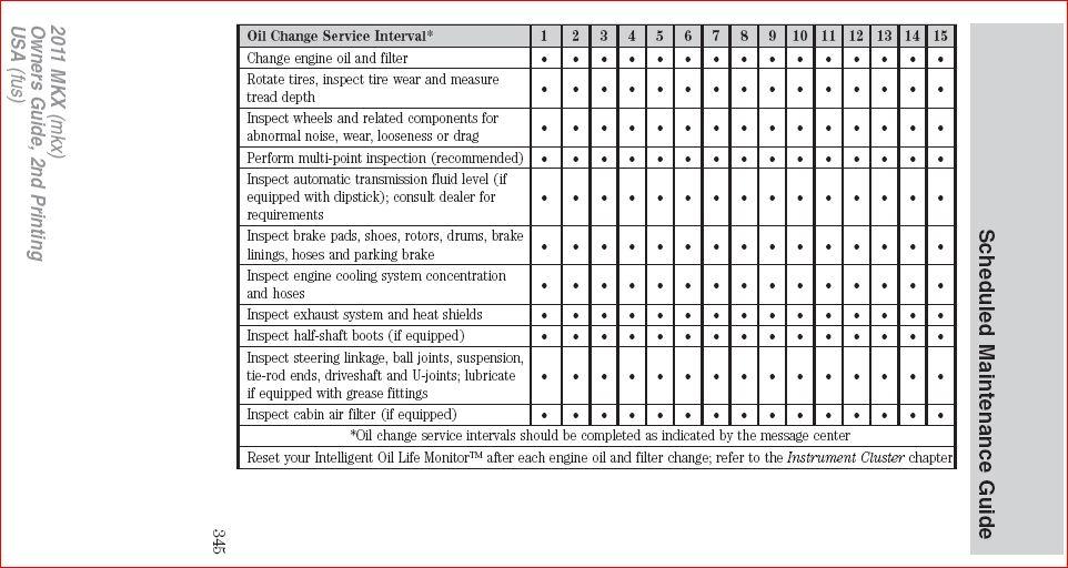

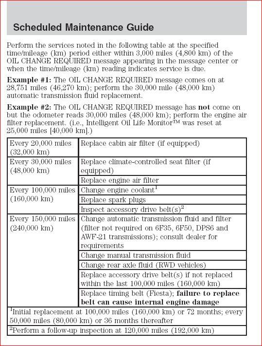

Cellbine Posted January 30, 2013 Report Share Posted January 30, 2013 **It's important to note that what I have written below is specifically for 3.5L '11 LImited, BUT is what you should look for in your manual. Page references may vary** I have been thinking about this recently too. In reading up on the manual, it states (for my '11 3.5L, not an EcoBoost), "You should perform the engine oil change as indicated by the message center...Your oil change service interval can be up to one year or 10,000 miles (16,000km)...If your message center is prematurely reset or becomes inoperative, you should perform the oil change interval at six months or 5,000 miles (8,000 km) from your last oil change." (pg. 377 Scheduled Maintenance) It is also noted in the manual, pg. 379, that you should perform services noted on your scheduled maintenance table within 3,000 miles (4,800 km) of the OIL CHANGE REQUIRED message appearing on your message center or when your milage indicates service is due. I hope this helps you find an answer. Let us know what you find out :D Quote Link to comment Share on other sites More sharing options...

ls973800 Posted January 30, 2013 Report Share Posted January 30, 2013 It is also noted in the manual, pg. 379, that you should perform services noted on your scheduled maintenance table within 3,000 miles (4,800 km) of the OIL CHANGE REQUIRED message appearing on your message center Wow, that statement in the owner's manual can be confusing. When I first read it, it sounded like you could wait up to 3000 miles before really having to do an oil change. After reading it several more times, I see what they are saying. You should perform the other services (check brakes, check exhaust, inspect brake fluid, etc) within the 3000 miles of the light coming on. You defiantly don't want to wait any longer to do the oil change when the light comes on and reaches 0. Quote Link to comment Share on other sites More sharing options...

omar302 Posted January 31, 2013 Report Share Posted January 31, 2013 The oil life indicator is like a calculator that takes milage, time & engine operating conditions into account to calculate oil life. The system does NOT actually measure the oil life by a sensor. For those who would like to go for a 5000 miles (or six months) intervals, simply adjust the Oil life to 50% after an oil change. As for the other services to be performed, what I understand, you have to do them with any oil change interval that comes within 3000 miles, but if you reach the milage specified for any service, but you do not have any oil change requirement within 3000 miles, then you should perform that service without waiting for an oil change. Quote Link to comment Share on other sites More sharing options...
