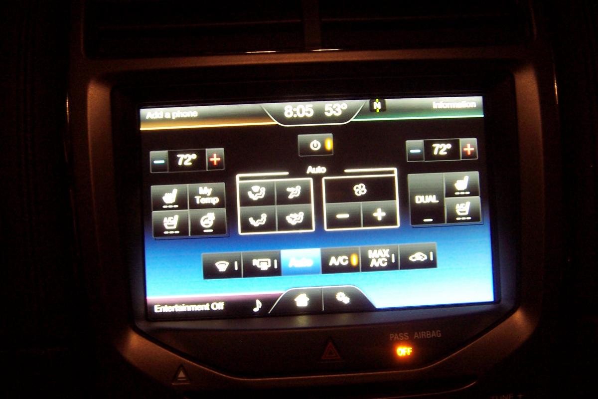

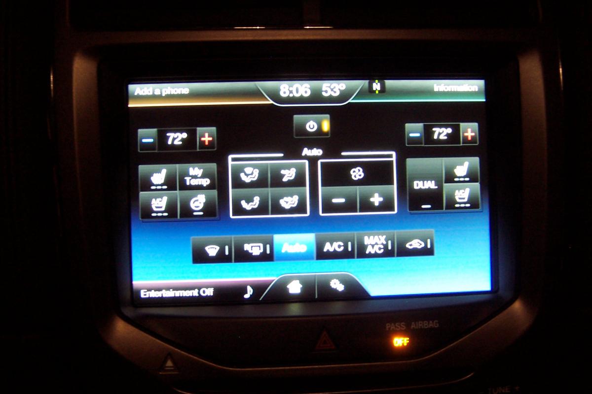

Haz Posted February 4, 2013 Report Share Posted February 4, 2013 (edited) jimmkx2k11: I understand your '11 MKX is running SYNC update V3.5.1, the same as my '12 MKX. I have my Climate settings just as you describe. Several days ago, with the engine running and Climate on Full AUTO with center stack switch pad lit, I used the MyLincoln TOUCH screen to set the air distribution path to Floor, which caused the Auto descriptor to appear only above plus-minus fan speed on the screen and the AUTO control light on the center stack to be extinguished, consistent with the photos I previously posted. Earlier today when I drove my MKX -- and just now after reading your post, I verified -- that climate setting is sticking/enduring and does not require any re-setting in my MKX after the vehicle is restarted. I cannot say if there is a difference in the endurance of a Climate setting adjustment made with the engine running, versus the same adjustment made with the engine not running & MyLincoln TOUCH activated using the Entertainment power button beneath the Volume slider control. But, I made all my Climate adjustments with the engine running and the Climate settings stick/endure whenever I restart my MKX. Good luck! Edited February 4, 2013 by Haz Quote Link to comment Share on other sites More sharing options...
