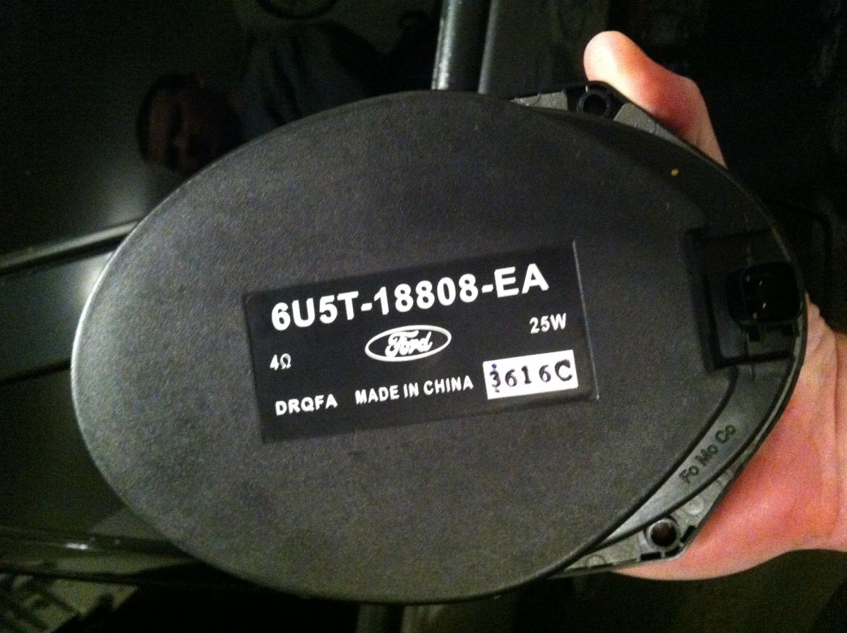

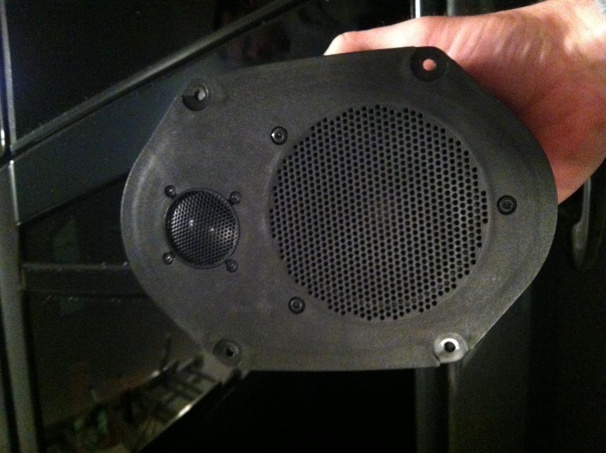

carbonedge+ Posted January 18, 2013 Report Share Posted January 18, 2013 I'll post a pic of The OEMs shortly and that should clear up any confusion. Quote Link to comment Share on other sites More sharing options...
carbonedge+ Posted January 18, 2013 Report Share Posted January 18, 2013 It's more of a sealed plate speaker with a 4" mid and 1" tweeter; 4 ohms and rated at 25 watts 1 Quote Link to comment Share on other sites More sharing options...
Kitulu Posted January 18, 2013 Author Report Share Posted January 18, 2013 Thanks! Looks like it is not a component system per se, and it would be less work to mount a 2 or 3 way speaker Quote Link to comment Share on other sites More sharing options...
