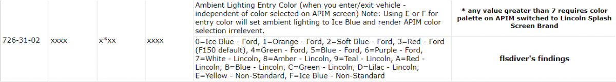

tkw Posted September 21, 2020 Report Share Posted September 21, 2020 Sorry to dig up an old thread. This one kind of touches on 2 things I was trying to learn about. The first thing is with our 2013 SEL, now that my daughter is driving it, whenever she connects her iphone it goes into the scheduled maintenance reboot thing. I've only noticed this happen a few times over the years for me, but I use an android. I noticed a few mentions in this thread about Ford blaming issues on the phone? Second thing is about our 2019 ambient lighting. I was just wondering if there is any way to change the color for the courtesy entry from the default light blue? It seems the color change is only for when the car is running? Quote Link to comment Share on other sites More sharing options...
omar302 Posted September 21, 2020 Report Share Posted September 21, 2020 1 hour ago, tkw said: Sorry to dig up an old thread. This one kind of touches on 2 things I was trying to learn about. The first thing is with our 2013 SEL, now that my daughter is driving it, whenever she connects her iphone it goes into the scheduled maintenance reboot thing. I've only noticed this happen a few times over the years for me, but I use an android. I noticed a few mentions in this thread about Ford blaming issues on the phone? Second thing is about our 2019 ambient lighting. I was just wondering if there is any way to change the color for the courtesy entry from the default light blue? It seems the color change is only for when the car is running? Can't answer the first part. But for ambient lighting default color, it is not a user changeable color, but it can be changed using ForScan. Quote Link to comment Share on other sites More sharing options...
tkw Posted September 26, 2020 Report Share Posted September 26, 2020 Thanks Omar. I know what Forscan is, I am not sure that is something I would want to mess with. Do you know if this is something that a dealership could or would change with their equipment? Quote Link to comment Share on other sites More sharing options...
omar302 Posted September 27, 2020 Report Share Posted September 27, 2020 10 hours ago, tkw said: Thanks Omar. I know what Forscan is, I am not sure that is something I would want to mess with. Do you know if this is something that a dealership could or would change with their equipment? A tech at a dealership might have the capabilities to do it, but it is highly unlikely that you'll find one who would because it is not a standard procedure. Quote Link to comment Share on other sites More sharing options...
