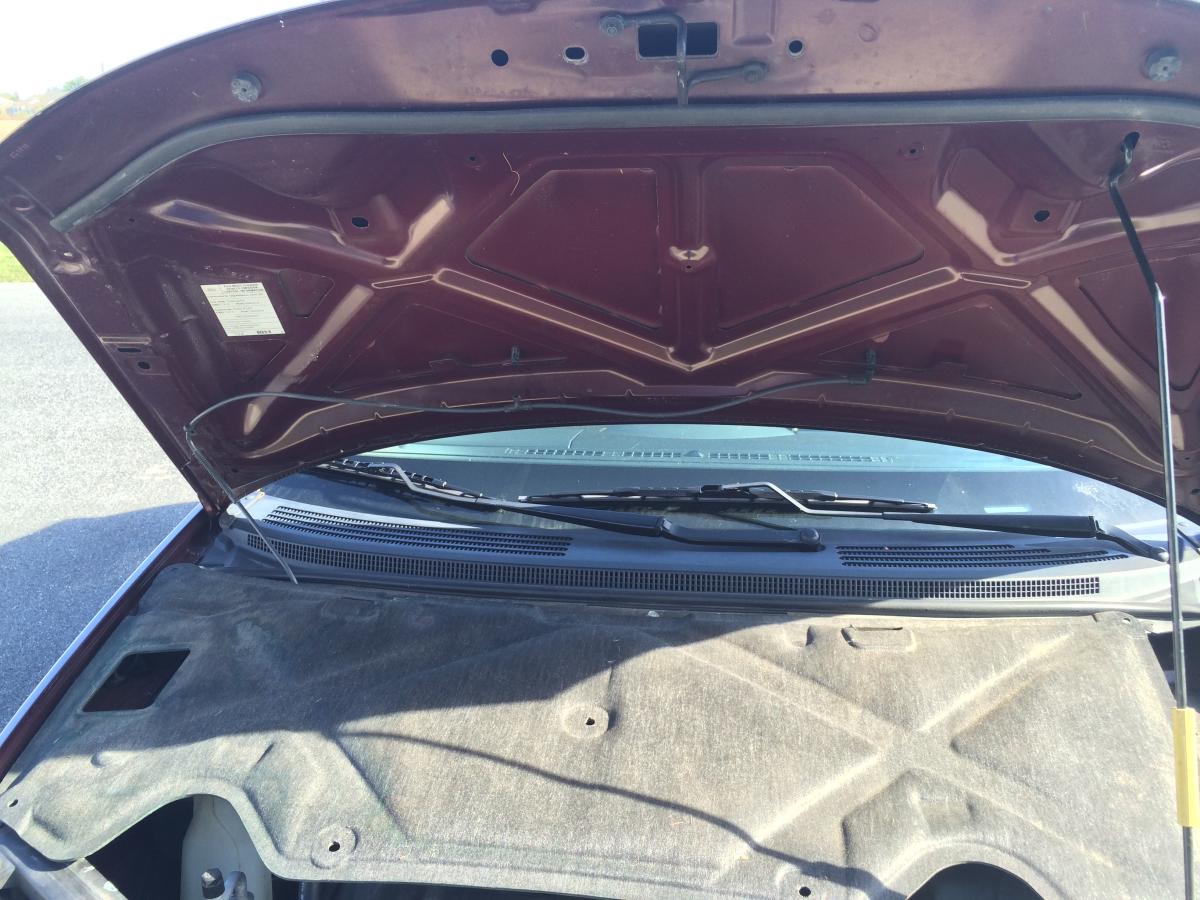

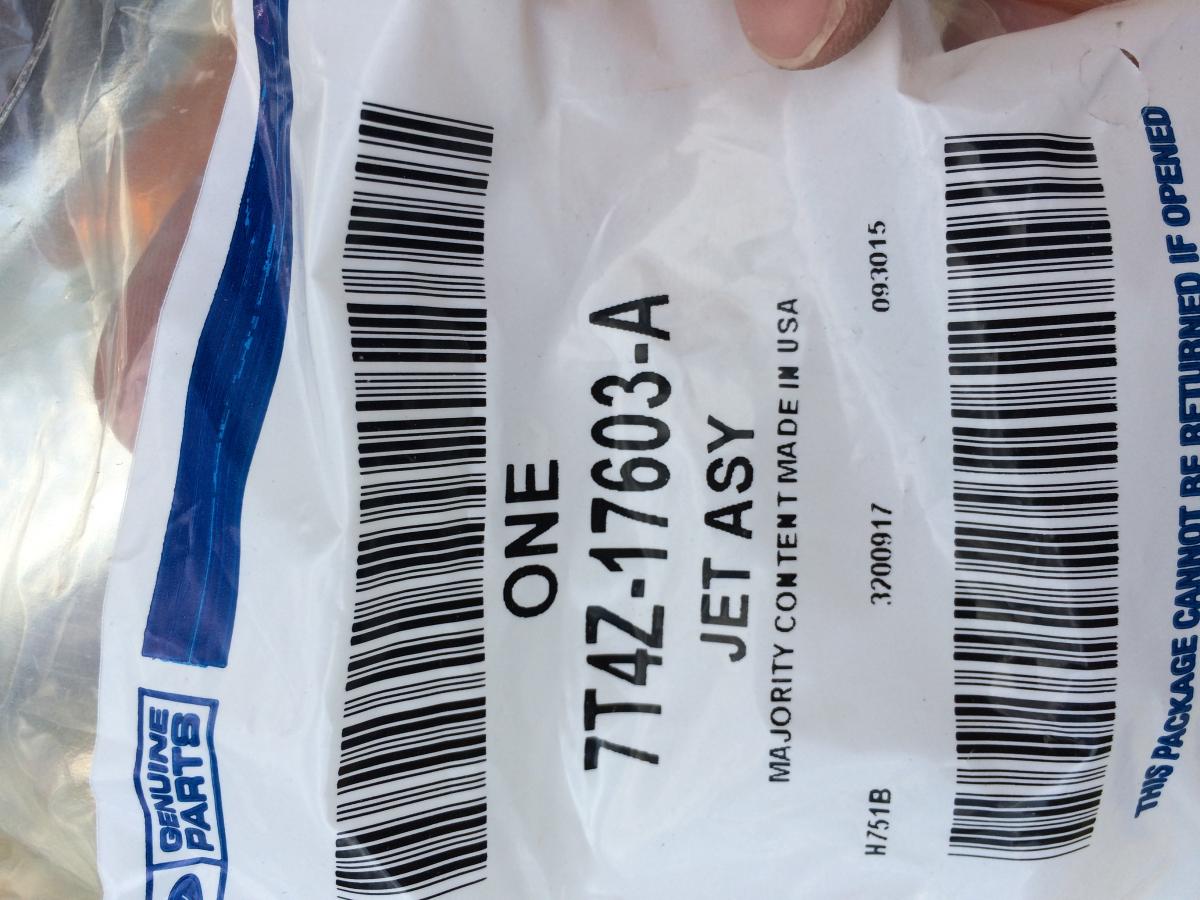

dbomb343 Posted January 9, 2018 Report Share Posted January 9, 2018 (edited) Bumping this thread with some old pictures I had saved for my 2010 Edge, in case they may be of use to anyone in the future. I've replaced the driver side nozzle twice and the passenger side once in the last two years. I recommend the original Ford part as the cheaper knockoffs don't have as good of a spray pattern. I was surprised to find both the off-brand and Ford versions on Amazon now. Use anything broad and flat to remove the plastic attachments for heat shield on the hood (they'll snap back in at the end) to uncover the hose. Check the rubber hose for any damage and use needle nose pliers or something to gently remove any broken pieces of the old nozzle. Edited January 9, 2018 by dbomb343 1 Quote Link to comment Share on other sites More sharing options...
macbwt Posted January 13, 2018 Report Share Posted January 13, 2018 sort of like this. 2 Quote Link to comment Share on other sites More sharing options...
