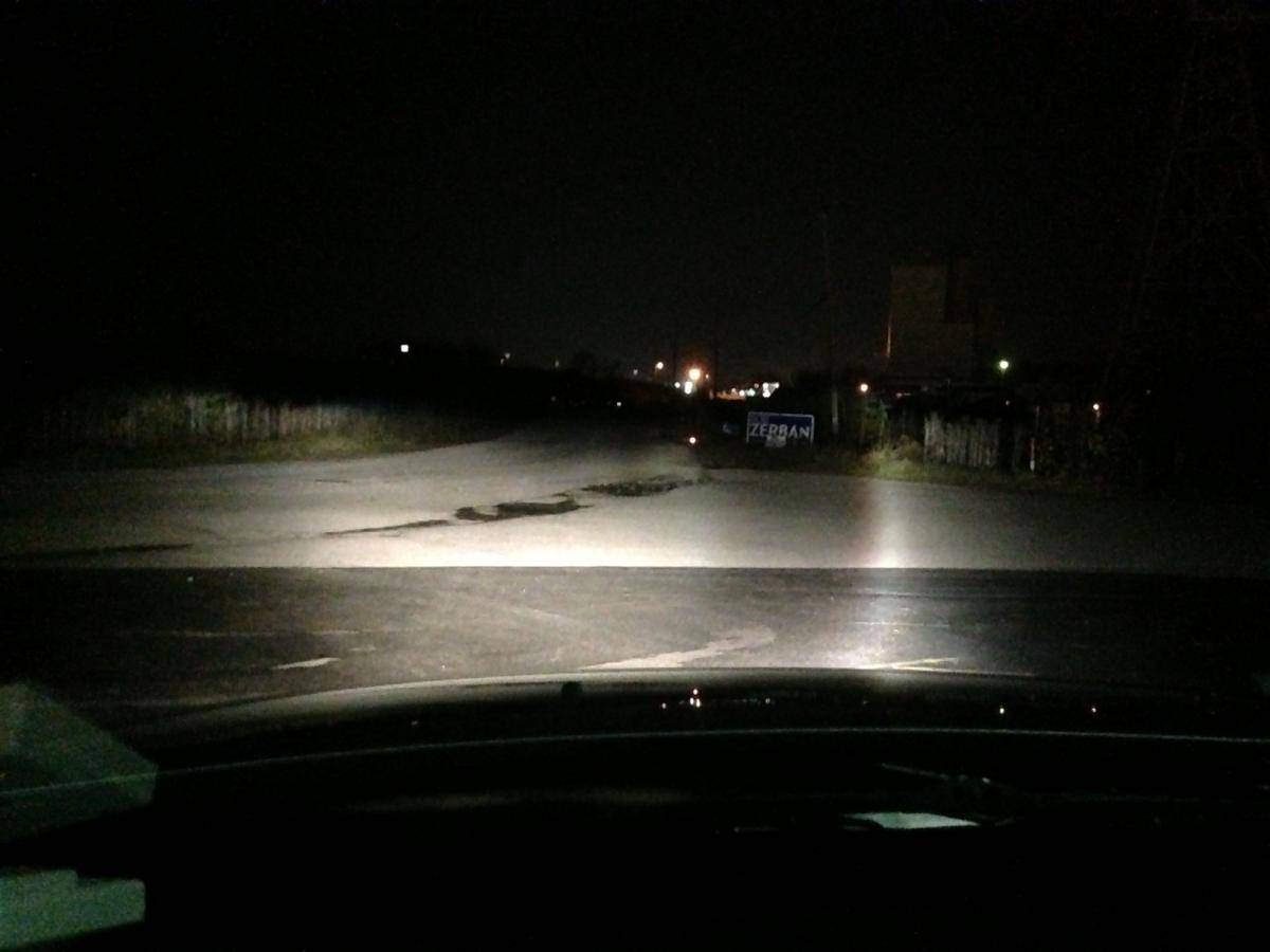

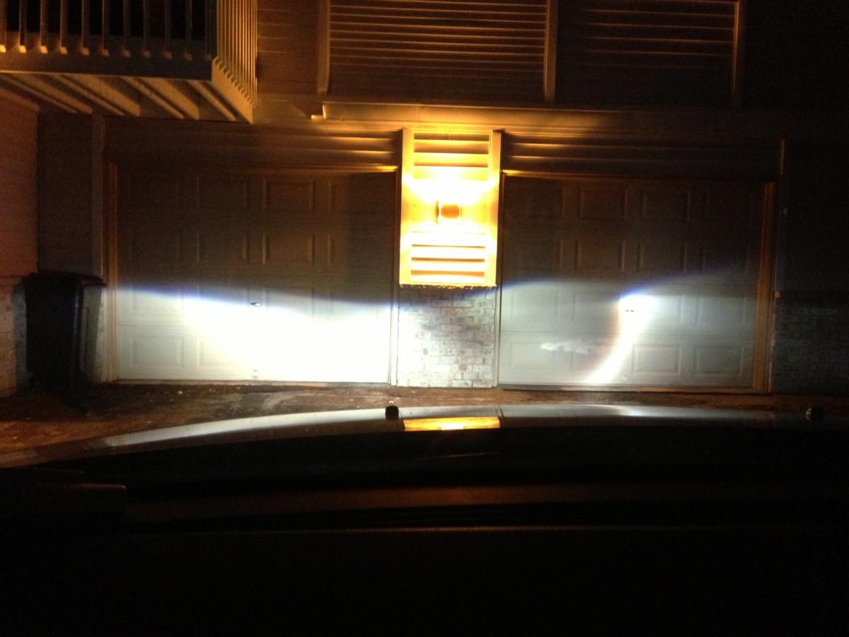

RobbN Posted October 25, 2012 Report Share Posted October 25, 2012 I have been an avid reader of this forum for many weeks now - Thanks to everyone who contributes. Based on reading several recommendations I purchased the 35w DDM tuning HIDS for my '11 Edge SEL. Had them installed tonight, and I swear I could see better with the OEM's. The installer said it was projector beam, and that no aiming was necessary.... but Something is off, I feel as if I am lighting up everything aside from the area in front of me. Please help, as now I feel more unsafe on the roads - I can see the sides of the roads well... and the high beams are HIGH ...but in front of me, not great. Any suggestions ??? Here are a few pics I snapped at around 30 feet. Thanks for ANY help... Quote Link to comment Share on other sites More sharing options...

c_bova Posted October 25, 2012 Report Share Posted October 25, 2012 looks like you need to turn the bulb 180 degrees because you have the return wire on the bottom of it and it is casting a shadow now. Quote Link to comment Share on other sites More sharing options...

WWWPerfA_ZN0W Posted October 25, 2012 Report Share Posted October 25, 2012 I'd say definitely check the headlight unit, with the lights off, with a flashlight. May be something stuck to it or there's a hairline crack or something. Could be inside OR outside the unit. Bulb could have the defect too. If you look at the original pics you posted, the "finger" is highlighted, instead of shadowed in the later pic. Quote Link to comment Share on other sites More sharing options...
c_bova Posted October 25, 2012 Report Share Posted October 25, 2012 (edited) on the bulb itself there is a wire that goes from the tip to the end of the bulb. if when you put the bulb in it it gets positioned so that it is at the bottom it will cast a shadow. there is nothing wrong with your headlight. kc300 had a video on this, let me find it. edit: i put the video at the time where it shows what you have to do Edited October 25, 2012 by c_bova 1 Quote Link to comment Share on other sites More sharing options...

RobbN Posted October 26, 2012 Author Report Share Posted October 26, 2012 Update : Okay I have had this bulb out about 3 times, and printed out the diagram on the video. Heres my thoughts.... I am stuck with the finger. Their are 2 larger tabs at 10 o'clock and 2 o'clock and a smaller tab around the 6pm range. - With that configuration the smaller tab only lines up and can be pushed in when the top tabs are aligned. So I line up all the tabs and the "Bar" that runs on the outside of the bulb is facing straight up, when I turn the bulb in the tabs and I turn as far as they can turn being totally locked in the "bar" is facing the passenger fender of the car, its hot horizontal, when I turn this bulb as far as I can turn it the "Bar" is probably 15 degrees away from being able to be perfectly horizontal. I had tried to turn the bulb, but the way the housing tabs are spaced it seems impossible to make that bar horizontal - and everytime I put the bulb back in.... It gives me the finger. at full power the finger isn't super noticeable and I am am out of ideas on how any other way this bulb can be positioned. I know none of what I am saying makes sense as the driver side light has no finger. - so their must be a way. Also the Passenger side seems a bit less powerful, and I dont know why that is either..... Frustrated.. Quote Link to comment Share on other sites More sharing options...

c_bova Posted October 26, 2012 Report Share Posted October 26, 2012 you'll want that shadow from the bulb wire to either to either be on the top or on the outside so you won't see it. I don't have my HID kit installed right now because they had to send me a new ballast so I'm waiting for that to reinstall. Quote Link to comment Share on other sites More sharing options...
