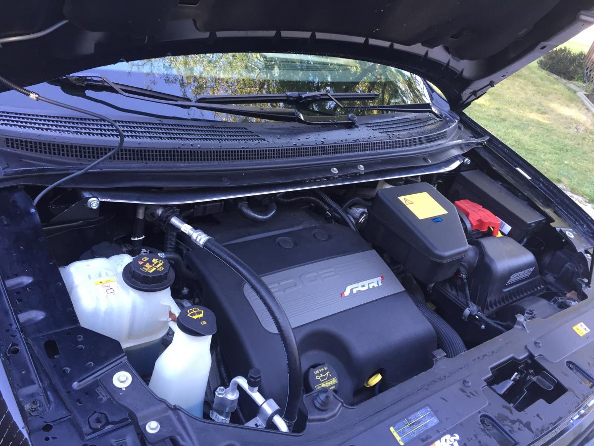

Well it's on. Took about an hour to take wiper cowl off and figure out how to install it. Definitely corners "flatter" with less body roll with my lowering kit I also have on. Love it! Drives like a car. It was $160 shipped from Hong Kong. We have a group buy on the facebk page "ford edge world wide"

Car finally came back from the autobody shop. Now I'm ready to install the strut tower bar....Question how does one remove the windshield wiper cowl? I would be greatly appreciative if someone wouldn't mind posting a diagram and or instructions.
I Know it should be straight forward but I don't want to start pulling stuff apart only to find out i screwed the pooch later.
Thanks in advance.
