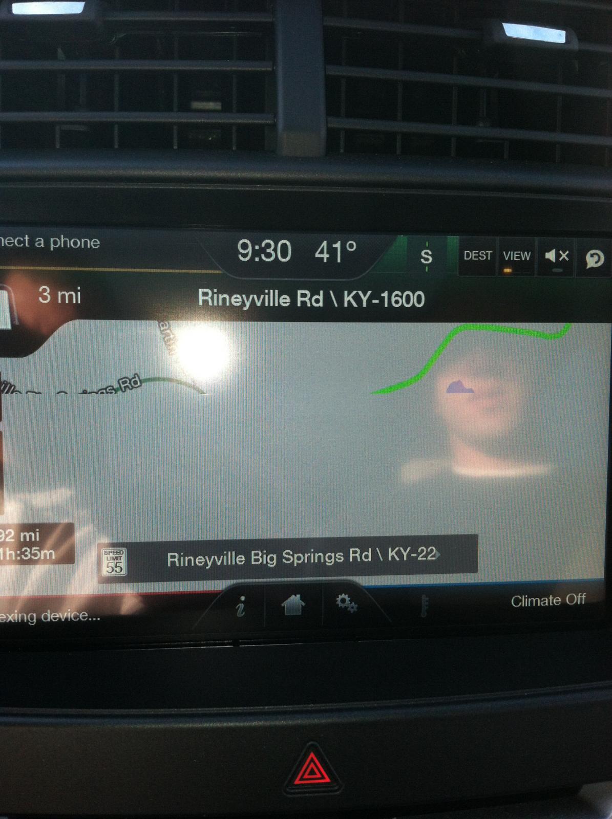

brian617 Posted October 9, 2012 Report Share Posted October 9, 2012 (edited) I went on a short trip this weekend and found that the lower half of the GPS screen was missing!!! Anyone else having this issue? Also I have an ecoboost 55MPH two lane getting 21mpg max.... Edited October 9, 2012 by brian617 1 Quote Link to comment Share on other sites More sharing options...
JOEHIO Posted October 9, 2012 Report Share Posted October 9, 2012 All that I can suggest is to either pull fuse 29, or disconnect the battery for 30 seconds or so, see what happens. Quote Link to comment Share on other sites More sharing options...
brian617 Posted October 9, 2012 Author Report Share Posted October 9, 2012 I have a touch screen waiting for me at the dealership whenever I can find the time to bring it in for try number 4 to repair MFT problems had APIM replaced did not help. Quote Link to comment Share on other sites More sharing options...
normcloutier Posted October 10, 2012 Report Share Posted October 10, 2012 Exact thing happened to me on Saturday. The map would update as I drove around but the red triangle and area around it were missing. I popped my update usb back in and reloaded the file. Only took a few seconds. MFT did a scheduled maintenance right after (not sure if its related or not). After the reboot, the map was fine. Quote Link to comment Share on other sites More sharing options...
