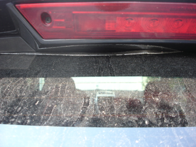

carbonedge+ Posted September 9, 2007 Report Share Posted September 9, 2007 Apparently there is a seal between the spoiler and the back glass on the bottom side of the spoiler. This 'gasket' (looks kind of like a thin foam) has come out is a couple places on my Edge and is hanging just below the spoiler. Would it hurt anything to just remove what has come loose, or should I take this to the dealer to have it fixed? Quote Link to comment Share on other sites More sharing options...

carbonedge+ Posted September 9, 2007 Author Report Share Posted September 9, 2007 Here is a picture in case anyone is curious (please excuse the filthy back glass). I will definitely leave it as is until I get a chance to take it to the dealer. Thanks for the replies. Quote Link to comment Share on other sites More sharing options...
mgarcia13 Posted September 9, 2007 Report Share Posted September 9, 2007 Here is a picture in case anyone is curious (please excuse the filthy back glass). I will definitely leave it as is until I get a chance to take it to the dealer. Thanks for the replies. Hey Carbonedge, I had the same thing happen to with the spoiler and my dealership said they had to get a new spoiler due to the seal being part of the spoiler. They ordered it and got in the next day. Quote Link to comment Share on other sites More sharing options...

kenallwine Posted October 3, 2007 Report Share Posted October 3, 2007 We had the same thing happen on our Edge SE. The dealer had to replace the entire spoiler under warranty. They said that Ford doesn't have just the gasket. Quote Link to comment Share on other sites More sharing options...

igcitng Posted April 7, 2009 Report Share Posted April 7, 2009 I just bought a new 2008 Edge a month ago and am having this issue. The gasket is coming out from under the tail light but not on either side (yet). Has Ford made any advances with this repair? Can they replace just the gasket yet or am I looking at replacing the entire deflector? I do not like thinking about someone trying to match metallic paint. Thanks. Quote Link to comment Share on other sites More sharing options...

igcitng Posted April 14, 2009 Report Share Posted April 14, 2009 Thought I would update this post with some good news. The dealer I purchased from was able to repair the gasket without replacing the spoiler/fin. Took one hour. I was told the replacements were done on the others because if you remove it the clips break and that is it. However, if not repaired it would start making a lot of noise. This particular mechanic figured out how to loosen it, re-seat the gasket and tighten it back up. So if anyone has this problem, find a dealer with someone who has also figured this out. Quote Link to comment Share on other sites More sharing options...
carbonedge+ Posted October 21, 2010 Author Report Share Posted October 21, 2010 Well, my replacement rear spoiler gasket came loose again. I'm outside the warranty now; the gasket wasn't even touching the glass; so it obviously wasn't sealing anything; so I just pulled the unsightly gasket off. So far, so good! Quote Link to comment Share on other sites More sharing options...
