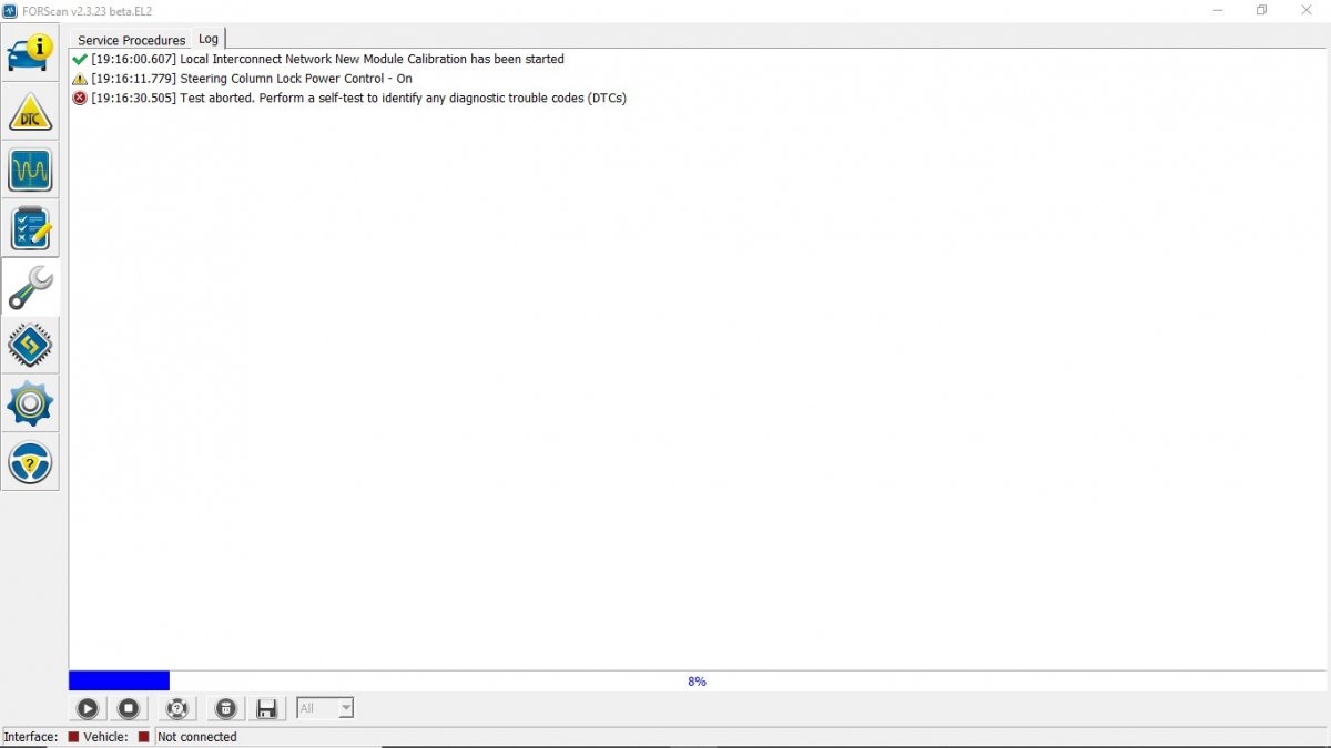

Dmtaurus Posted October 20, 2019 Report Share Posted October 20, 2019 I replaced my 2015 SEL Edge failed factory camera with a Dorman camera. It works well but the guides that swing back and forth are out of sync with the steering wheel. Any solution to this? I did not see a camera calibration reset option in Forscan. Quote Link to comment Share on other sites More sharing options...
omar302 Posted October 20, 2019 Report Share Posted October 20, 2019 57 minutes ago, Dmtaurus said: I replaced my 2015 SEL Edge failed factory camera with a Dorman camera. It works well but the guides that swing back and forth are out of sync with the steering wheel. Any solution to this? I did not see a camera calibration reset option in Forscan. They changed the name of the function in ForScan. It is called “Local Interconnect Network New Module Calibration”. Try that and see if it works. Quote Link to comment Share on other sites More sharing options...
Dmtaurus Posted October 22, 2019 Report Share Posted October 22, 2019 Thanks, I will try looking for that. Quote Link to comment Share on other sites More sharing options...
Dmtaurus Posted October 22, 2019 Report Share Posted October 22, 2019 I found 2 instances of this function; one under the BCM module and one under the Parking Aid module. I tried running the service function under each and both aborted at 8%. I did a screenshot from Forscan but I am not sure how to fix it. Any idea on what to do next? Quote Link to comment Share on other sites More sharing options...
