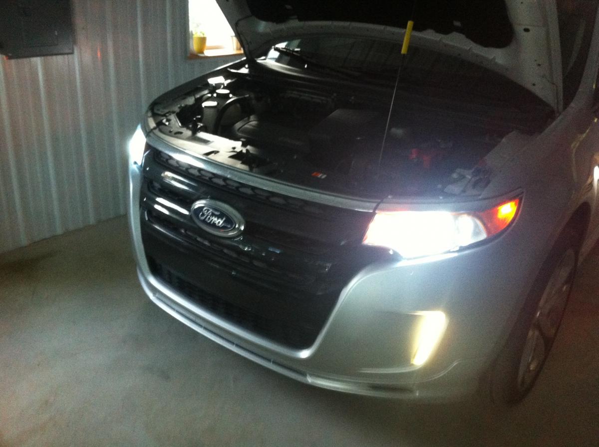

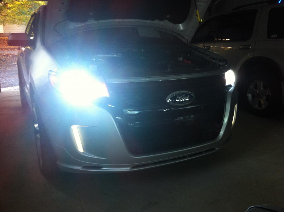

FR200FOCUS Posted October 6, 2012 Report Share Posted October 6, 2012 (edited) Awesome job on this Dan! I just installed my Digital H.I.D. 55W 8000k kit from RetroSolutions.com with your major help from this detailed video. I also fabricated the same mounting brackets for the ballast's from the plumber's strapping and they came out pretty good. I was unsure of the bolts to use in the stock mounting locations so i tried some coarse threaded sheet metal screws and they worked just fine. Everything worked out great and the lights look amazing at night! Just enough blue tint in the beam, but not too much to attract the wrong attention. I hope to get some pics of the finished product up this weekend for you guys. Finally a $40K car with the RIGHT headlight H.I.D. output! Thanks FORD. Edited October 6, 2012 by FR200FOCUS Quote Link to comment Share on other sites More sharing options...
FR200FOCUS Posted October 6, 2012 Report Share Posted October 6, 2012 Daytime pics so far... Quote Link to comment Share on other sites More sharing options...
Edgieguy Posted October 6, 2012 Report Share Posted October 6, 2012 I installed the 55W 5000K DDMTuning kit as well in my 2011 Sport, although my bulb type was 9005. They've never failed and I love them! Be warned though, you do need to adjust or at least check your headlight cutoff height after installing. Quote Link to comment Share on other sites More sharing options...
kc300c Posted October 7, 2012 Report Share Posted October 7, 2012 Congrats FR. The lights look great and glad that no little gremlins popped up like some folks on the forum have had. I agree with Edgie, definitely make surer beam cutoff is good. If you followed my video and used tape on the garage door to trace the beam spread before and after the install and the HID beam cutoff matches, then you're good to go. Quote Link to comment Share on other sites More sharing options...
