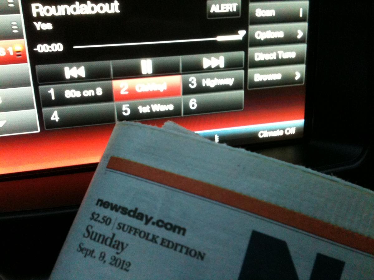

tpm419419 Posted September 9, 2012 Report Share Posted September 9, 2012 Well it has been 2 days since my Edge was at Ford. This update was to correct missing Sirius preset stations. So much for that 1 Quote Link to comment Share on other sites More sharing options...
