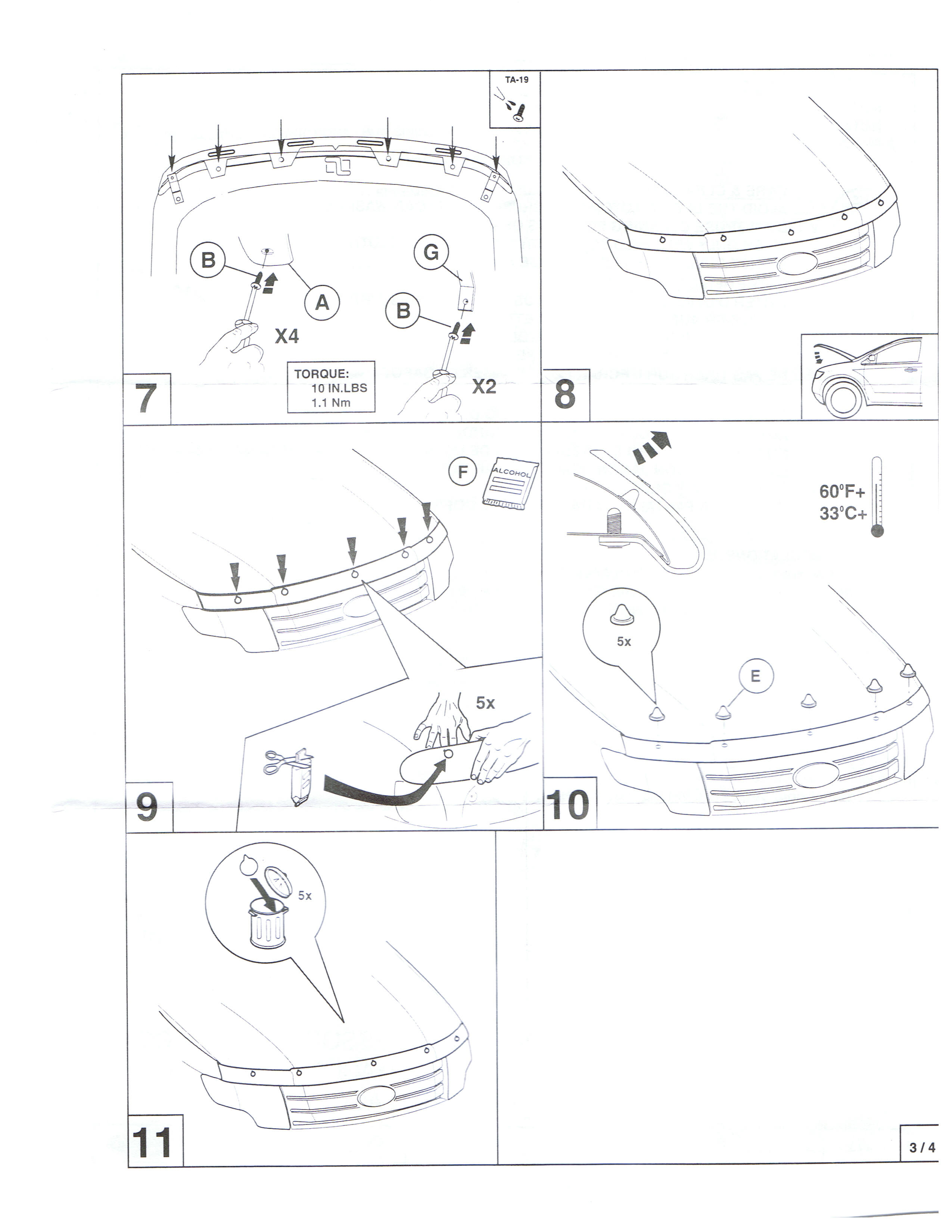

Scott S Posted September 6, 2007 Report Share Posted September 6, 2007 I finally received my Bug Deflector that was ordered with my Edge. It has these little rubber bumpers that appear to attach to the hood to keep the deflector from hitting it. This is the first one I've seen for a vehicle that has these. These will be a bugger to wax around and I doubt they will stay stuck on. Has anyone else added one and what did you do with these bumpers? I was thinking of omitting them or looking for another brand of deflector. I'm not keen on these cheesy stick on things. Quote Link to comment Share on other sites More sharing options...

Scott S Posted September 6, 2007 Author Report Share Posted September 6, 2007 I had one on my 93 Lightning with the rubber bumpers. Without them, the deflector tends to wobble a lot at speed. Frankly, I think at least in my case that these things seem more like a rock attractor then a deflector. It did help with bugs, but in the 10 years that I had the Lightning, I had 5 broken windshields. Many times, I saw small stones coming & could see the wind current steer them lower onto the windshield area. I've always added them to my trucks to keep the leading edge from chipping up from rocks. I can't say they do much for the windscreen though. I too tend to collect rocks regardless of what I'm driving. The PT cruiser collected so many that I now have just left it dinged. I tried a Bra a few years back on my Celica and Probe GT's. Both cars ended up with a disaster under it. I've since ran nothing on the cars but the shields on the trucks/ The little bumpers actually attach to the back of the bug deflector itself, not on the hood. Looking at my instructions they show them attached to the hood - I'm not keen on this. Are yours on the screen itself? I would prefer that but the instructions are very clear on this. I thought maybe the reason was they tapped the hood so often that if they were on the screen they would mark the paint so they figured a bit of glue was better - who knows! See diagram below for the details. Quote Link to comment Share on other sites More sharing options...
akirby Posted September 6, 2007 Report Share Posted September 6, 2007 The instructions do say to put them on the hood but I think they'll work just fine on the deflector itself. Just make sure you clean it with alcohol first. Quote Link to comment Share on other sites More sharing options...
scoopo Posted September 6, 2007 Report Share Posted September 6, 2007 I bought one then read (here I believe) that holes would have to be drilled in my new hood. I decided I didn't care one bit for that and have it in the box in the garage. Is this not true? If not I may go ahead and have Ford install it. Quote Link to comment Share on other sites More sharing options...
MKX2007 Posted September 7, 2007 Report Share Posted September 7, 2007 I would prefer that but the instructions are very clear on this. I thought maybe the reason was they tapped the hood so often that if they were on the screen they would mark the paint so they figured a bit of glue was better - who knows! See diagram below for the details. That makes sense. The one I had also showed them mounted to the hood. Quote Link to comment Share on other sites More sharing options...

amandashook Posted September 9, 2007 Report Share Posted September 9, 2007 I got one from dealer too for about $55 total after taxes and they installed it for me for no charge. Sounds like someone got ripped off for $120. :o They did have to drill holes in hood, but it does a good job of keeoing bugs off. Looks pretty sharp too. It is kinda a pain to wash under/around it, but o well. It serves its purpose and I love it!!! :shades: Quote Link to comment Share on other sites More sharing options...
Scott S Posted September 10, 2007 Author Report Share Posted September 10, 2007 Thanks Everyone for the feedback. I'm going to go ahead and mount mine with the buttons on the shield. I would of had it installed originally but it was on back order till now so I'll just do it myself. Quote Link to comment Share on other sites More sharing options...

KCFlyer Posted May 12, 2008 Report Share Posted May 12, 2008 (edited) I used to work for the manufacturer of the bug shields and you DO NOT WANT TO STICK THE BUMPERS TO THE SHIELD!! Road grit will get between the bumper and the paint, and movement of the shield will sand the paint off. We had hundreds of damage claims come in, and in every case the person had stuck the bumpers to the shield instead of the hood. If the manufacturer is still using the quality 3M Bumpons (brand name), they will stay on forever, won't damage the paint, and can be removed without damaging the paint. Trust me on this one... Also, we did have problems with rust in the drilled holes in the hood. It will take years, but it was almost inevitable. Our instructions were to use GE Silicone rubber sealant on the screws. A big gob stuck in the hole, and more smeared on the screw would help cover the bare metal that drilling exposed. Rick Edited May 12, 2008 by KCFlyer Quote Link to comment Share on other sites More sharing options...
Lex Talionis Posted May 12, 2008 Report Share Posted May 12, 2008 yep, read about sticking the bumpers to the hood (I wonder how hard they would be to get off hood) versus the actual shield. Makes total sense to me. Also, if I ever drilled into exposed once painted metal, I personally would paint the holes with primer, let dry AND use a silicon to keep out any possible water and make water tight. Quote Link to comment Share on other sites More sharing options...
