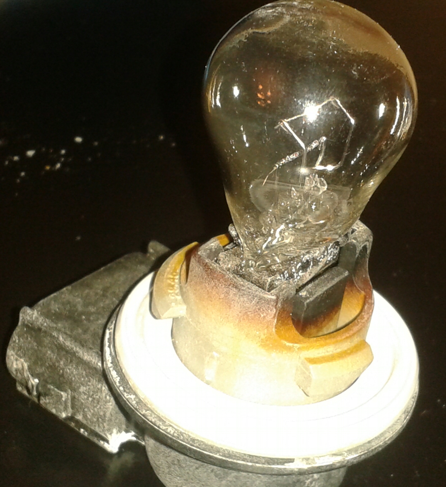

alittleedgy Posted August 11, 2012 Report Share Posted August 11, 2012 Hello guys and gals: I have a 2007 Ford Edge. I think I've seen this being discussed in some places...but thought I would re-introduce the topic as it is a bit perplexing and potentially dangerous. My tail light bulbs and bulb sockets are showing a lot of evidence of getting hot and melting. Ford of course is NOT fessing up and I have read similar experiences from others elsewhere. I went to the dealer yesterday and they were dismissive as I was expecting. When I brought up the subject of reading about numerous instances on the internet he responded "You can find evidence of ANYTHING on the interenet if you look hard enough". So, to hell with the Ford dealer - I will remember this when I replace this car. I am on my own. So, on to the fix - I trust this forum more than the Ford dealer at this point. I am going to replace the socket and the bulb. The socket will have to remain OEM. But the bulb...obvioiusly needs to be an LED.. I have seen where others have replaced these bulbs (Sylvania 4157 is what the car came with) with LEDs. Now...I am unsure as to the replacement I should be looking for. 1. Should I be looking to replace a 4157 or a 3157? (I've seen both being discussed) 2. Should I be looking for a red or white light? (I have seen both discussed) 3. And what about the flashing feature? Do I need to take this into consideration? I have seen this discussed insofar as having to mate the correct flasher to the LED. Seems odd because I thouight the bulb was a dumb part and only takes the signal given it. Hopefully someone can shed light on this for me (pun intended). Also - it seems odd that there does not seem to be a dedicated fuse for the tail lights...must be shared on a different circuit. At least that's the way it seems to be according to my owner's manual. AND...if anyone can be so kind as to suggest a source and P/N for the replacement bulb I would be additionally grateful as there seems to be many POTENTIAL types and sources - hard to know which may have given others trouble/success. Thanks all for your help...last time I was on this forum with an issue it was very, very helpful!! Quote Link to comment Share on other sites More sharing options...
full_jingbang Posted December 22, 2012 Report Share Posted December 22, 2012 I am having the same problem, the socket as well as the plastic base of the bulb is melted. it was hard to take out the bulb to replace it. but I did it anyways. now i am looking for the socket to change and found a part number 13411B about 11$-15$ ea. use a normal double filament bulb (it will also melt, i dont know why). Quote Link to comment Share on other sites More sharing options...

full_jingbang Posted November 20, 2013 Report Share Posted November 20, 2013 I had the same problem for the tail lights, replaced the sockets & bulbs, Im sure this will happen again some day, so im just waiting for the light to go OFF, then again I will replace them I think they used poor plastic for the sockets, it cannot take the heat of electricity.... and I dont think FORD is focusing on this issue, Quote Link to comment Share on other sites More sharing options...

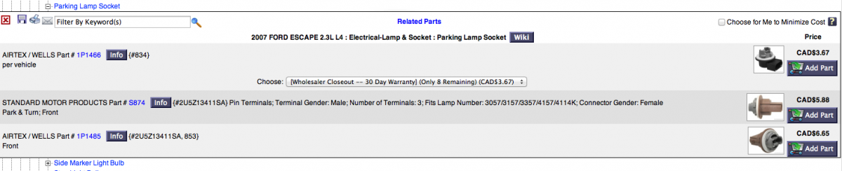

2007Edge Posted January 8, 2014 Report Share Posted January 8, 2014 (edited) I just replaced mine complete burned but still working, the price in ford dealer was 20 something $,found replacement on rockauto for 3.67 (in the lamp & socket for ford escape 2007 2.3 L L4). it fits on ford edge 2007. part AIRTEX / WELLS 1P1466 Edited January 8, 2014 by 2007Edge 2 Quote Link to comment Share on other sites More sharing options...
