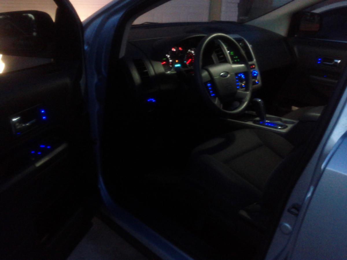

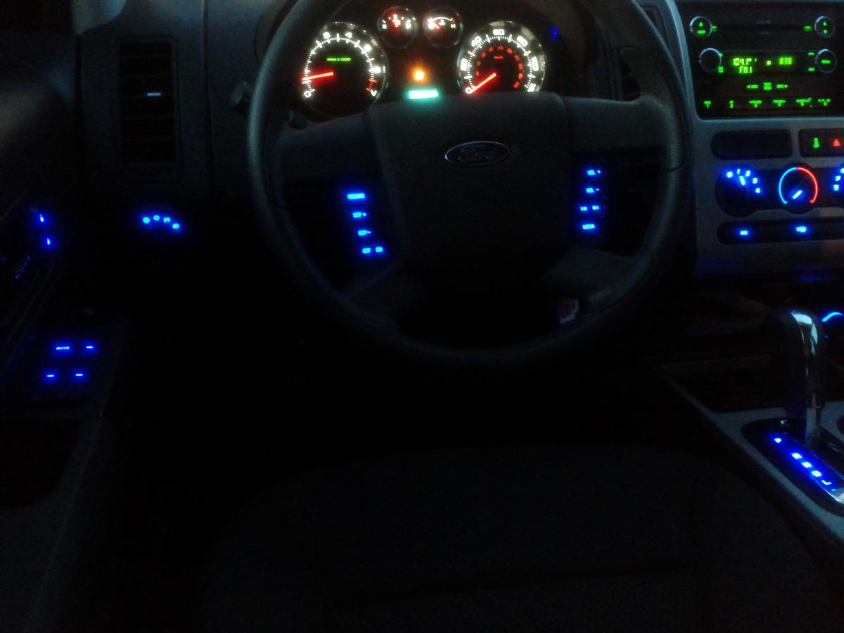

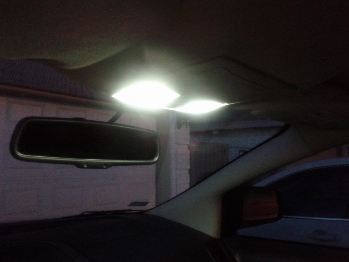

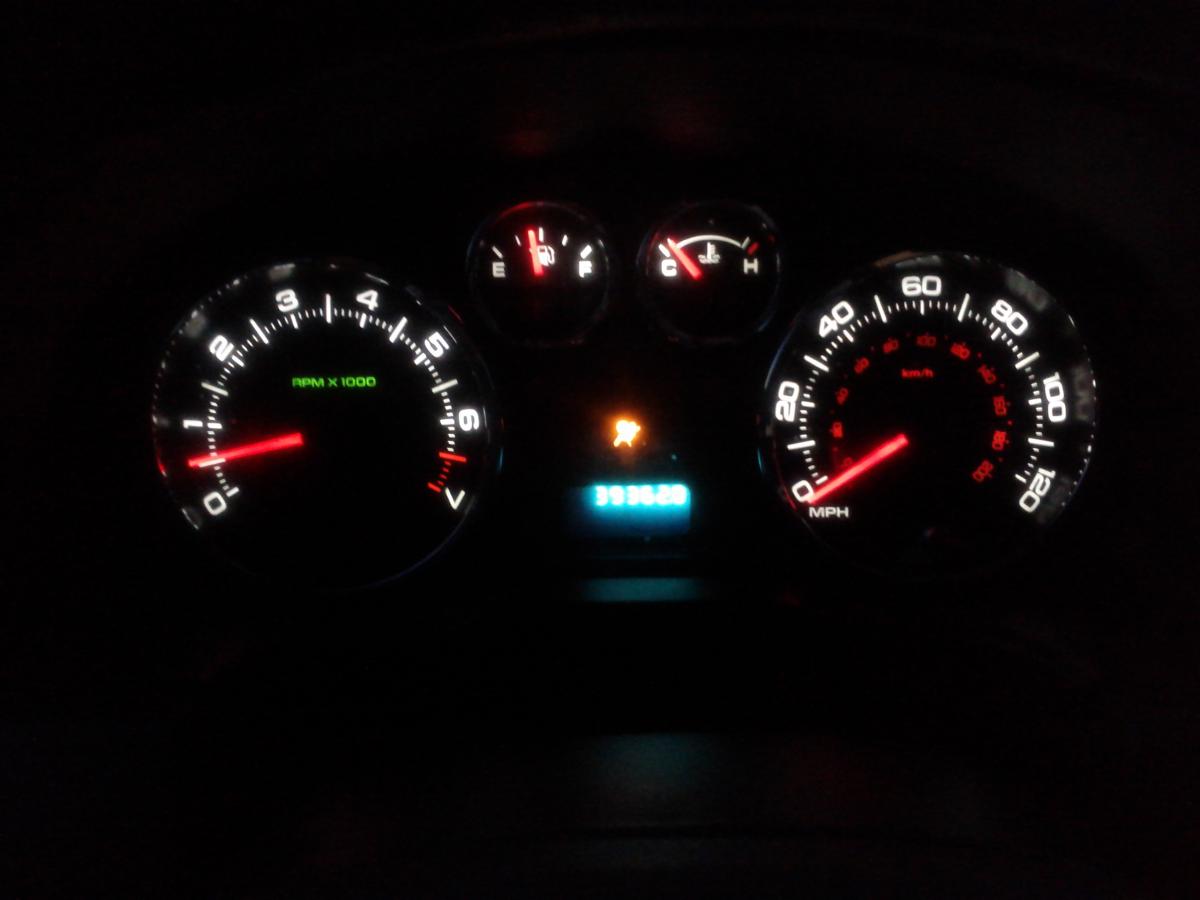

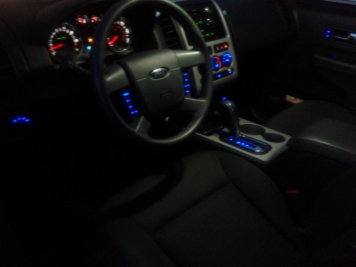

challenger74 Posted July 25, 2012 Report Share Posted July 25, 2012 I was very bored with the atmosphere inside of my 2008 edge so i changed the ugly GREEN to BLUE and the gauge cluster to WHITE.....sorry for the crappy pics but what ya think? BTW ignore the radio color because that will soon be changed to touch screen navi.....P.S. Dome, Map, luggage Lights have also been changed but plenty of post about that so you guys get the point. 2 Quote Link to comment Share on other sites More sharing options...

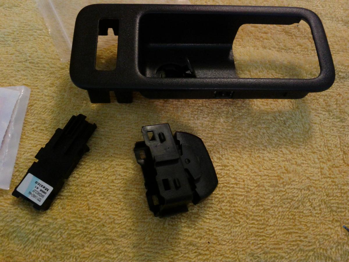

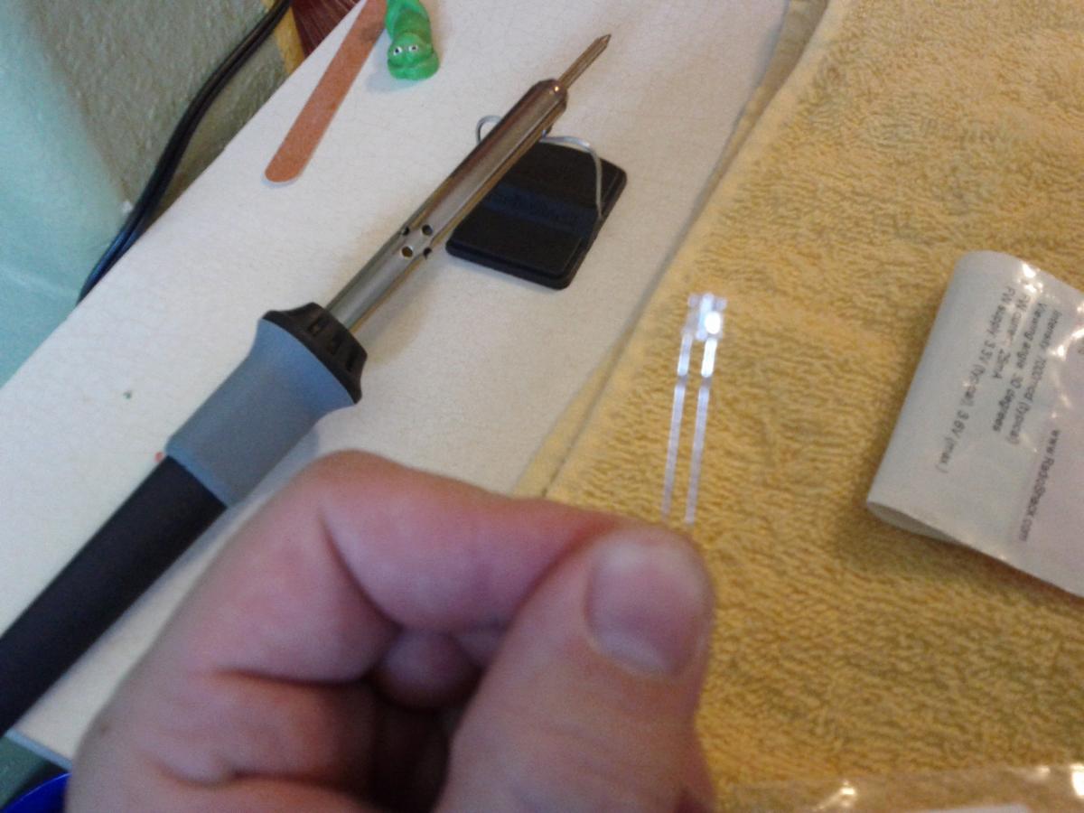

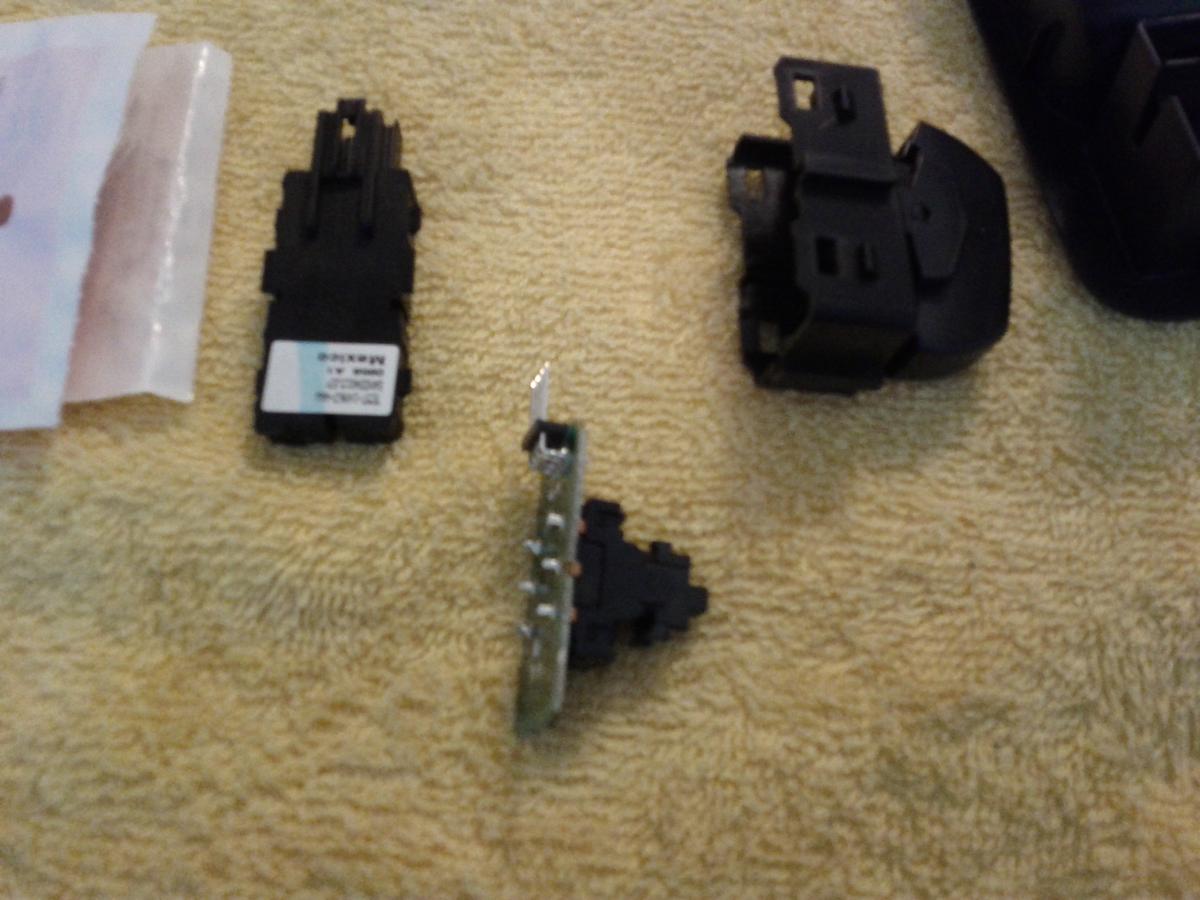

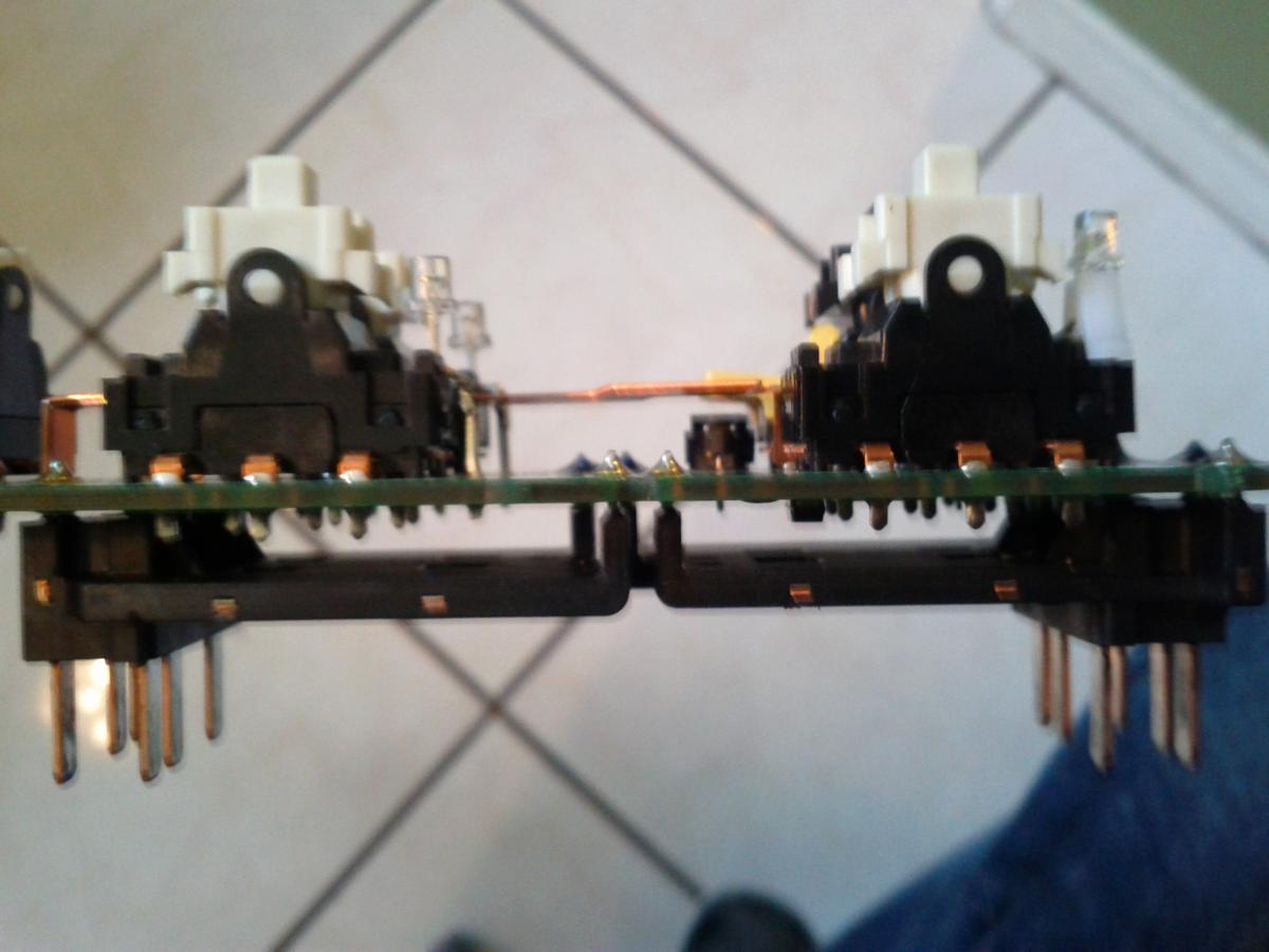

challenger74 Posted July 26, 2012 Author Report Share Posted July 26, 2012 Takes couple of hours and lots of concentration. The hardest LEDs to solder are the A/C controls, steering wheel control buttons, and headlight function rotary switch. ALSO i am up for anyone wanting this mod done....Pm with questions or how to arrange for this mod with colors etc...I'm an aviation mechanic as well as an avionics tech with the license to prove it If you know anything about aviation you know there is no room for error.....none.....whatsoever. 1 Quote Link to comment Share on other sites More sharing options...

fishx65 Posted July 27, 2012 Report Share Posted July 27, 2012 Great work! Very very cool. Did you think about doing the gauge cluster with blue instead of white? Quote Link to comment Share on other sites More sharing options...
challenger74 Posted July 27, 2012 Author Report Share Posted July 27, 2012 (edited) The gauge cluster, A/C controls, and headlight rotary switch have the surface solder mounted LEDs known as PLCC2.... The door switches are only the 3mm LEDs. Edited July 28, 2012 by challenger74 Quote Link to comment Share on other sites More sharing options...
challenger74 Posted July 27, 2012 Author Report Share Posted July 27, 2012 Yes I thought of cluster in blue but I just thought it was going to b to much blue.....I wanted to keep more Lexus style look...kinda a luxury sport look inside..... Quote Link to comment Share on other sites More sharing options...
