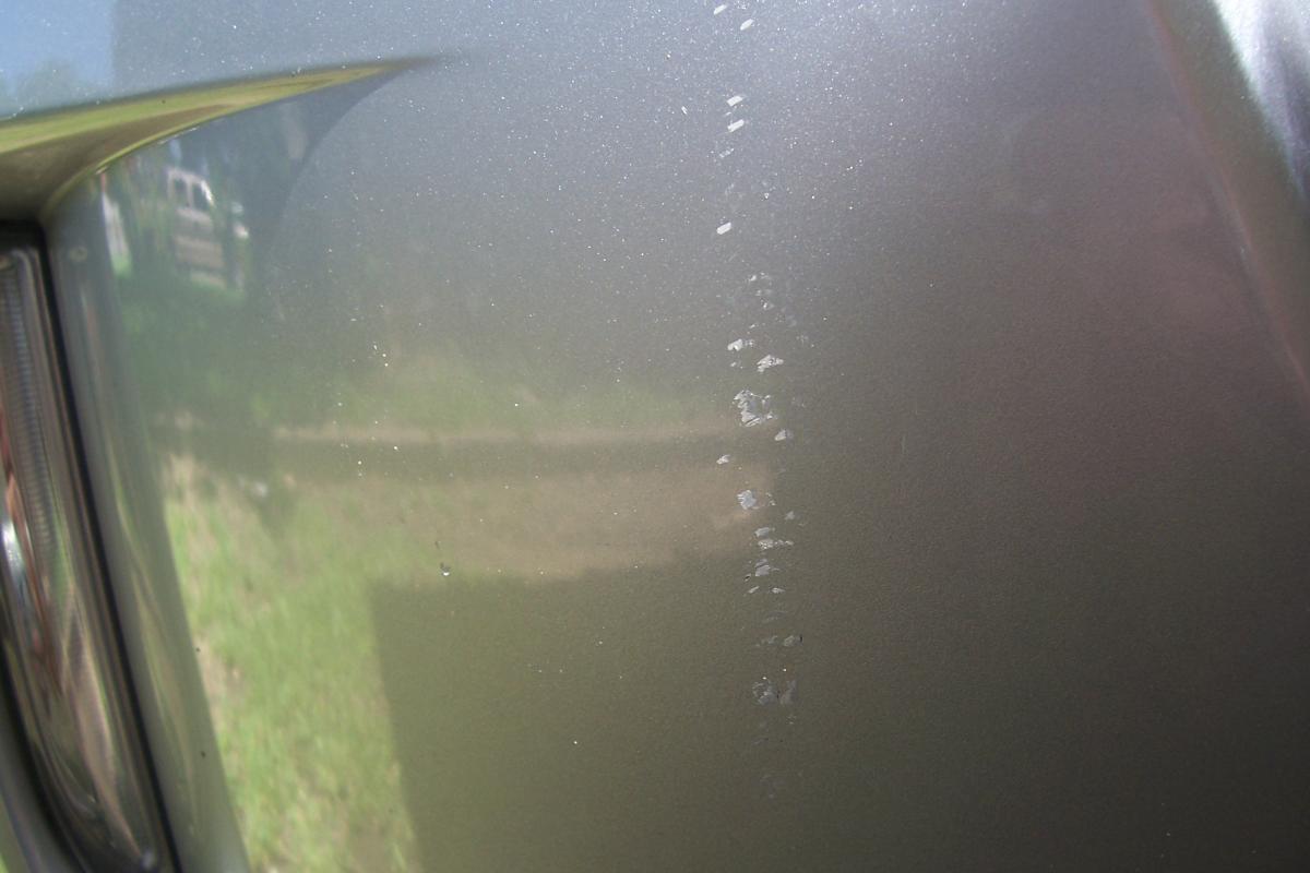

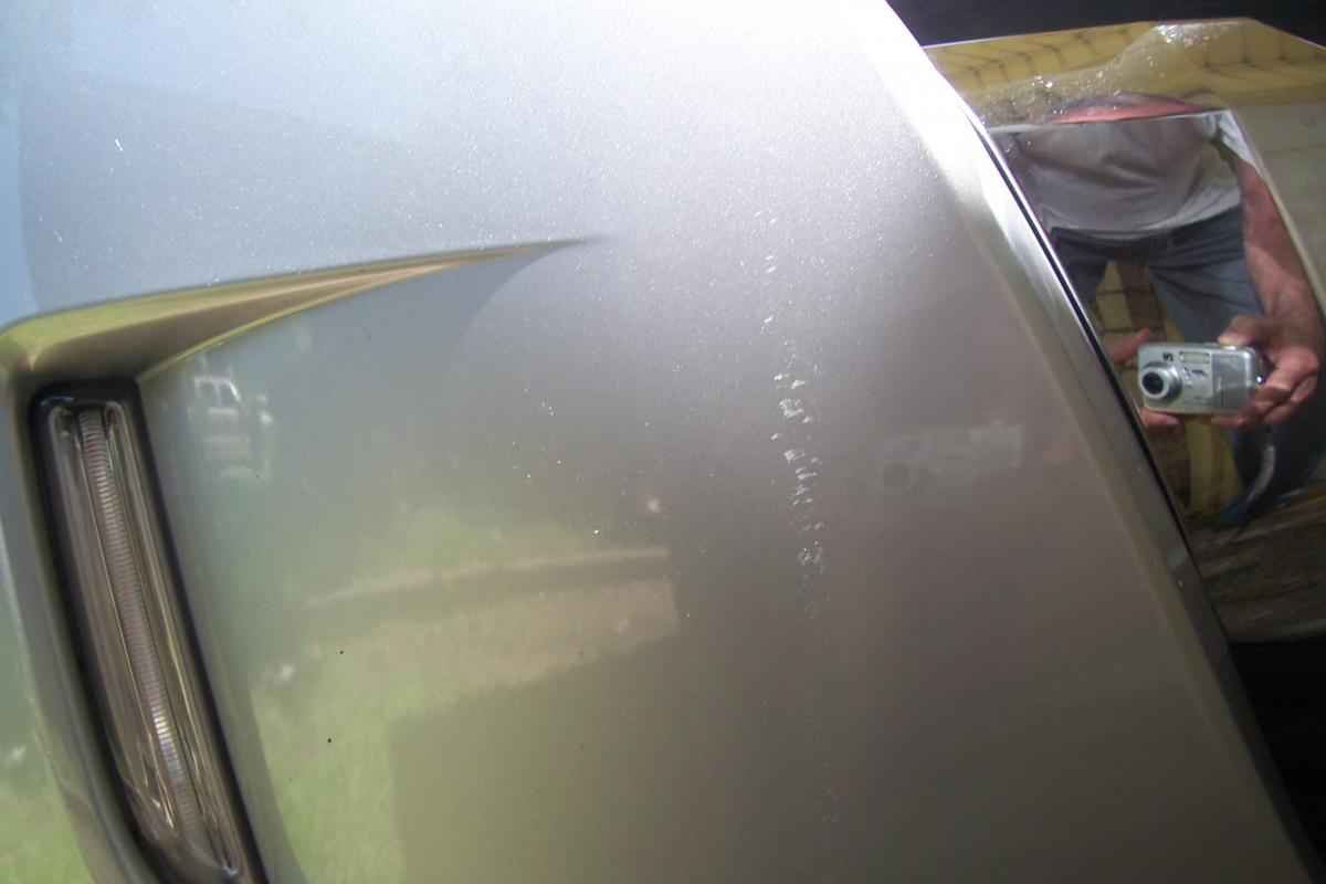

11Edge Posted July 22, 2012 Report Share Posted July 22, 2012 While parking at the doctor's office my wife bumped a post or something like it. There are white horizontal marks in a vertical plain of abouit 9 inches. It looks like she caught the side of a post. Question is, what product do I use on the bumper to "buff" the marks out assuming that it is paid transfer? If they are scratches I will have to get touch up paint. Any suggestions? I'll try to post a picture later. Quote Link to comment Share on other sites More sharing options...
11Edge Posted July 22, 2012 Author Report Share Posted July 22, 2012 (edited) pictures of boo-boo Edited July 22, 2012 by 11Edge Quote Link to comment Share on other sites More sharing options...
akirby Posted July 23, 2012 Report Share Posted July 23, 2012 Hard to tell. Try bug and tar remover or cleaner wax or mild polishing compound or clay. Quote Link to comment Share on other sites More sharing options...
c_bova Posted July 23, 2012 Report Share Posted July 23, 2012 can't tell if that's paint from the pole, or paint missing from the bumper. I'd use some polish to take care of that and if that doesn't do it then some rubbing compound. my arsenal of choice would be meguiars m105 and m205. Quote Link to comment Share on other sites More sharing options...
JOEHIO Posted July 23, 2012 Report Share Posted July 23, 2012 You might want to try Maguires Scratch X or kit Scratch Out. Have used both with good results. Quote Link to comment Share on other sites More sharing options...
c_bova Posted July 23, 2012 Report Share Posted July 23, 2012 meguiars ultimate compound and ultimate polish are good too, kind of like the 105/205 combo. Quote Link to comment Share on other sites More sharing options...
11Edge Posted July 23, 2012 Author Report Share Posted July 23, 2012 Hard to tell. Try bug and tar remover or cleaner wax or mild polishing compound or clay. WD-40 gets rid of tar and bugs, but I am hesitant to try in on this car. What do you think? Quote Link to comment Share on other sites More sharing options...
akirby Posted July 23, 2012 Report Share Posted July 23, 2012 WD-40 gets rid of tar and bugs, but I am hesitant to try in on this car. What do you think? It won't hurt. But I think the safest thing may be a clay bar. Polishes and compounds can do damage if overused or used too aggressively. Quote Link to comment Share on other sites More sharing options...
c_bova Posted July 23, 2012 Report Share Posted July 23, 2012 not really if he is just doing it by hand, he'd have to work it really really hard for a long time to damage anything. if you use a clay bar you have to polish anyways since the clay bar marrs the paint. Quote Link to comment Share on other sites More sharing options...
akirby Posted July 23, 2012 Report Share Posted July 23, 2012 if you use a clay bar you have to polish anyways since the clay bar marrs the paint. Not if it's used correctly with lots of lubricant. Quote Link to comment Share on other sites More sharing options...
Jarod Mayne Posted July 23, 2012 Report Share Posted July 23, 2012 I have always used turtle wax for marks like that. Usually works pretty good. Quote Link to comment Share on other sites More sharing options...
JOEHIO Posted July 24, 2012 Report Share Posted July 24, 2012 Maguires wax with cleaner (red bottle) also works pretty good on light scratches and scuff marks. Quote Link to comment Share on other sites More sharing options...
