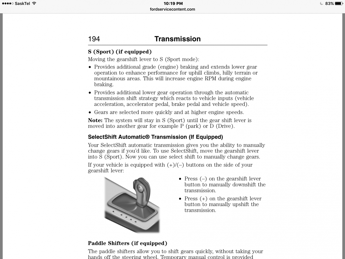

normcloutier Posted January 16, 2016 Report Share Posted January 16, 2016 My manual states a sport mode if equipped and a select shift if equipped. Is it possible to have select shift without sport mode? I have the S on the shift indicator beside the shifter and the + - buttons on the side. Quote Link to comment Share on other sites More sharing options...
omar302 Posted January 16, 2016 Report Share Posted January 16, 2016 I think the base model didn't get the select shift.other models, SEL, Limited & Sport all have select shift & sport mode (2013+). Quote Link to comment Share on other sites More sharing options...

normcloutier Posted July 29, 2016 Report Share Posted July 29, 2016 I think I posted this elsewhere but I had my sport mode fixed a while ago. They reflashed the PCM. Wow, what a difference. Even without using sport mode, there is a huge gain in performance. I always thought my edge was sluggish. I was told once that it was because I have 20" wheels on a SEL. Don't know why that would make any difference. Now driving in D is like using S and driving in S is just awesome. If your transmission goes directly to manual shift when putting the selector in S, HAVE IT FIXED. You won't regret it. 1 Quote Link to comment Share on other sites More sharing options...
